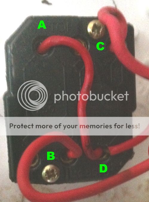

I have a 2 gang on/off switch in the house that is controlling a lantern on the drive on one switch & a porch light on the other switch.
I have now removed the lantern & replaced it with a lantern with pir built in.
Now one switch inside needs to be left in the on position to supply a feed to the lantern/pir.
My question is,can i remove the 2 gang switch inside for a 1 gang switch and join the wires that were removed from the second switch & just join together in a choc box and leave in the back box.
This then will only show the onn/off switch for the porch light.
Please take a look at my photo.
Swicth A-B Lantern/pir
Switch C-D Porche light

Because there is 2 switches on the same face plate it will be switched off by mistake all the time.
Or is there such a switch which has the 2 connections for all the wires on the rear but only one on / off switch on the front ?
1 gang switch - lantern wire (B) - connect to live connection at switch(D)
or change 2gang 2way switch for 2gang with 1 keyswitch+1way switch available in grid or module setup.
Is this then correct.
Wire from A to D throw away.
Then when i wire up 1 gang switch just add B & D in the same connection.
D connection is live supply at switch, which loops to A, remove loop and connect wire B to D.
Can you just confirm bere i make the connection.
The new 1 gang switch i have purchased has the following written on it.
COMMON & L1
Looking at my photo above of the old switch i need to wire up this new switch as follows.
Wire B & D to COMMON
Wire C to L1
Is this correct.
