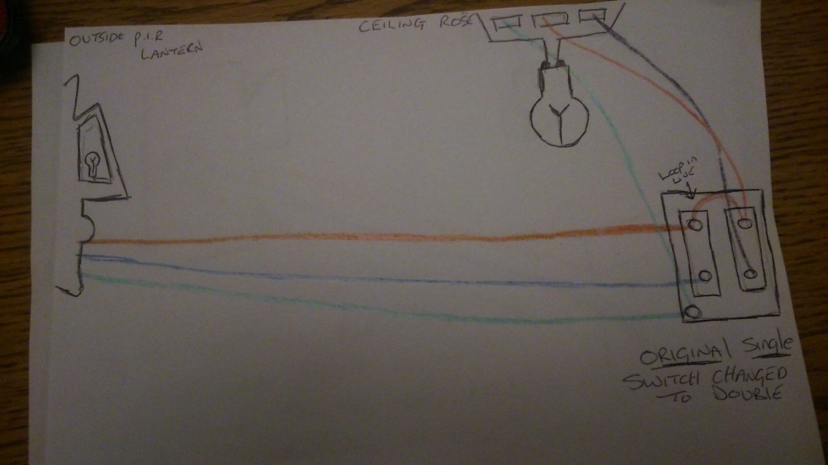

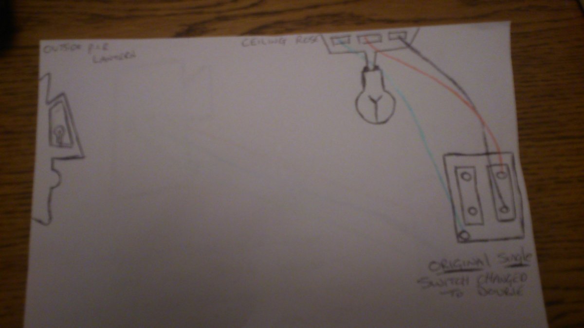

Hi guys and thanks in advance, I want to add an outside pir lantern at my front door, I have been told that I can replace the single switch in my front passage for a double switch, and wire my lantern in from there, as it would just be a case of taking the switch out, drilling the wall to outside and feeding the lantern cable through the wall and into the switch. I have been told that I can loop a piece of wire from the live connection for passage light to other side of switch, then join into that a live to the lantern, a switched live from other side of switch to the lantern and then obviously earth of switch to earth of lantern. is this the correct way of looping in at the switch rather than at ceiling rose, I am showing 2 pics, one with original old wiring from passage light, then the intended link wires.
You cannot. You do not have a neutral.
You will need to replace the cable from existing light (where there will be a fourth neutral terminal) to the switch with 3core+earth.

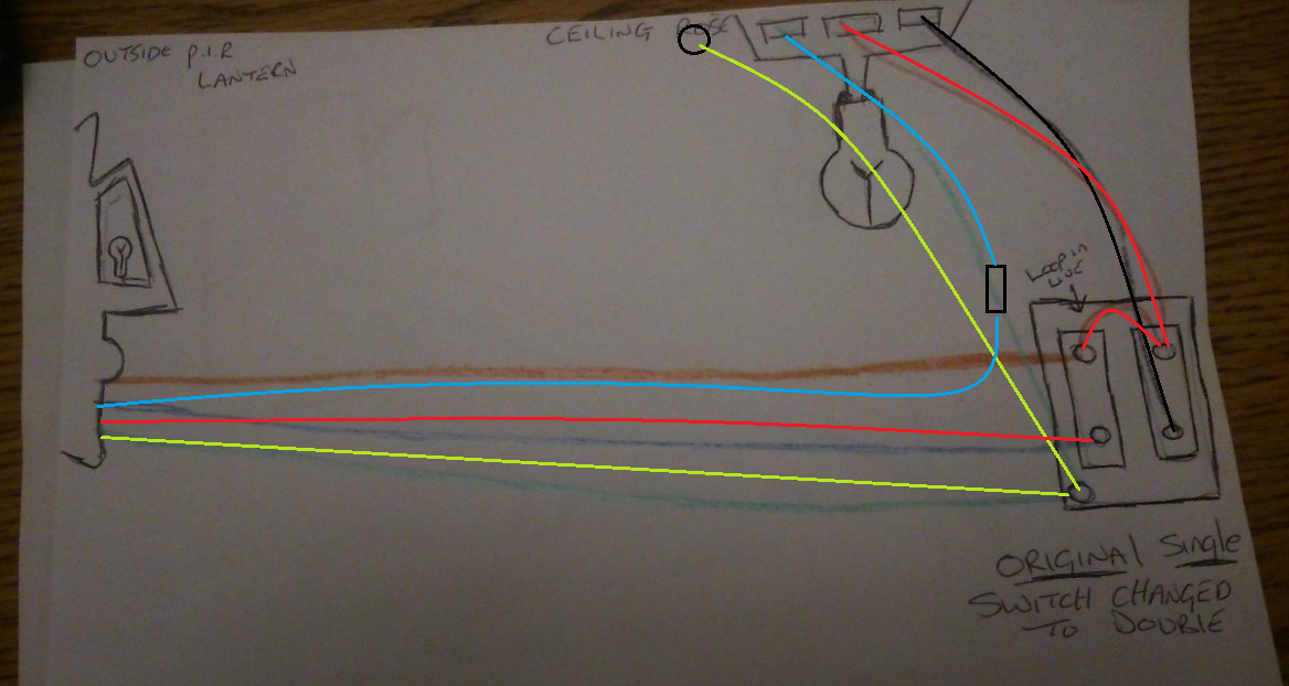

I am following your diagram except for 1 thing, what is the black oblong you have placed in the neutral from rose to lantern ? cheers

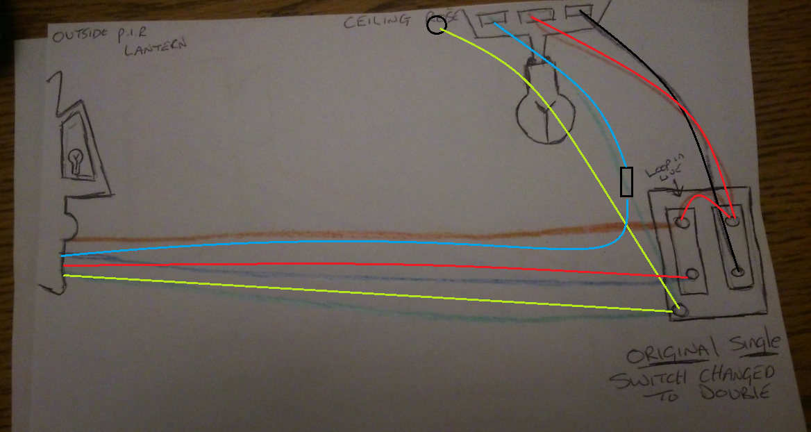

Look at the diagram EFLI altered for you.
Imagine the four wires shown linking your existing light to the switch (Neutral, Live, Switched live for existing light and earth). There is one more wire than you appear to have at the moment (the neutral).
So, if you replace the current cable linking the existing light with the switch with a three core and earth, and connect up to the neutral in the existing light, you can then do as you suggest and run a twin and earth cable from the existing switch, connecting it up as per the diagram EFLI altered.
The black rectangle EFLI added represents a terminal block inside the switch box to which you attach the neutral wire from the existing light fitting to the neutral wire going out to the new lantern.
So if I follow this diagram, the lantern will have power from the switch ? with only taking a neutral from rose to lantern ( meaning no other wires to or from rose ) the only other wires would be from switch to lantern ??

Yes. The supply to the lantern is made up of:
Switched live: from switch
Earth: from switch
Neutral: from ceiling rose via switch (but not connected to switch)
