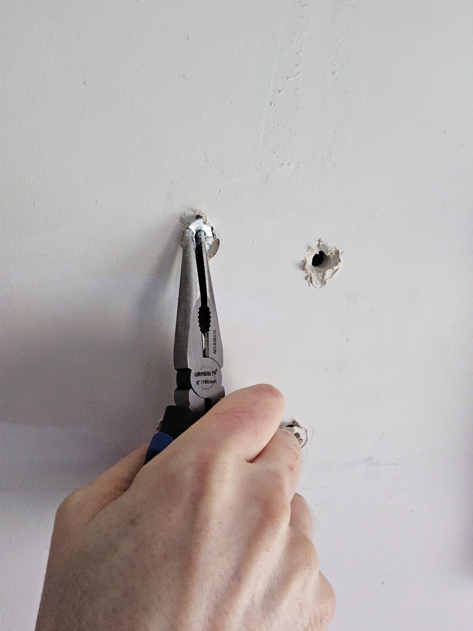

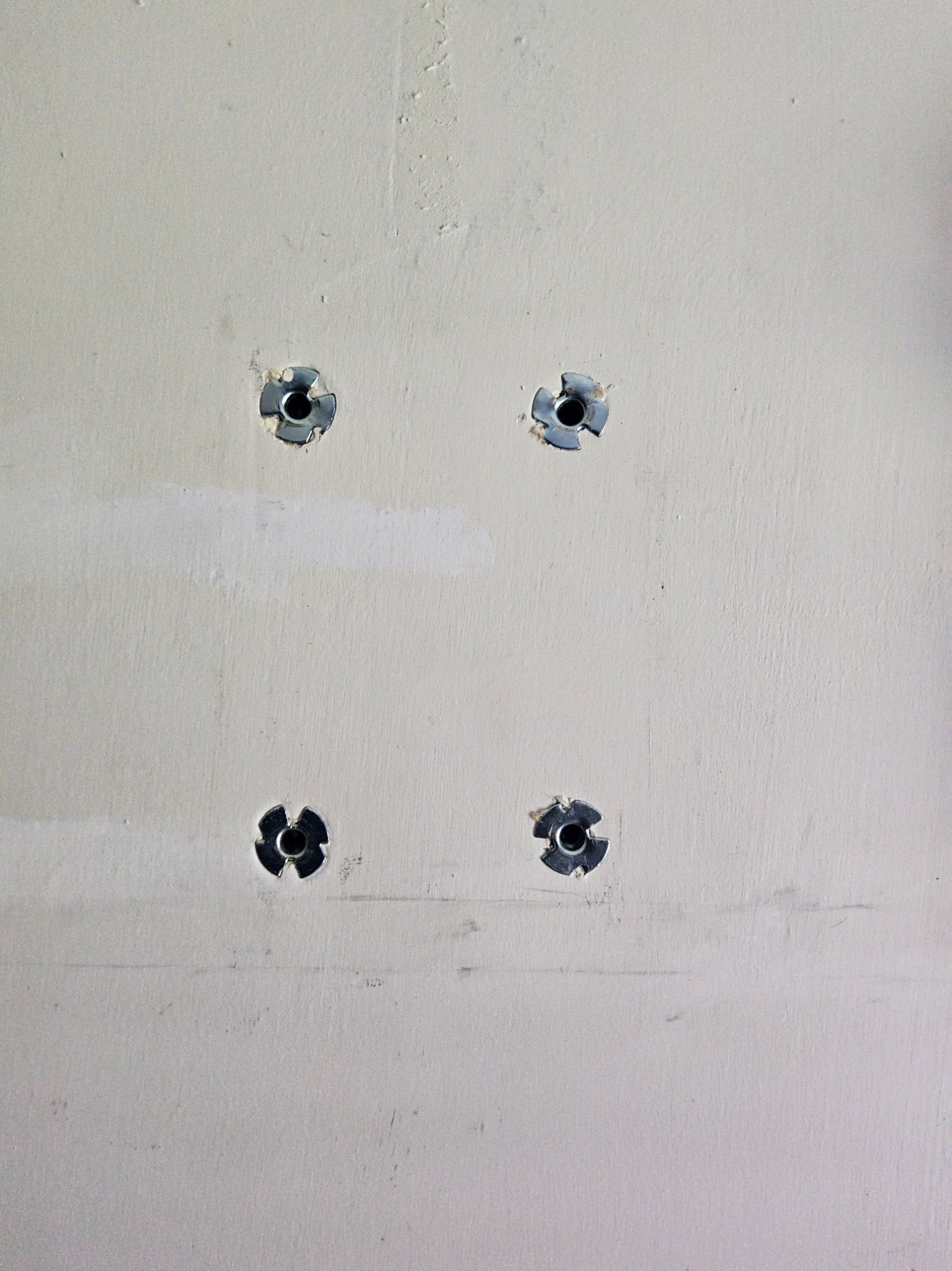

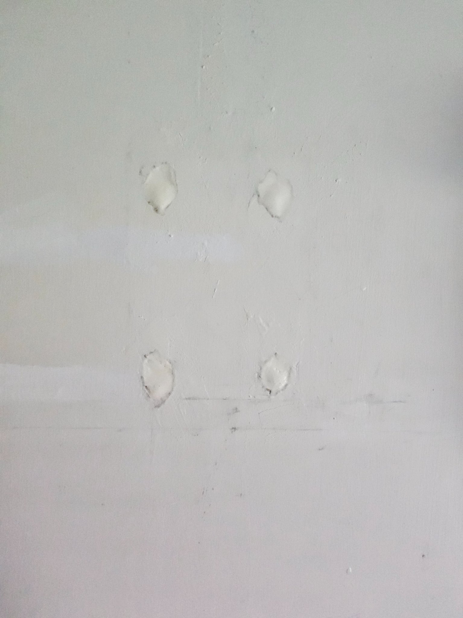

These are wall anchor thingies.
I'd like to remove them from the 12mm thick board without wrecking the board.
Any tried and tested way!?

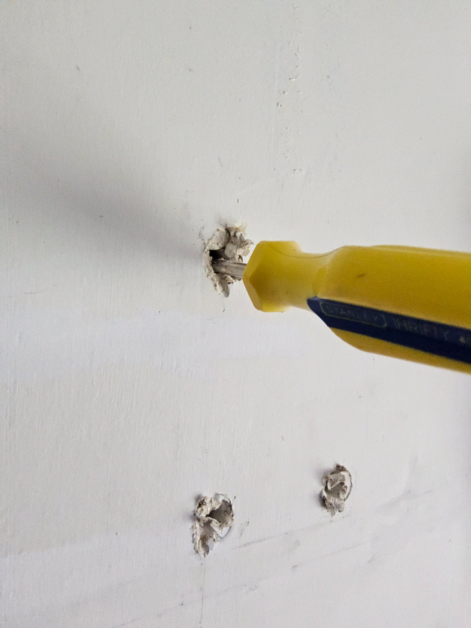

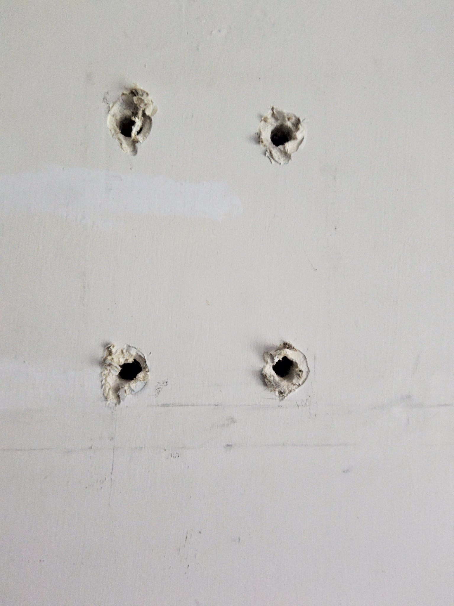

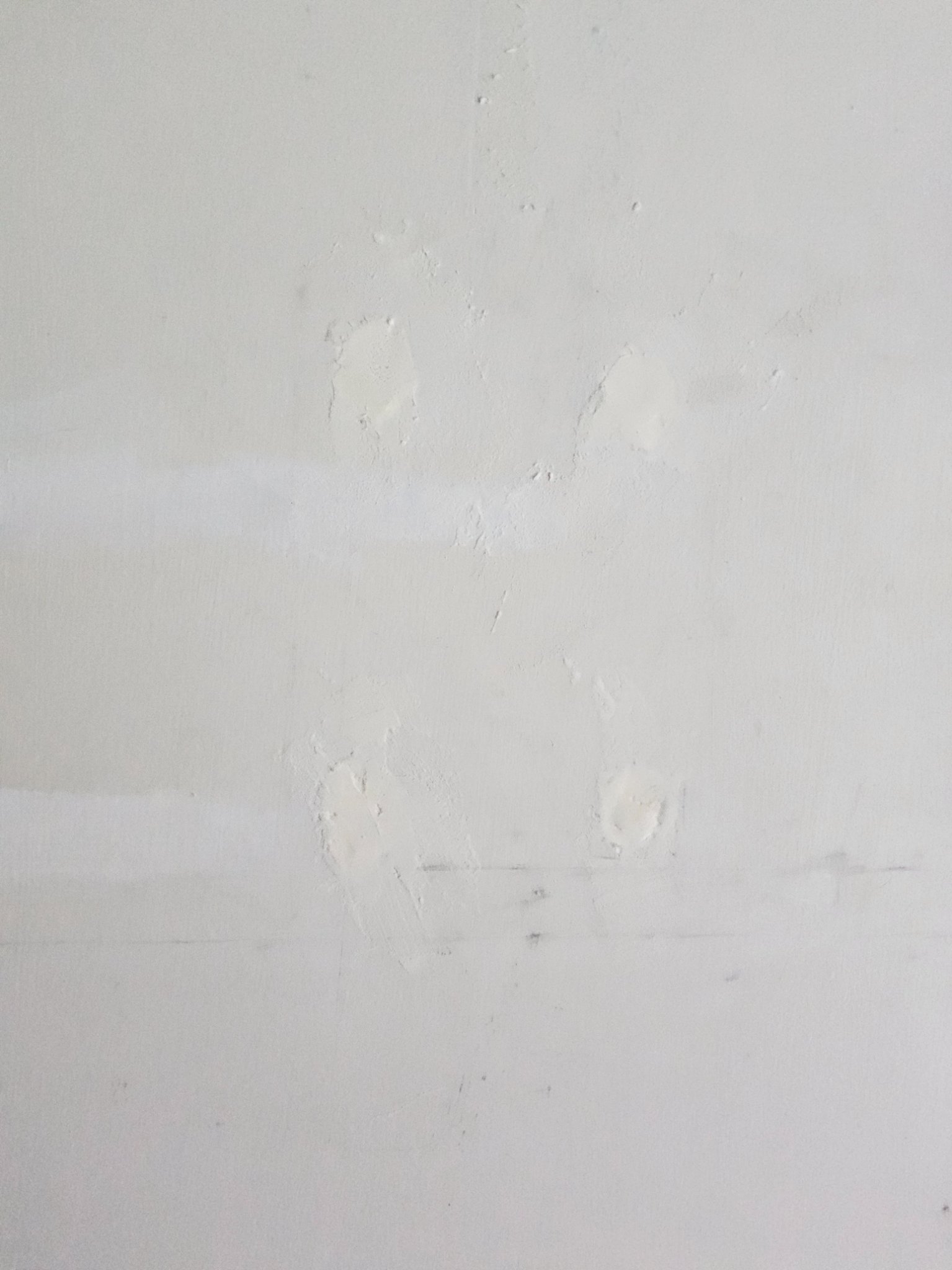

Punch them through.
Use a old screwdriver or something and hammer to punch through.
Fill holes.
Other way is to cut around and put out but hole will be bigger

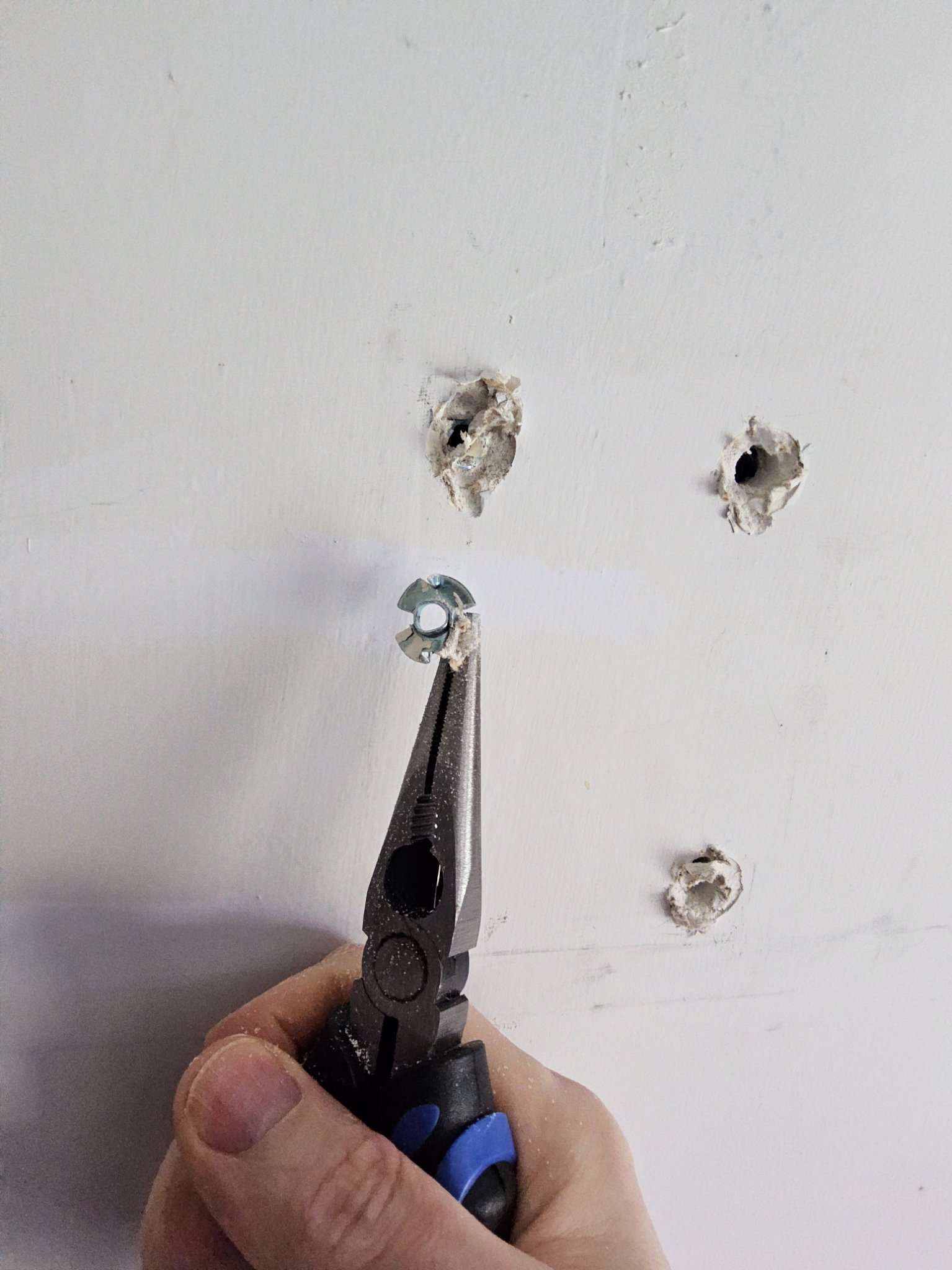

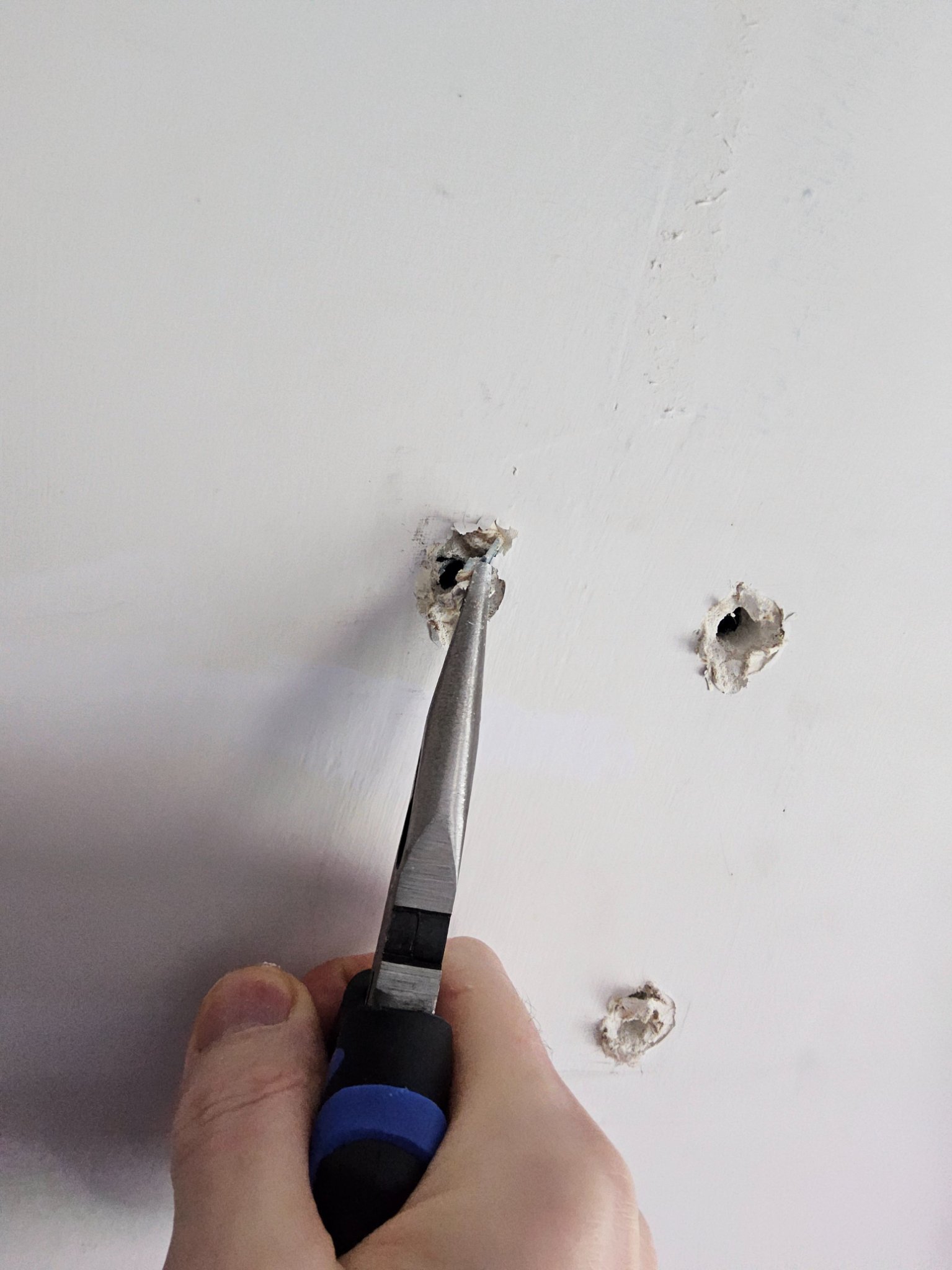

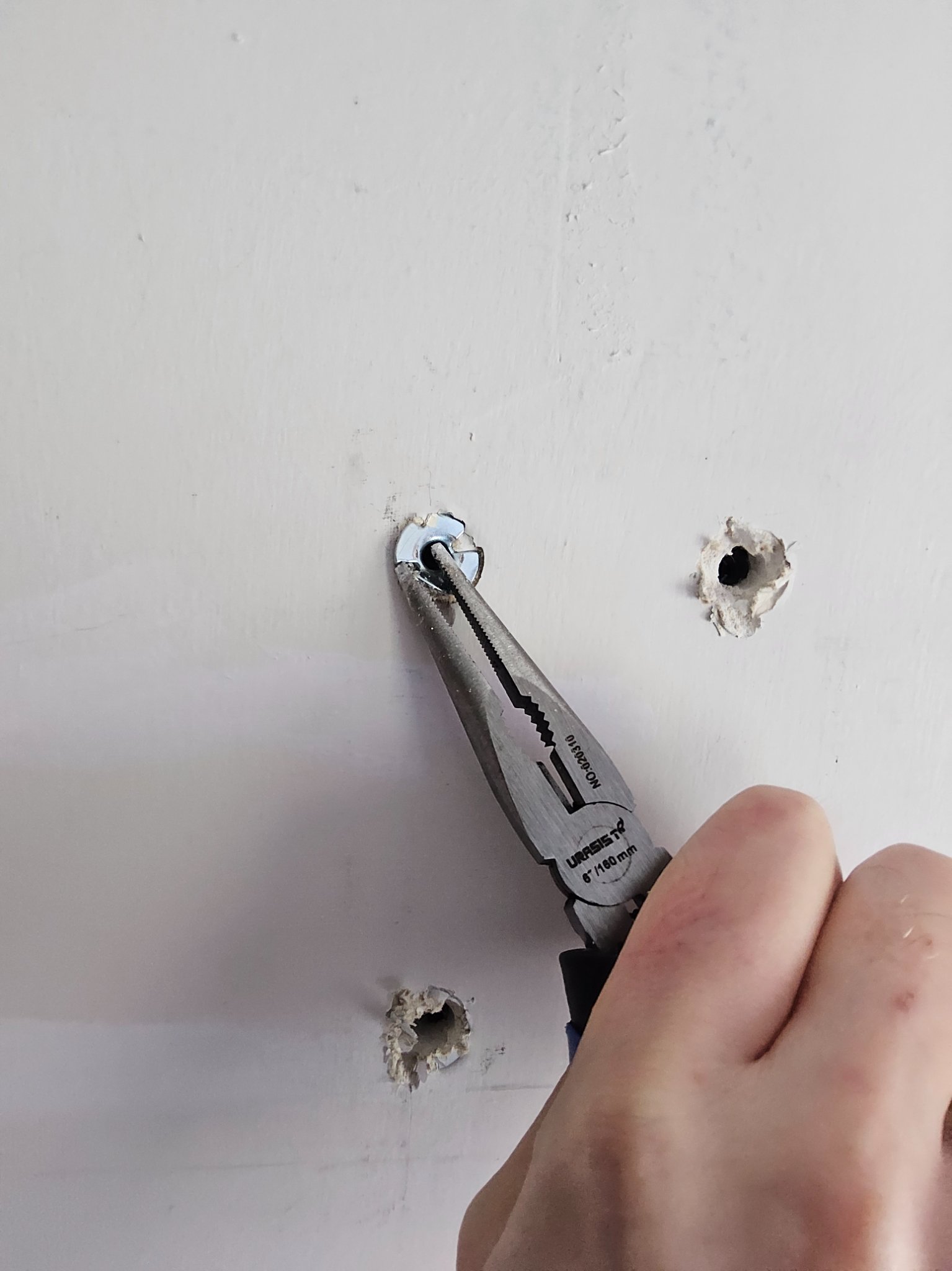

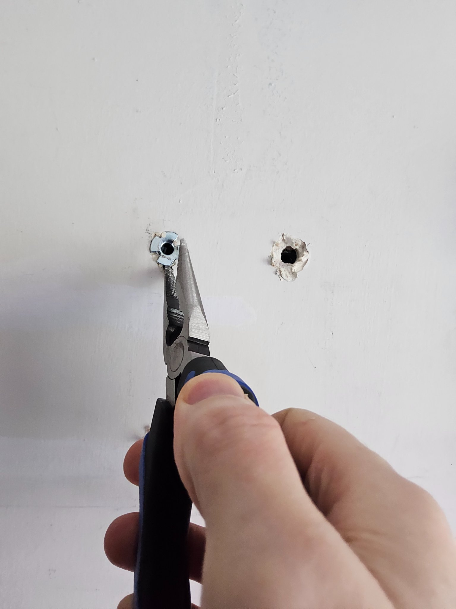

Use some long nose pliers to pry off the collars.
They are bigger behind plasterboard as they spread out when screwed. Just no way to crush the back part that I know of to allow them to come out.
Plus the plasterboard is soft so you need to hold them to bend..

Alternatively you can find a suitably long bolt and screw it into the threaded part of the plug, then knock it with a hammer until the anchor has been extended, then pull it out the wall, effectively reversing the process by which it was fitted in the first place.

I was surprised how easily the metal collars of the wall hooks broke by use of long nose pliers.
Thanks for help.

You're talking about hammering the wall plug through to the other side completely intact?
Doesn't the collar make a bigger hole that way?
No, the collar breaks off so it's only the bits inside the wall that go through and drop off inside the wall.
The front plate you can then just dig out & fill the hole.
