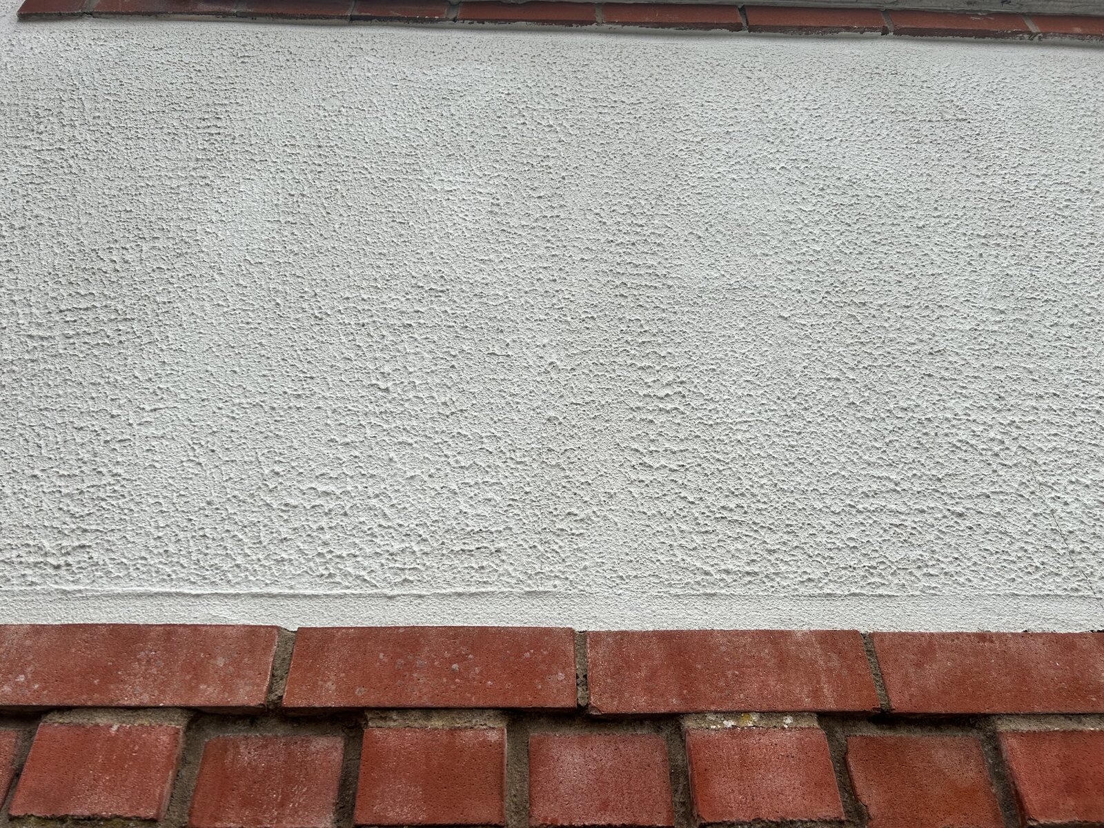

I am completing a small patch repair in my external render. I was hoping for advice on how to match the surface of the new area with the existing as pictured?
Thank you in advance
This stuff or similar product.
Looking at the pattern I wonder if they used a large artex stipple pad not a roller though

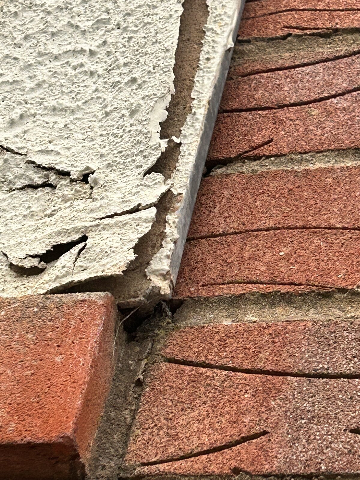

I think you could be right. Thank you. Looking at the part I’m going patch it looks like a heavy layer of paint very similar to the sandtex.
My neighbour painted the outside of his house with a homemade mixture of sand and ordinary masonry paint which looks exactly like Sandtex high build...it's been on for nearly 10 years
