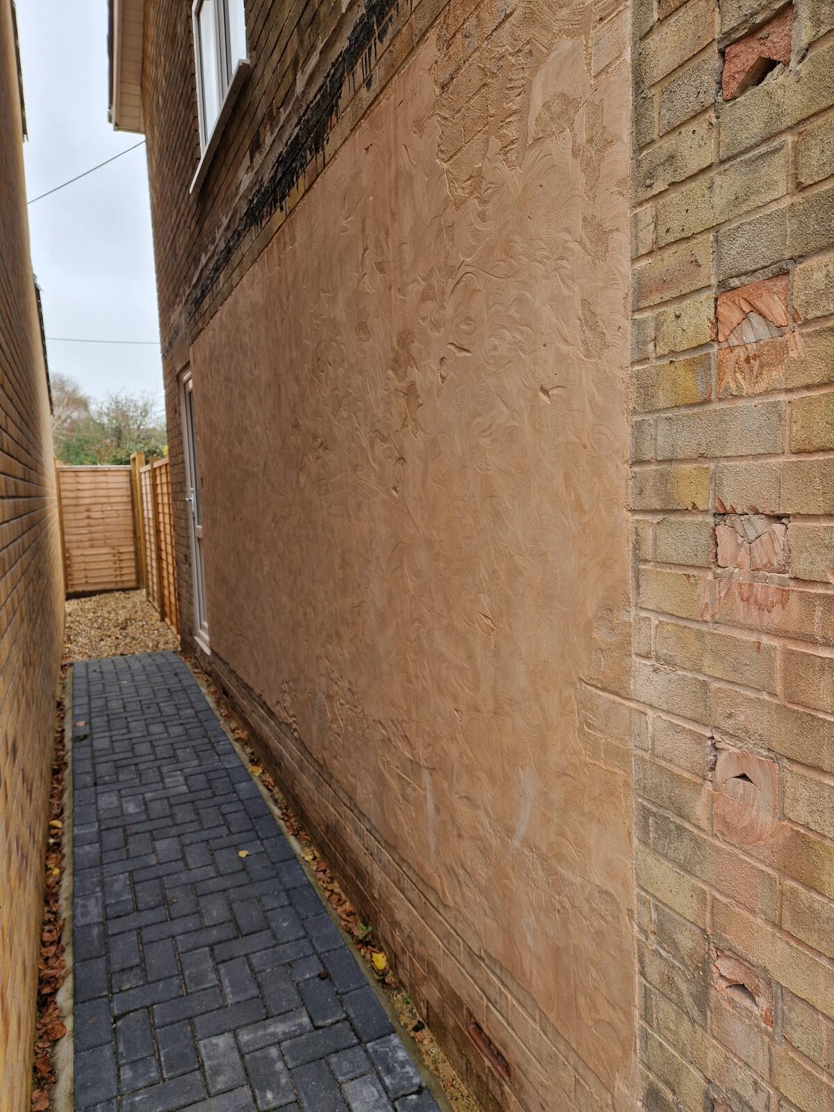

As well as some iffy issues elsewhere on a house that is a potential purchase, there is a large area ( half height of the side wall) of plaster where a garage used to be. The estate agent says the vendors 'builder' will render over this as its too difficult to remove it.
First, is it that hard to remove plaster from brickwork? Time consuming maybe.
Second, can you/should you even render (probably k-rend) over plaster like that?
Cheers

Looks like a right mess, especially with the remnants of the flat roof above it. I guess they removed the garage to squeeze another house in?

Despite how well it seems to be faring against the elements, rendering over a gypsum plaster is a no no. The issue’s cosmetic, the brick wall’s still there doing its job beneath the plaster. So I’d decline the render offer and focus on any other issues.
It’s internal plaster, not for exposure to damp, frost, so will fail eventually. No exterior render system would be spec’d to be applied over interior plaster

Then you'll have enough spare change to do what's needed to it, probably some sort of grinding/ power brushing then render.

You can hack it away, and I believe that Hydrochloric acid will remove the residual plaster. Not something that I have tried though.
