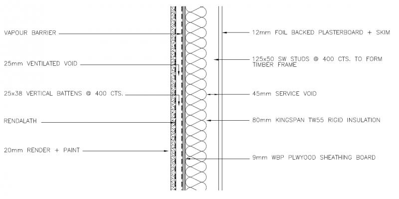

I investigated this quite thoroughly just recently, twas for a job adding a first floor extension over an existing single skin blockwork garage so wanted to avoid an additional skin of blockwork inside. A product called Rendalath is the product in question.
If you find another way it'd be good to hear about it!:P

Whilst its supposed to be cheaper it may only be economical on new builds. In the end the builder wanted a more traditional method so we ended up having steel beams and blockwork outside and timber frame internal anyway as he's a bit of a traditionalist.
Thanks FMT :) Does that achieve a u-value of 0.3?

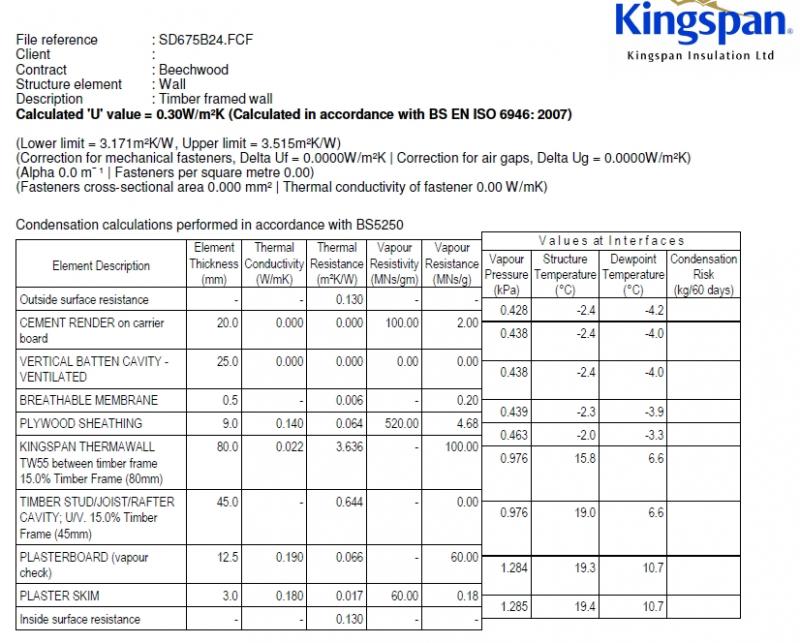

This is a system I came across...
Yours is approx. 50mm smaller, which is better in terms of internal space requirements :)
