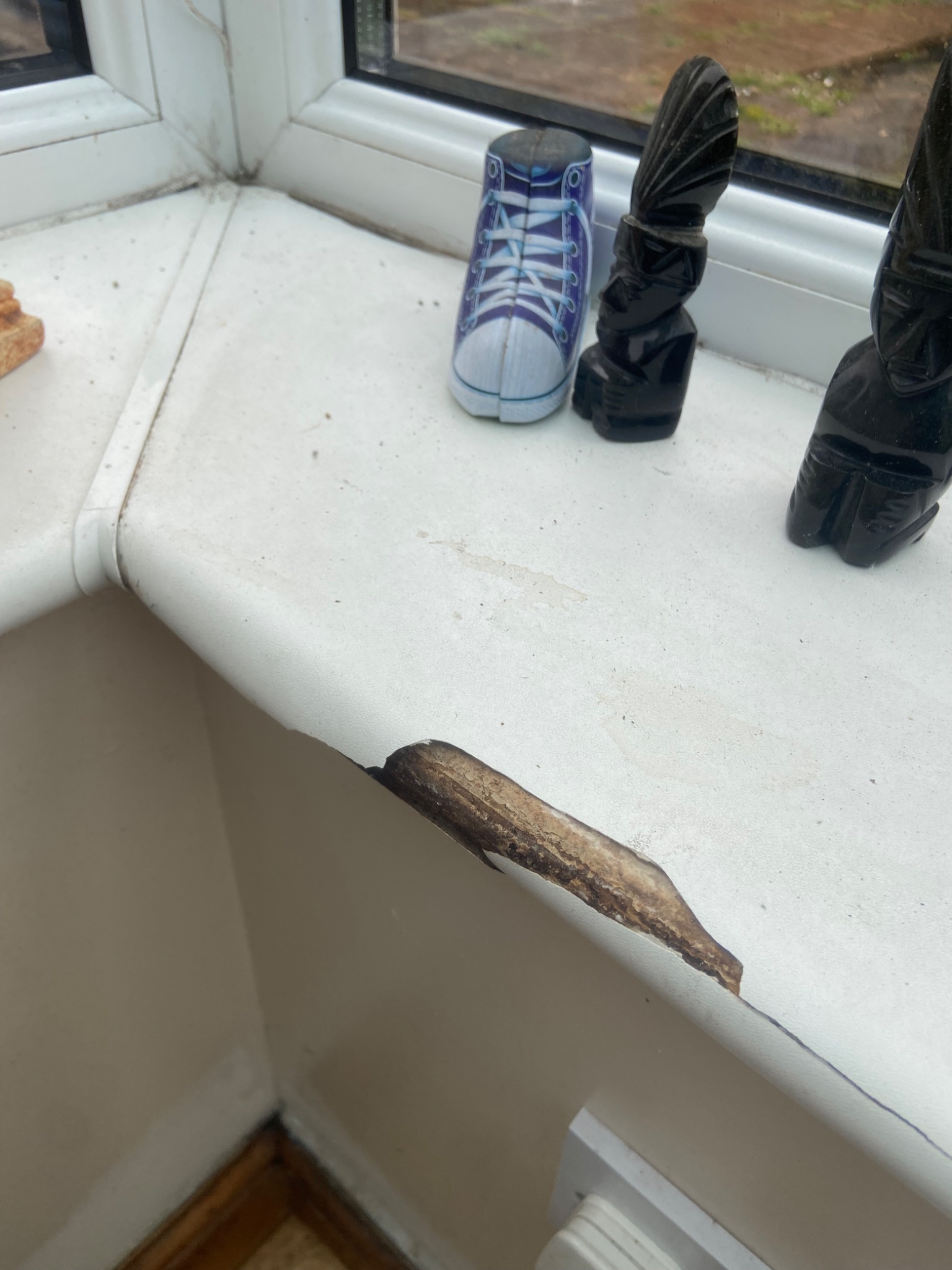

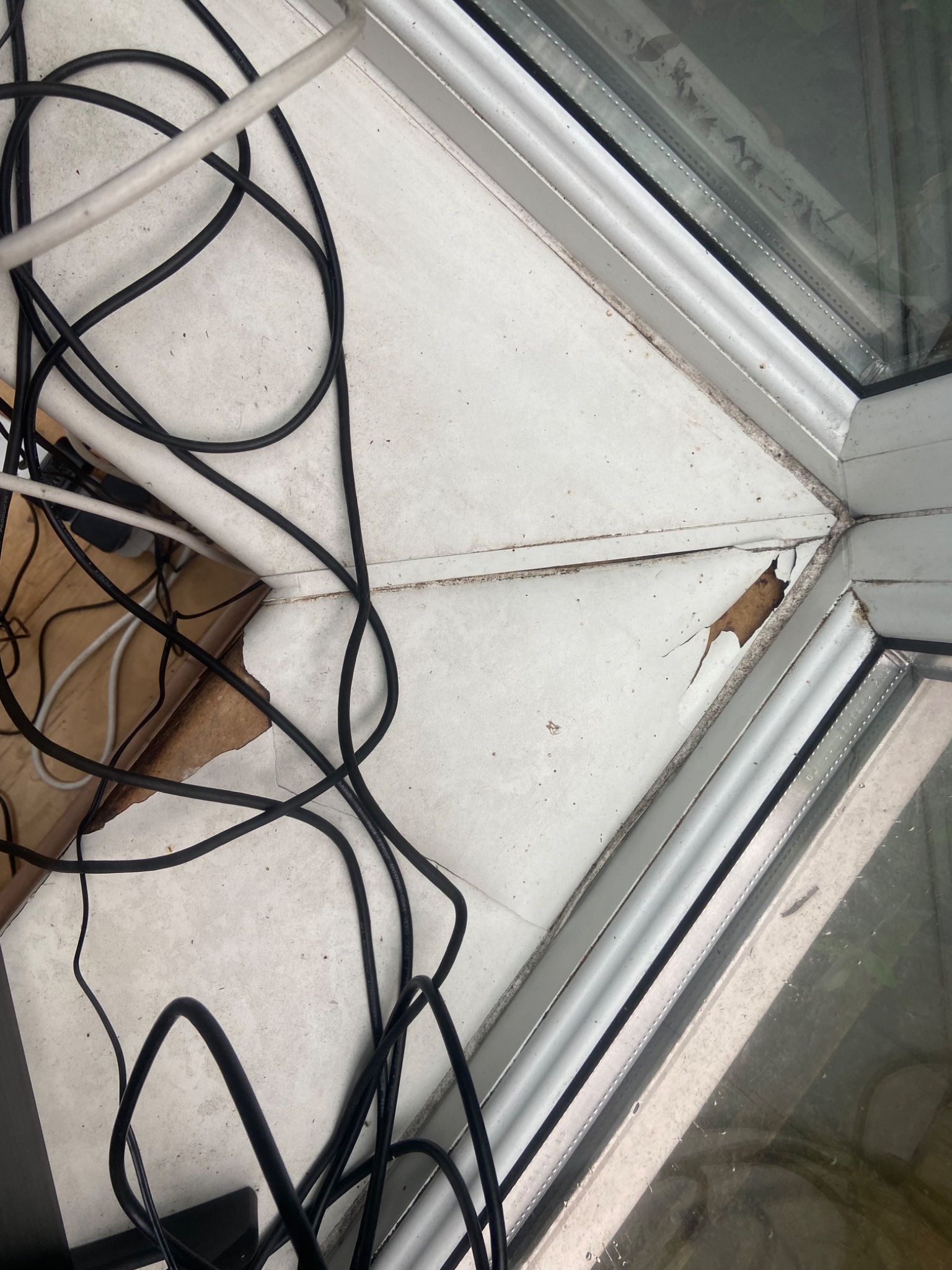

Hi
We have two area where paint has cracked and flaked away, exposing bare wood on windowsill. (Photos included) It’s a shame as only two areas affected.
Should I just remove loose paint coating, sand, prime and repaint etc? Jyst worried the cracks will extend and expose much bigger areas?
Thank you.
That looks like plastic coated wood sill?
Taken a knock and the plastic has broken?
Replace with a new one. Plastics trade centre will sell or you may find at bigger DIY stores.
Better off at somewhere like eurocell although B&Q sell a capping board you could use... They stock Eurocell White 1.75M Upvc Capping Board 100mm Depth X 9m that might fit
