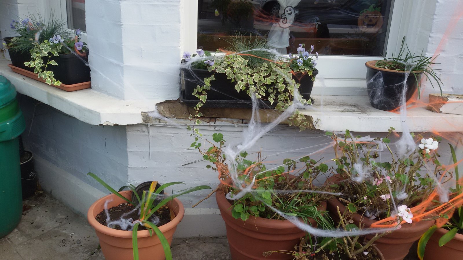

My neighbour, [rather large lady] was cleaning her front window and went through the stone windowsill. She's unhurt btw...
She asked me to repair it. See attached pic'.
I was going to just make a wooden form and pour ready mix cement into it. How does that sound? Anyone with any thoughts on this would be greatly appreciated.

I think it should could do with some mesh or reinforcement inside it. Depends on how good you want to repair it.
Metal rods/mesh should work.
If you have got all the missing bits? perhaps some kind of resin may be better, to glue it back together.
If you go cement way, don't make the mix really strong (i.e. too much cement), I did this on a cill repair and it cracked after a couple of days.
You could then skim with Tourpret Murex around £10, others will be along with suggestions.
sounds about right. Only things to add are whether you can anchor some screws into existing to give your repair more 'bite' and not to forget to incorporate a drip edge into your form work
I'd drill some holes into the stone at the back, and resin some bars in. Cast the concrete around them. Otherwise the concrete isn't going to stay there.
Helifix bars spanning it might not be a bad move.
