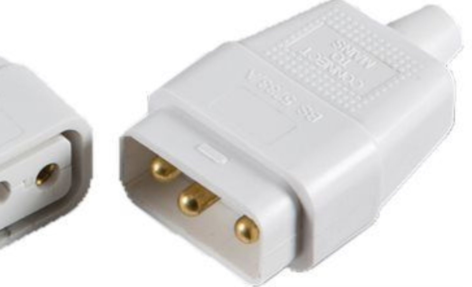

A few weeks ago a friend of mine managed to cut through his mower cable and not thinking he did a temporary repair with choc block without unplugging the cable from the outside RCD socket. So he did the repair without so much as a tingle and continued cutting the grass.
A few days ago he repaired the cable with a 2 pin plug and socket (from a shed) which is labelled 'mains' and 'appliance'. Now he insists that he fitted the connectors individually and at no time were both parts dismantled simultaneously but he ended up with making a widow maker, ie the plug with exposed pins is labelled 'mains'.
This morning he twice found the hard way that an RCD does not switch off when you put yourself across exposed pins, first time as he handled the cable and second as he fell on the plug as a result of the first shock.
He asked me to replace the RCD socket, which I haven't done as it has trip times of 7mS & 18mS. I demonstrated that his dry patio slabs only conducted 2mA and touching the live pin onto a blade of grass tripped the RCD straight away.
I have of course remade the connectors but I'm surprised they have been constructed in such a way that the inserts can be swapped.
No matter what the legends on the connectors said, I think the fact that it didn't register that it couldn't possibly be right for the plug to be the live side shows that he should not be fiddling with electrical things. No doubt the connector had instructions that mandated it should only be fitted by someone competent.
KnightsBridge' own stock photo has them the dangerous/wrong way round on the 3 pin version...
Ye gods.
Given that, and the fact that the cases appear to be interchangeable, things would probably be safer if there were no legends at all.

Ye gods.
Unusually I find myself agreeing with BAS.
Edit: but it would be much better if the inserts were not interchangeable in the first place.
