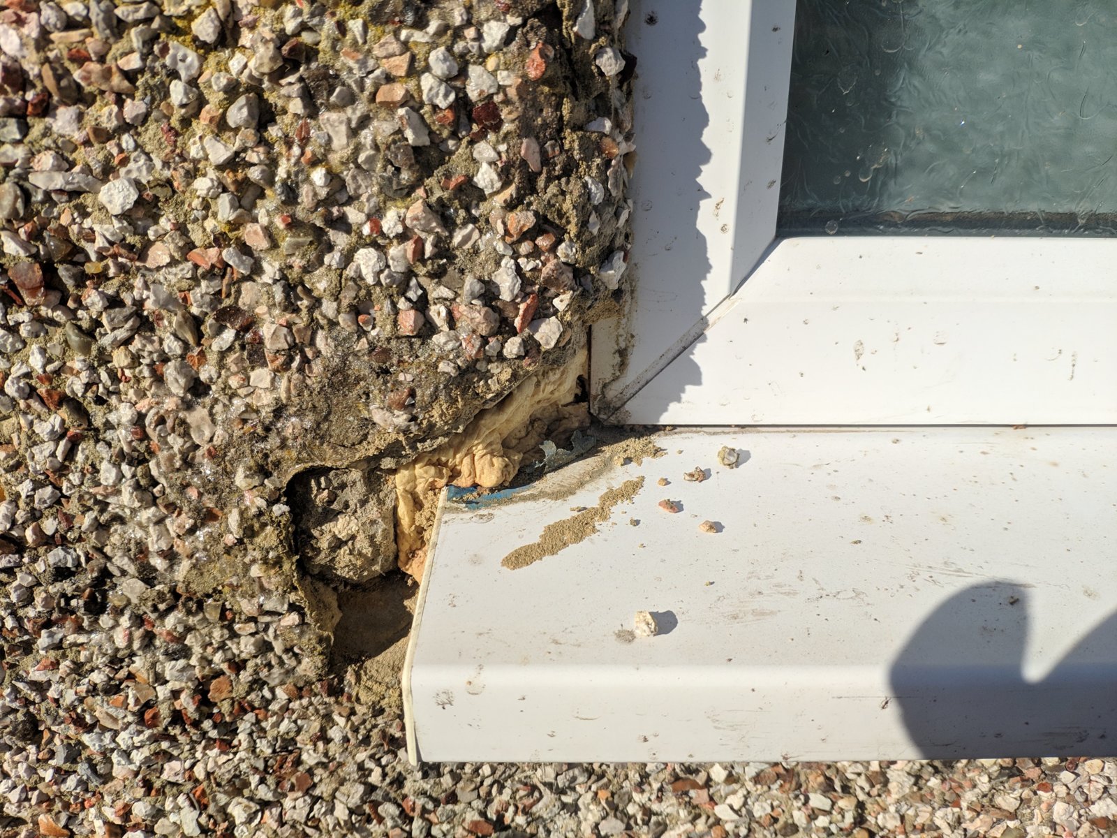

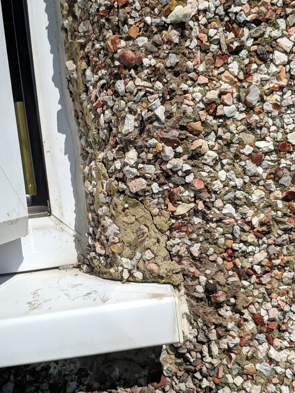

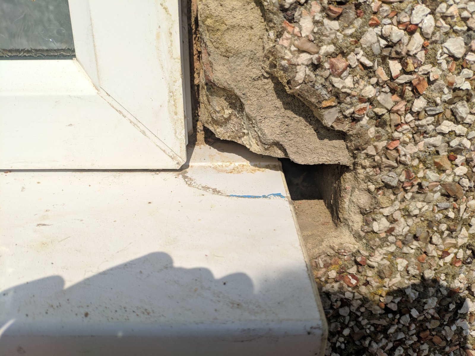

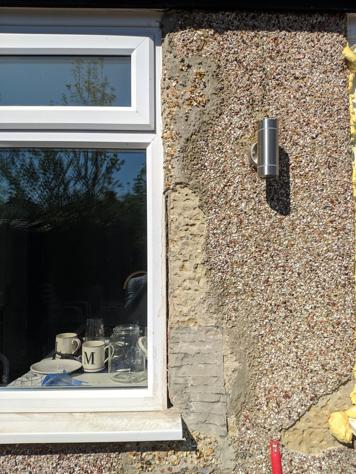

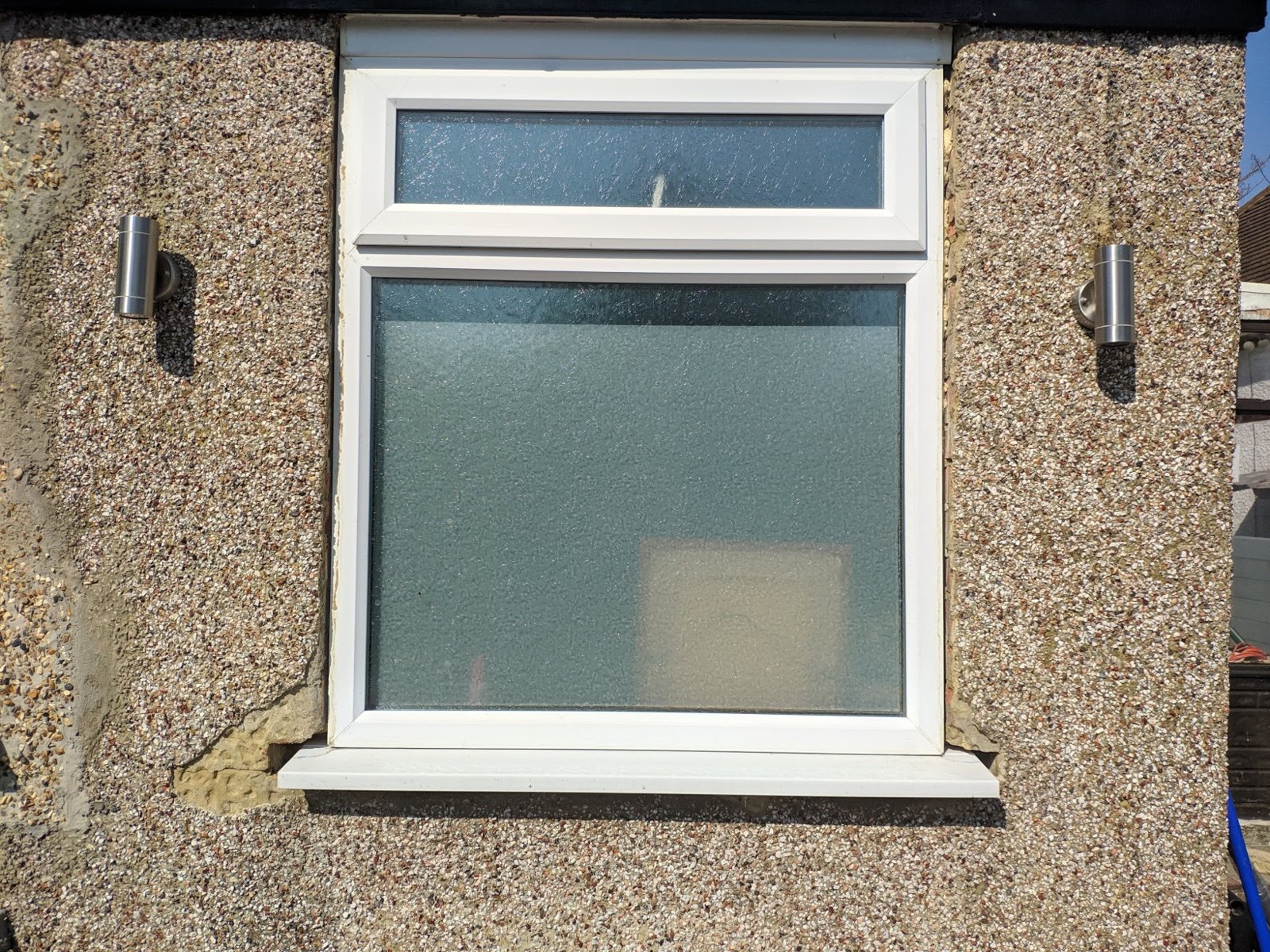

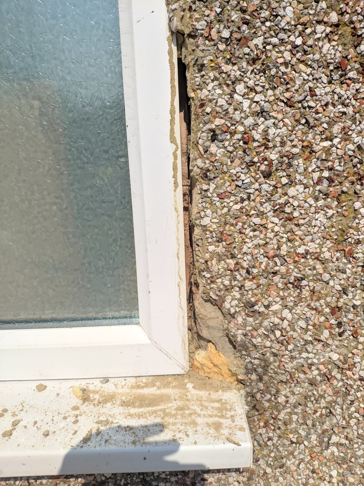

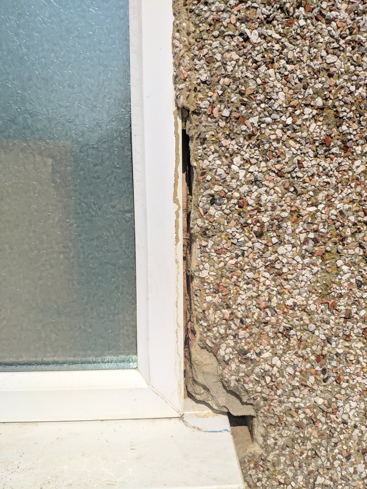

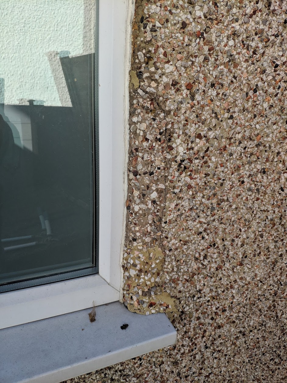

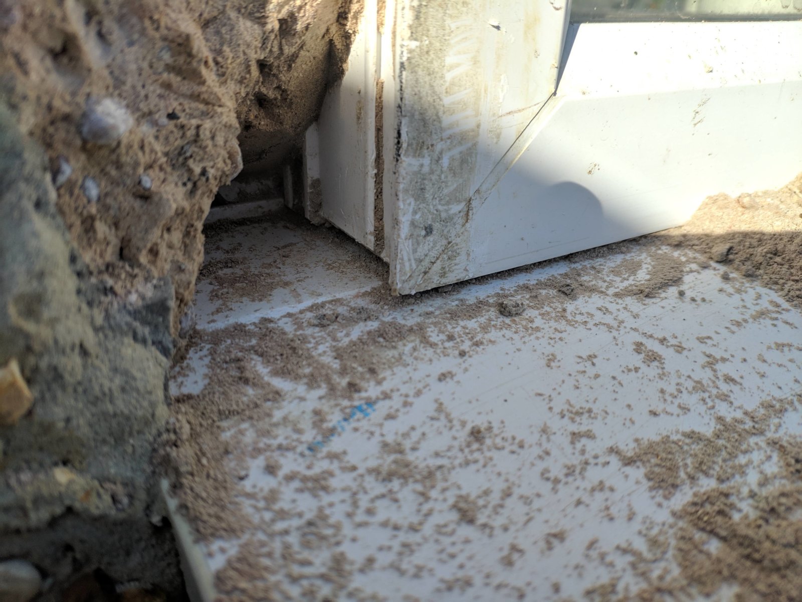

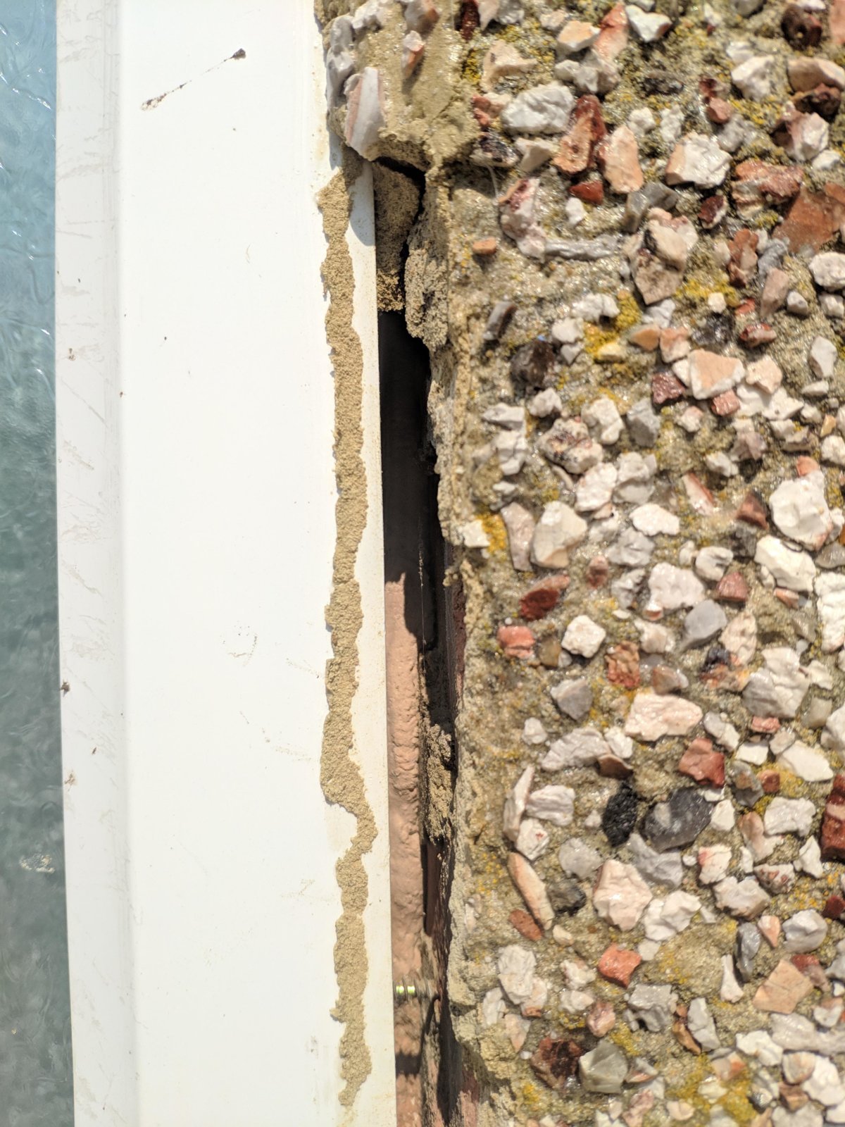

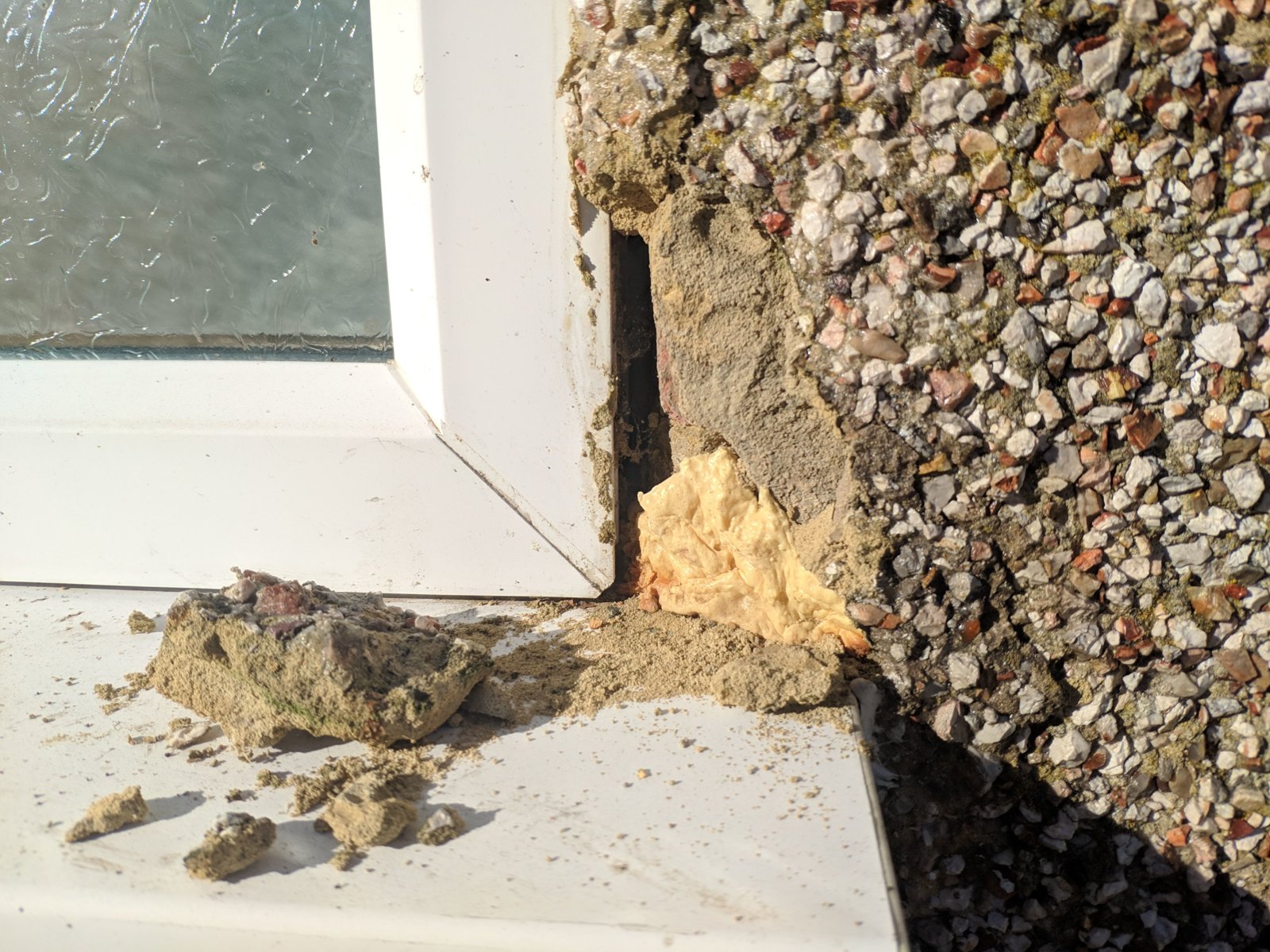

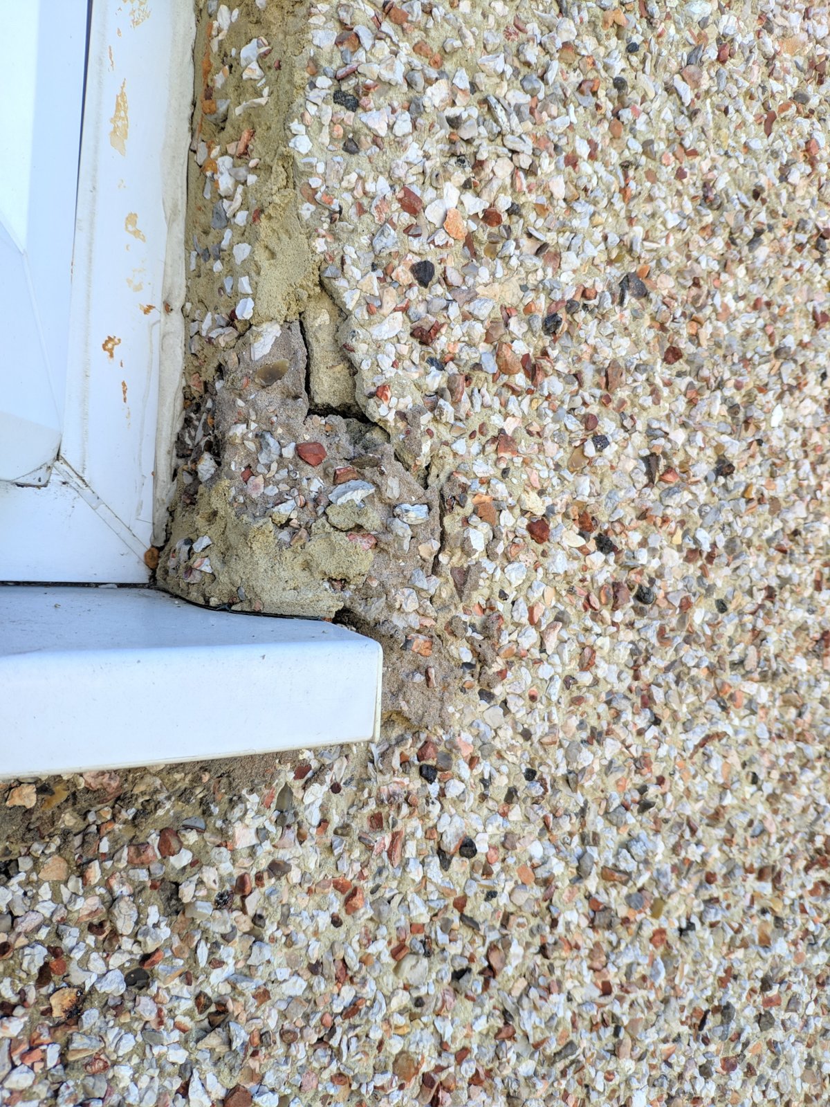

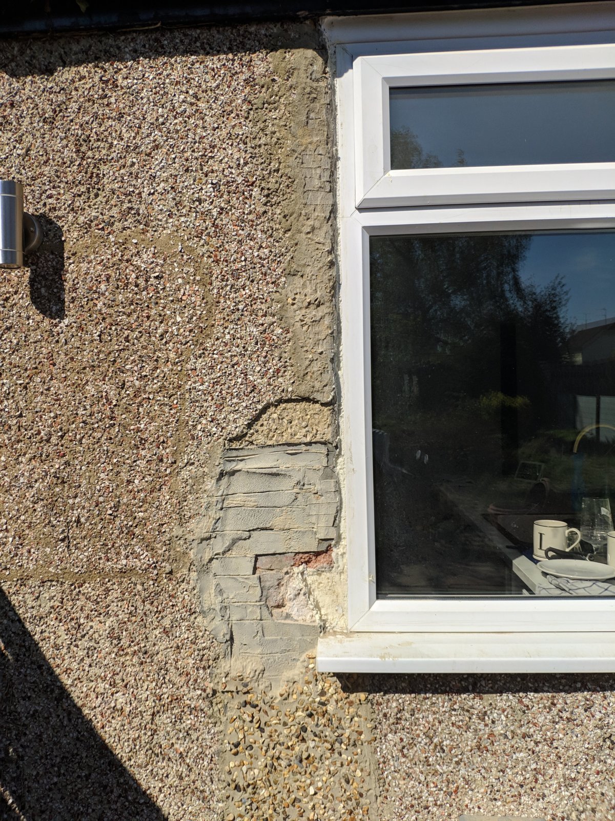

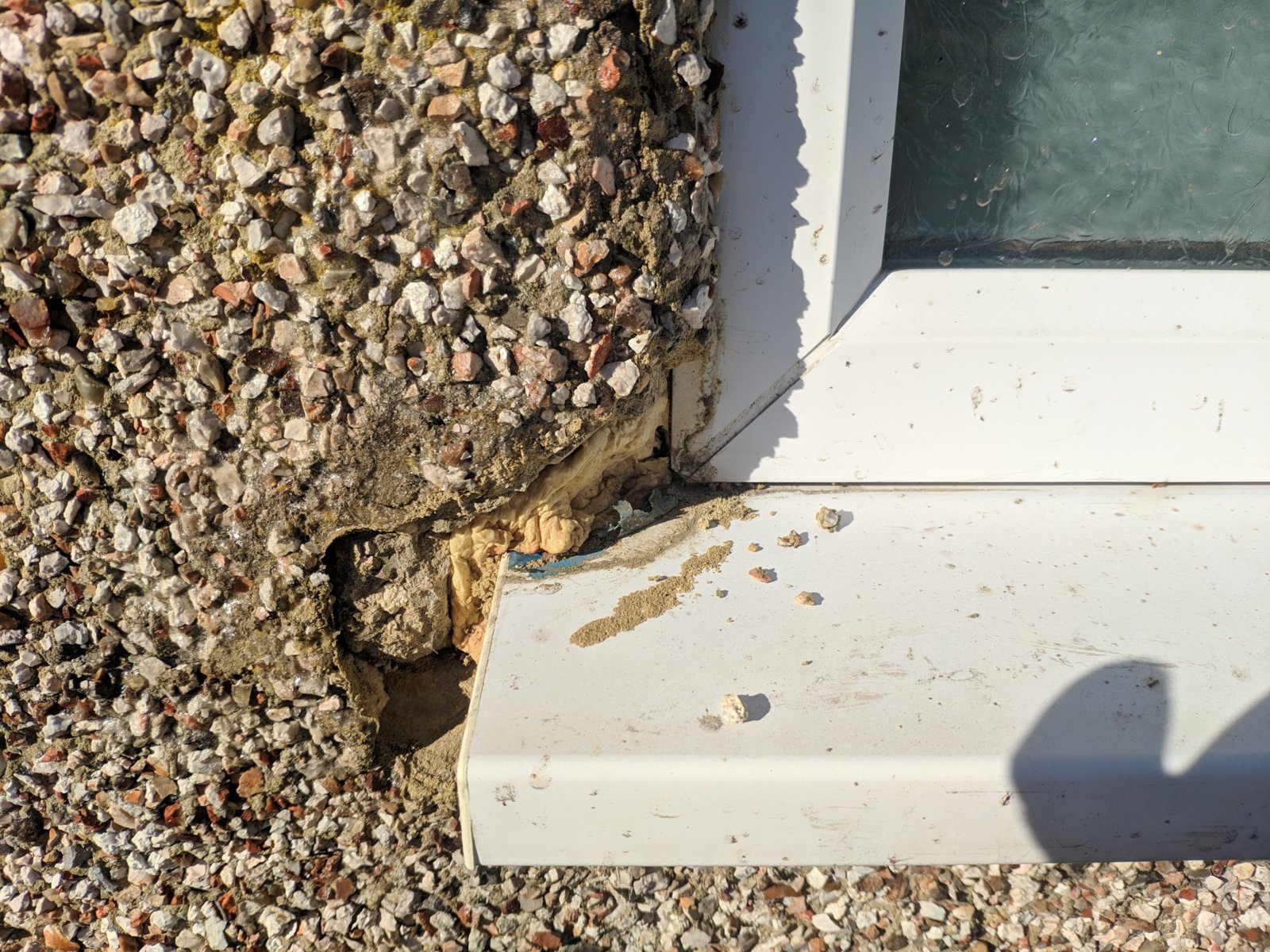

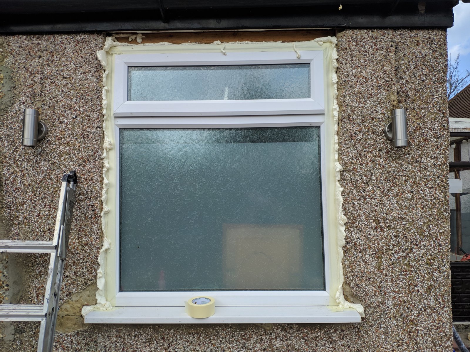

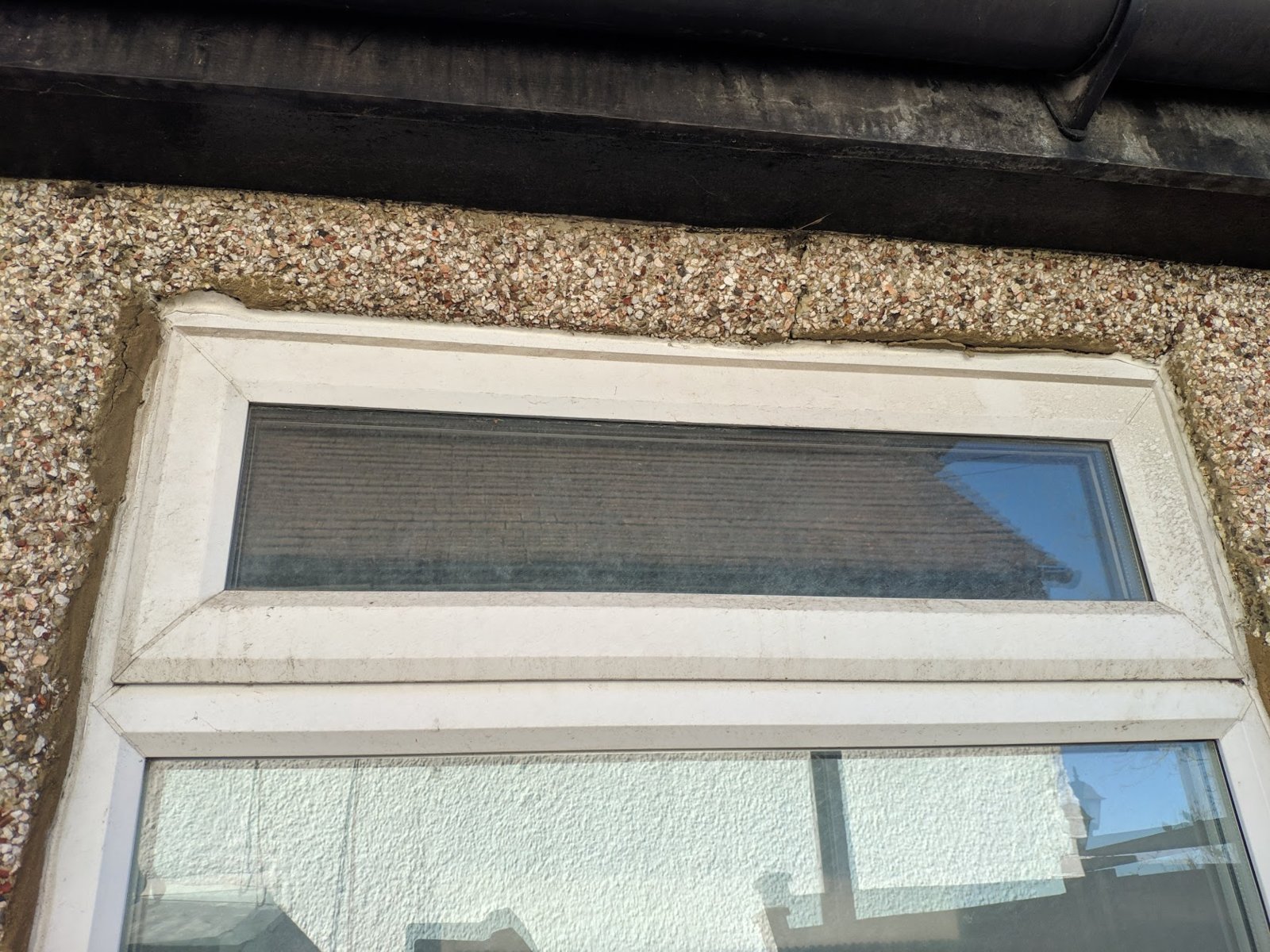

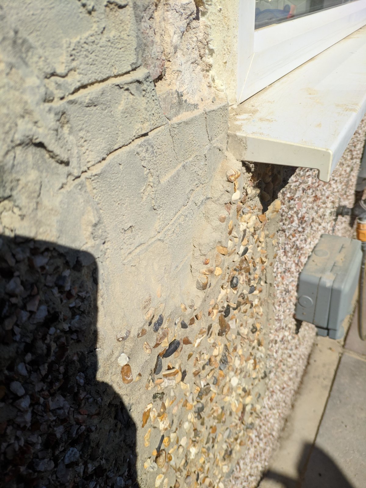

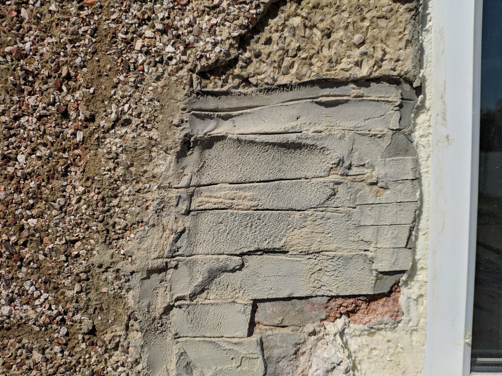

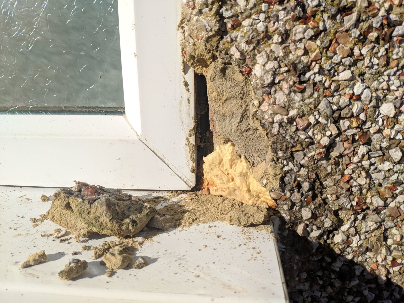

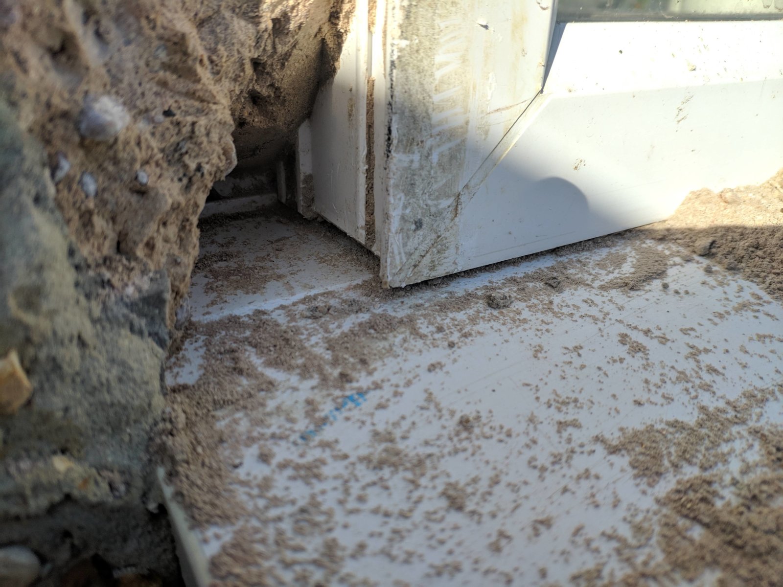

I have been having issues with damp around the corners of our windows and after a lot of investigation the issue has been found! The windows where not sealed with silicone against the sills when they where put in. This means water goes along the sill and into the walls.

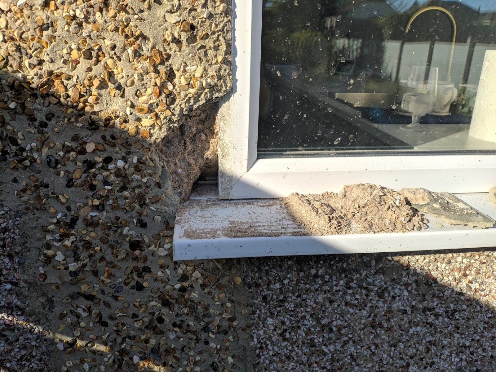

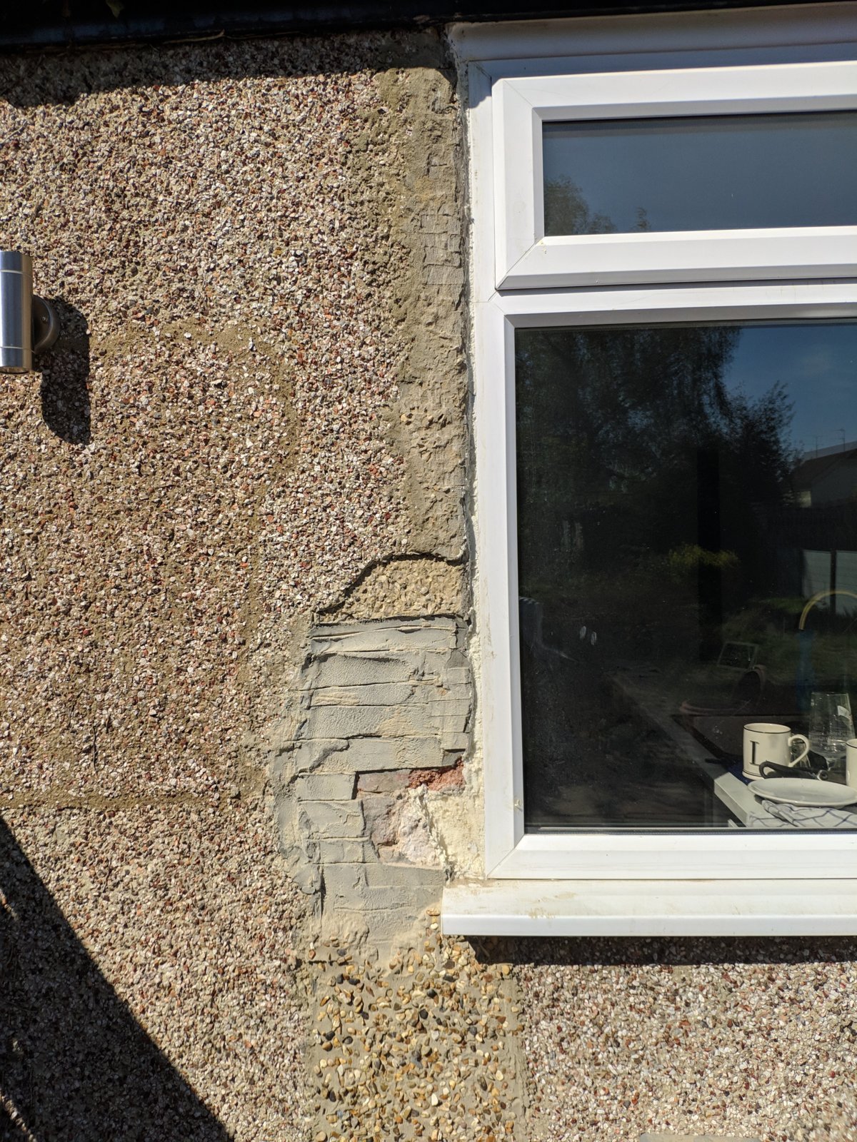

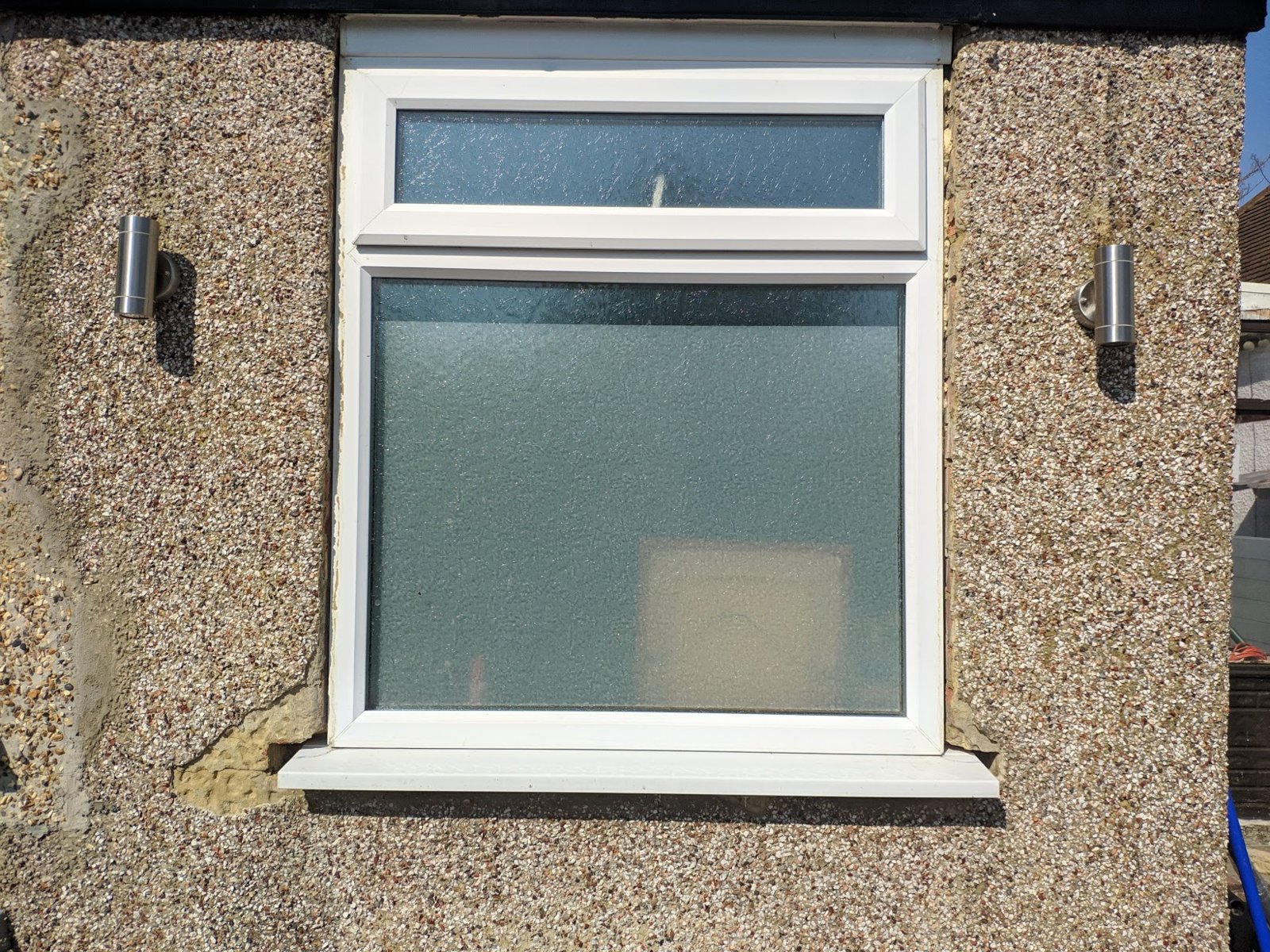

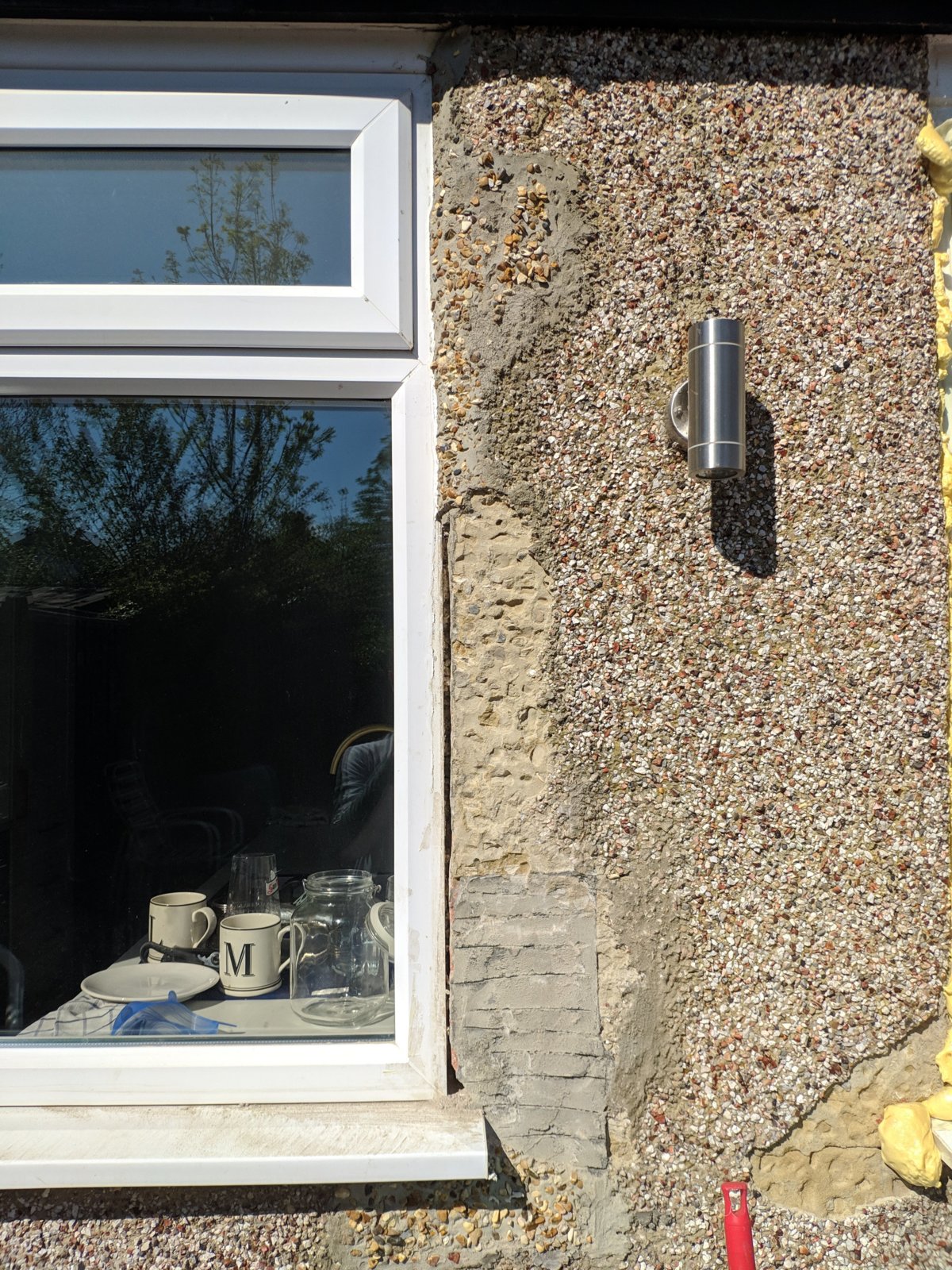

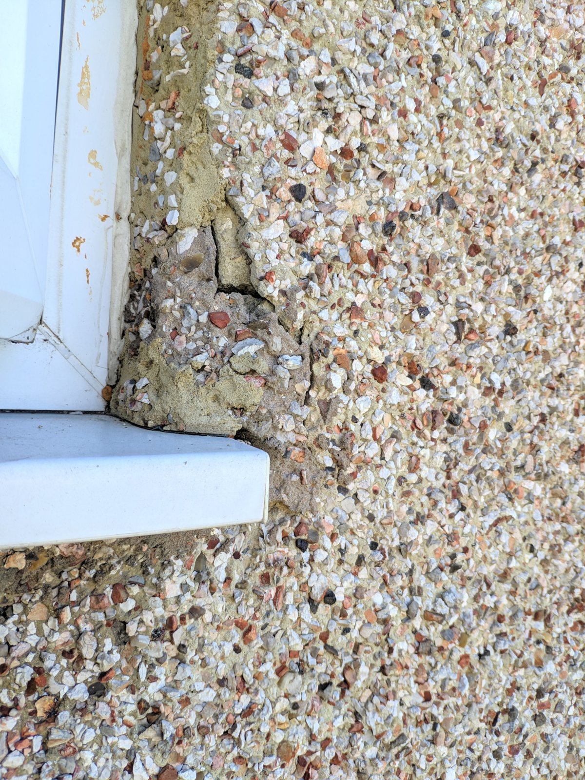

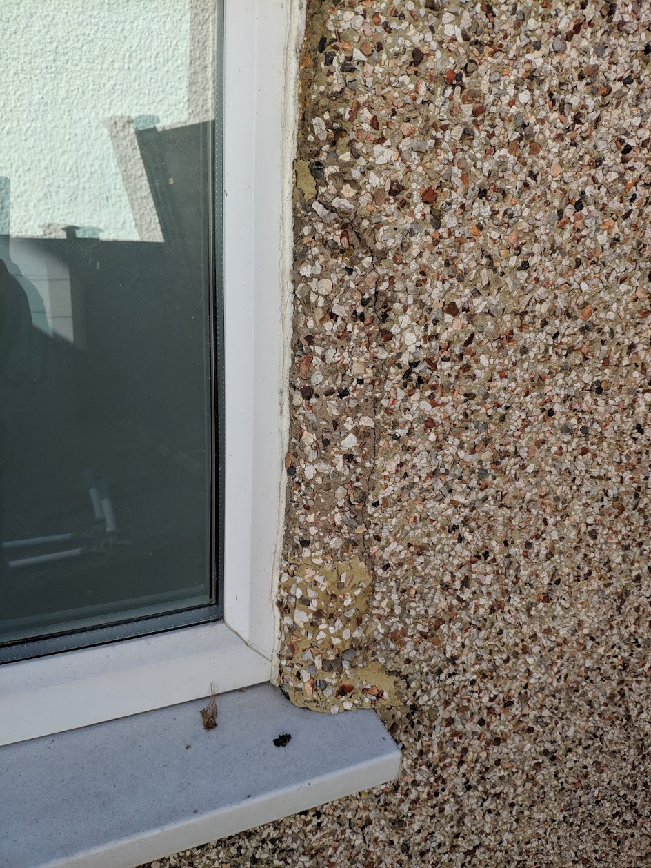

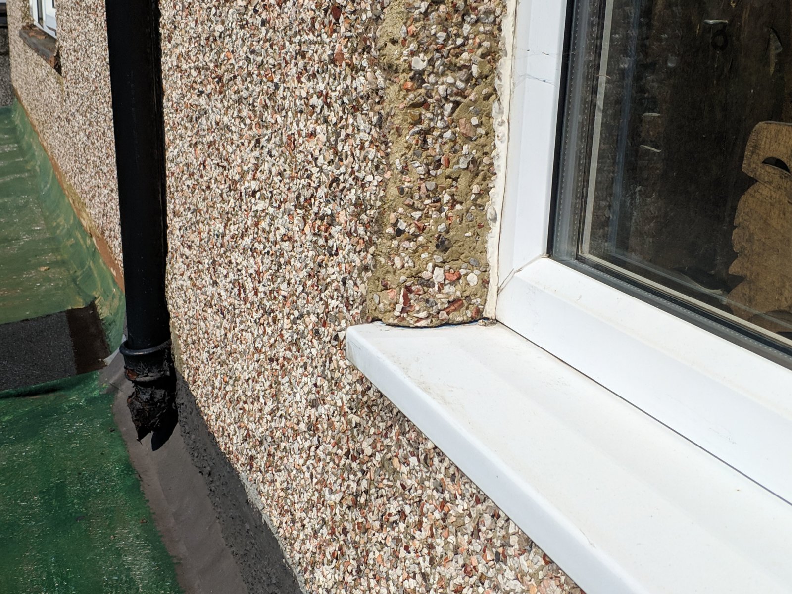

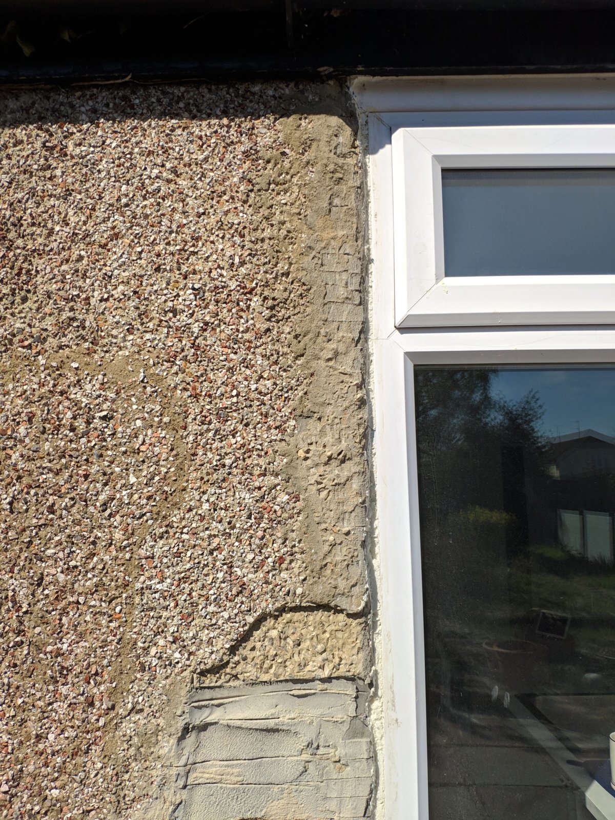

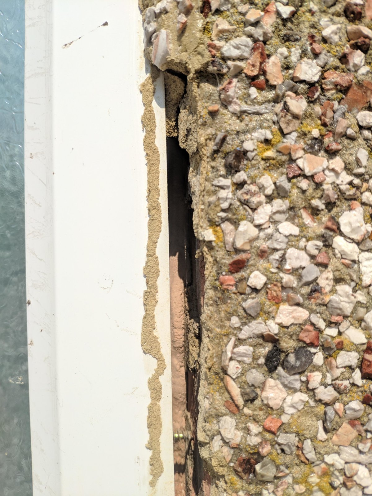

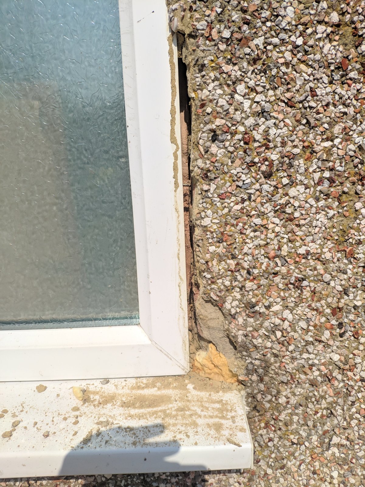

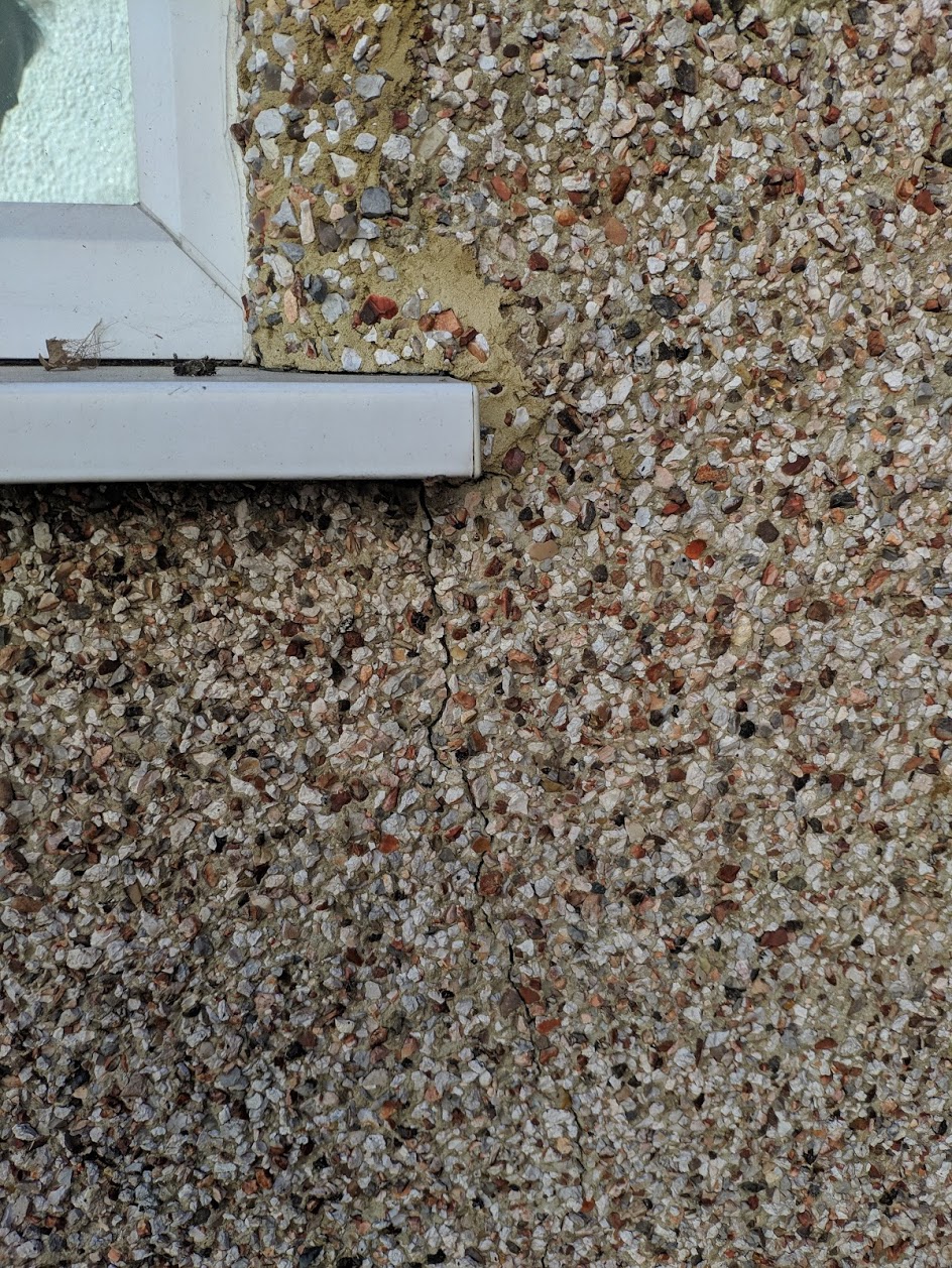

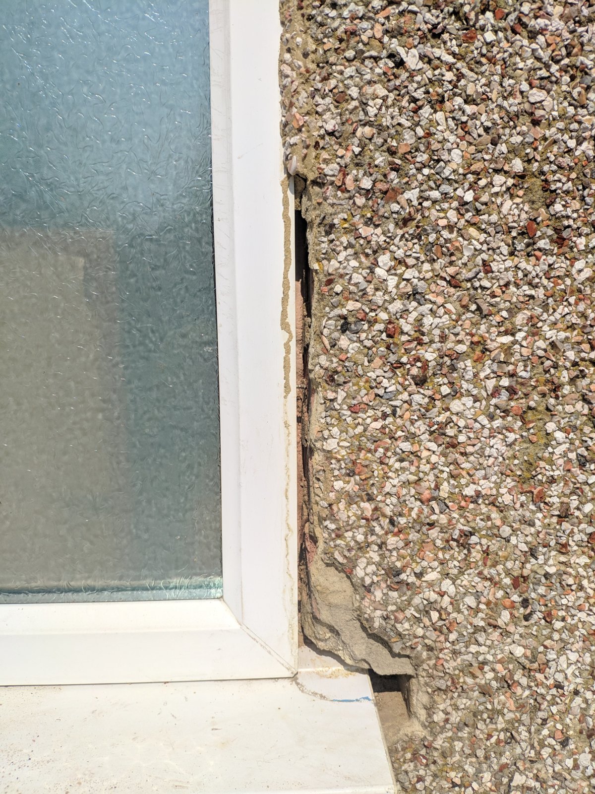

I decided to check out the rest of the windows in the house and all windows have very lose render / pebble dashing in the bottom corners of the windows. Its very sandy and crumbly render. I decided to have a look and inspect the windows. As expected all the windows seem to be missing the silcone and allowing water to get in.
Im asking for some advice on the best way to repair this.
My idea is to remove the lose render from around the window (as I have started to do already)
+ remove any old foam.
+ silcone the windows
+ fill all gaps with new expanding foam
+ ??? Im not sure on the next steps after this. Can I just apply new pebble dash rendering? over these areas? What is the correct way to do this?

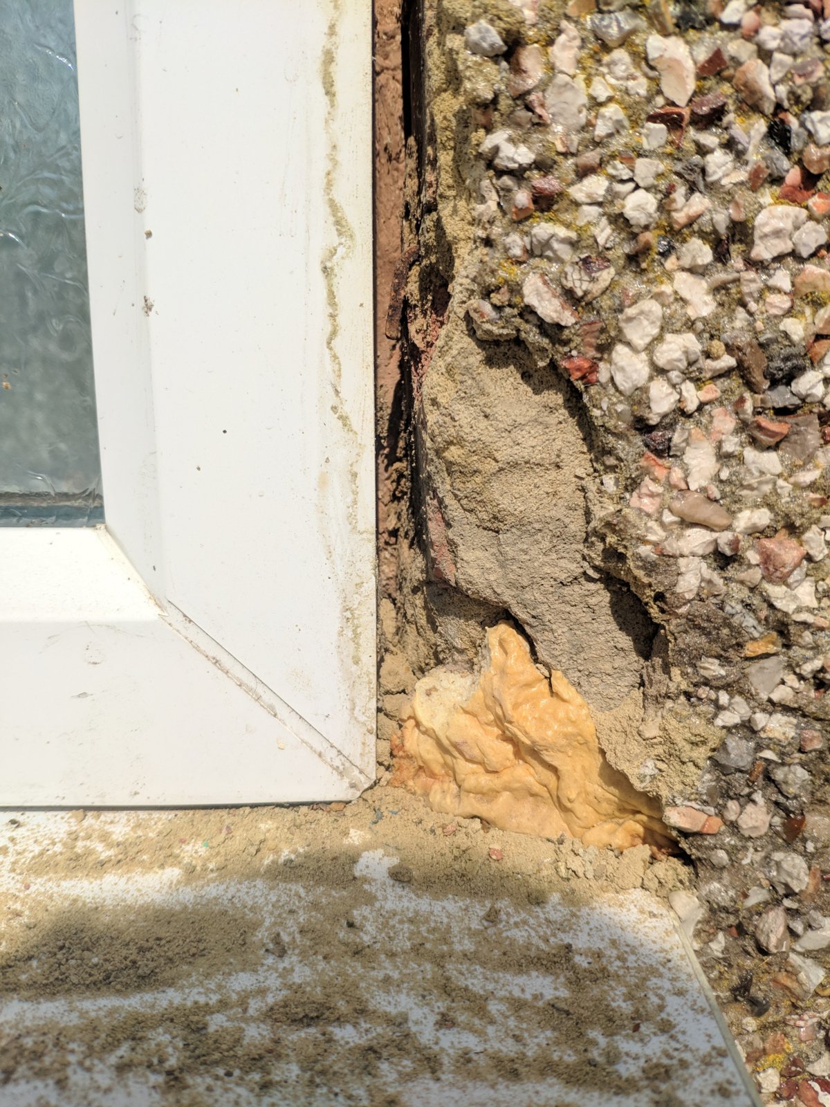

One window just had very soft sand and cement behind the pebble dash rendering which I could almost dig out with my fingers!

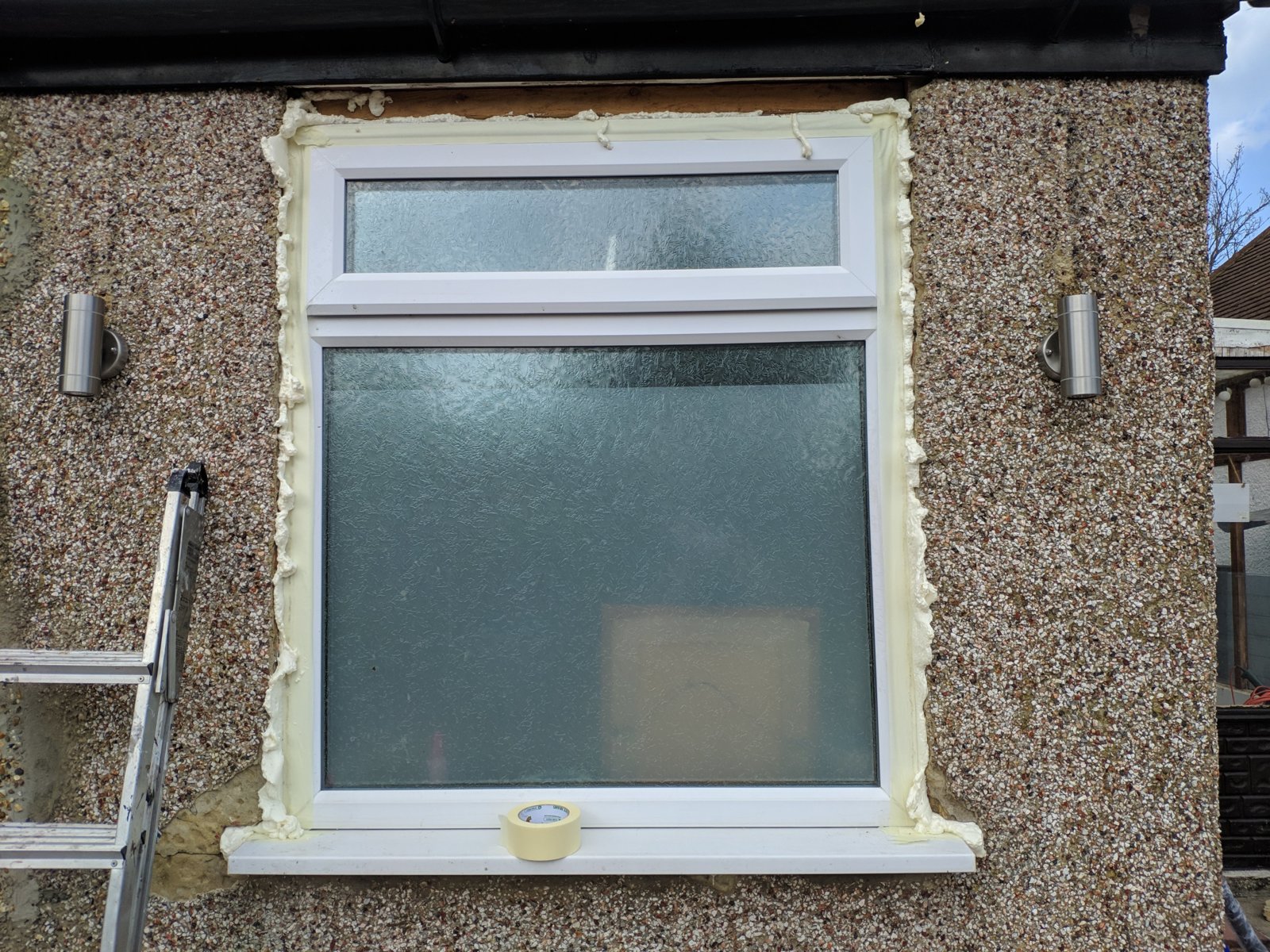

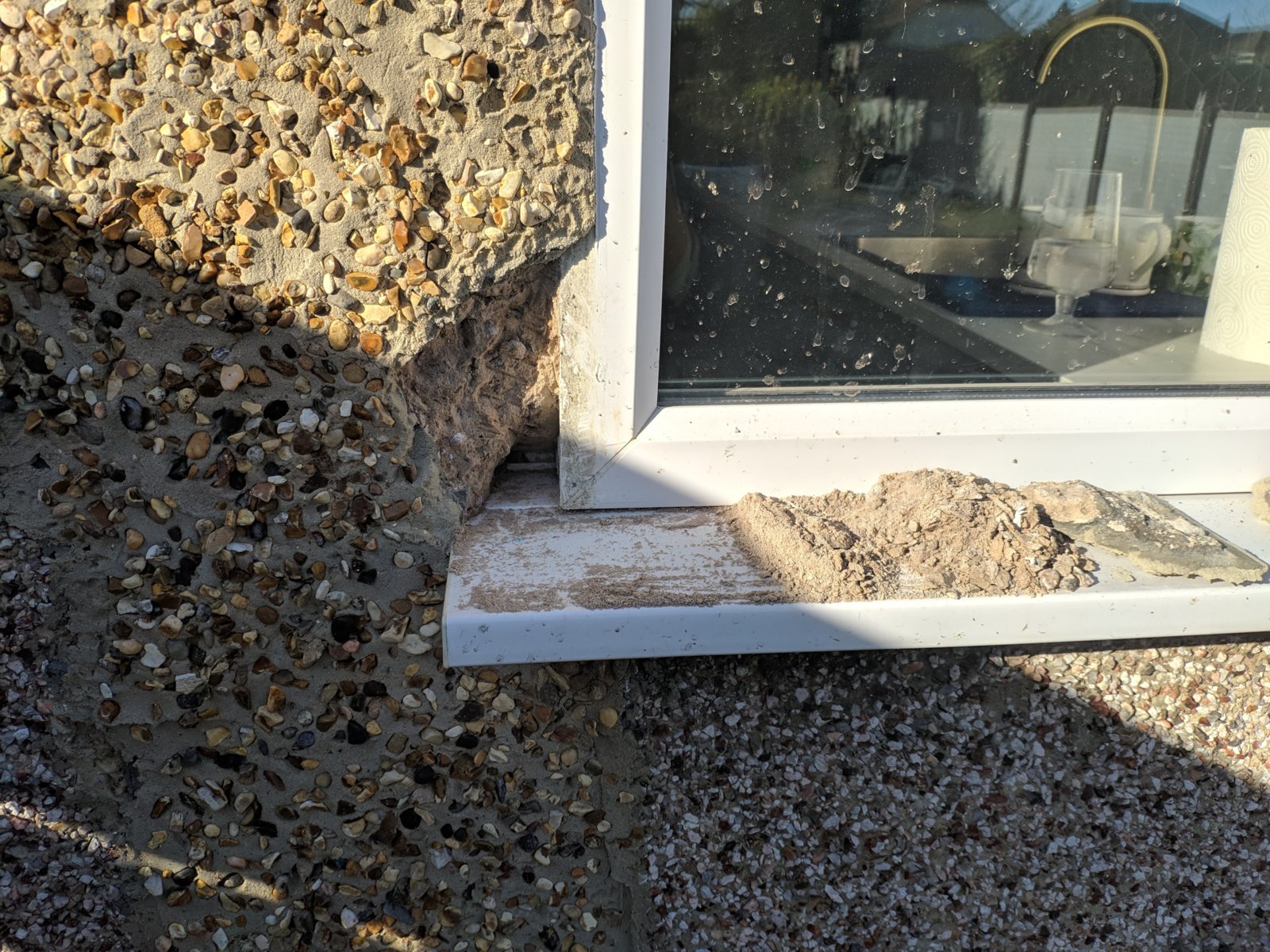

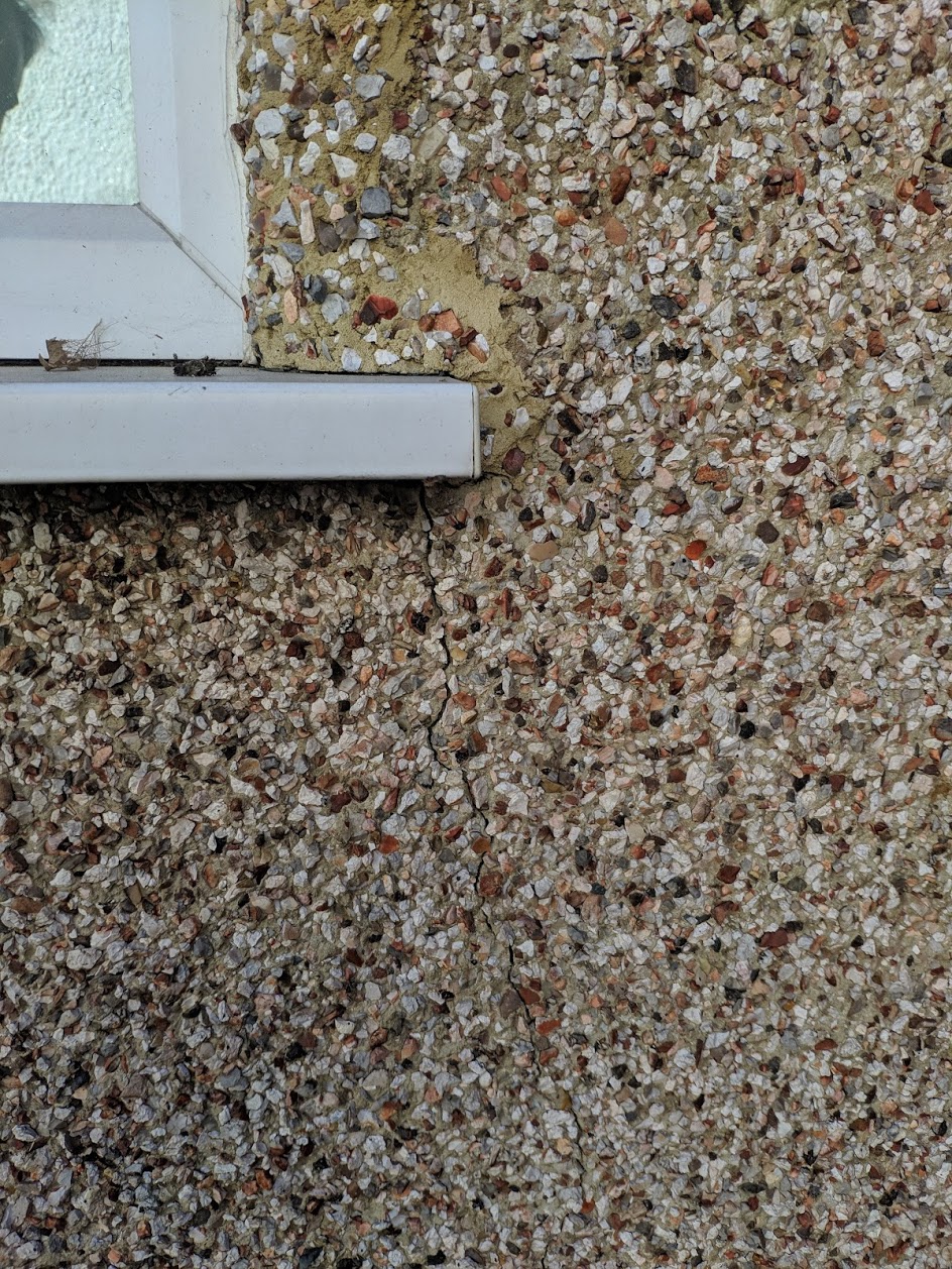

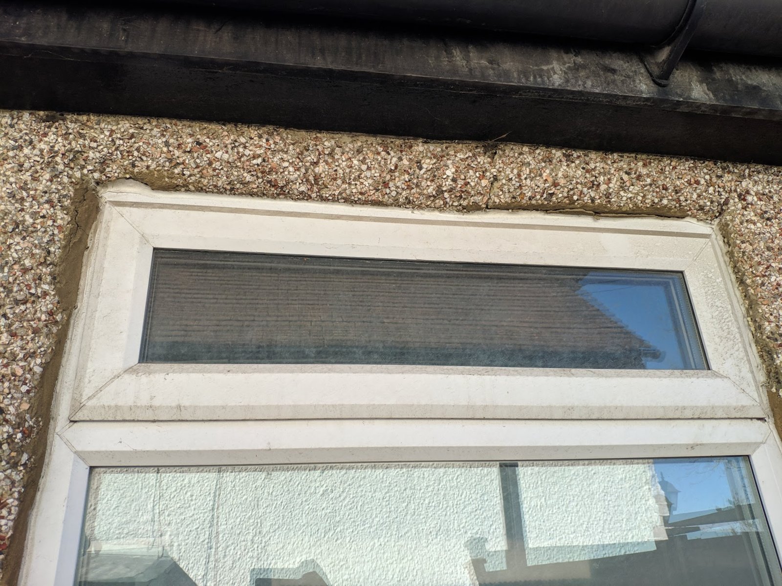

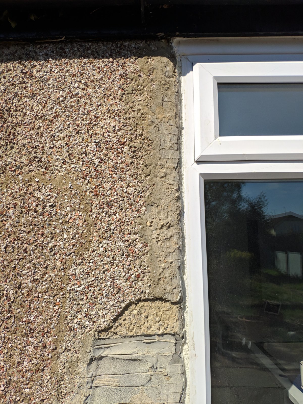

I have attached some photos of the corners of the windows. Two where I have remove the corner render and two upstairs windows and a ground floor side window where I have not removed the render yet...
All windows show signs of damp getting in around the corners.
Downstairs windows with corners removed

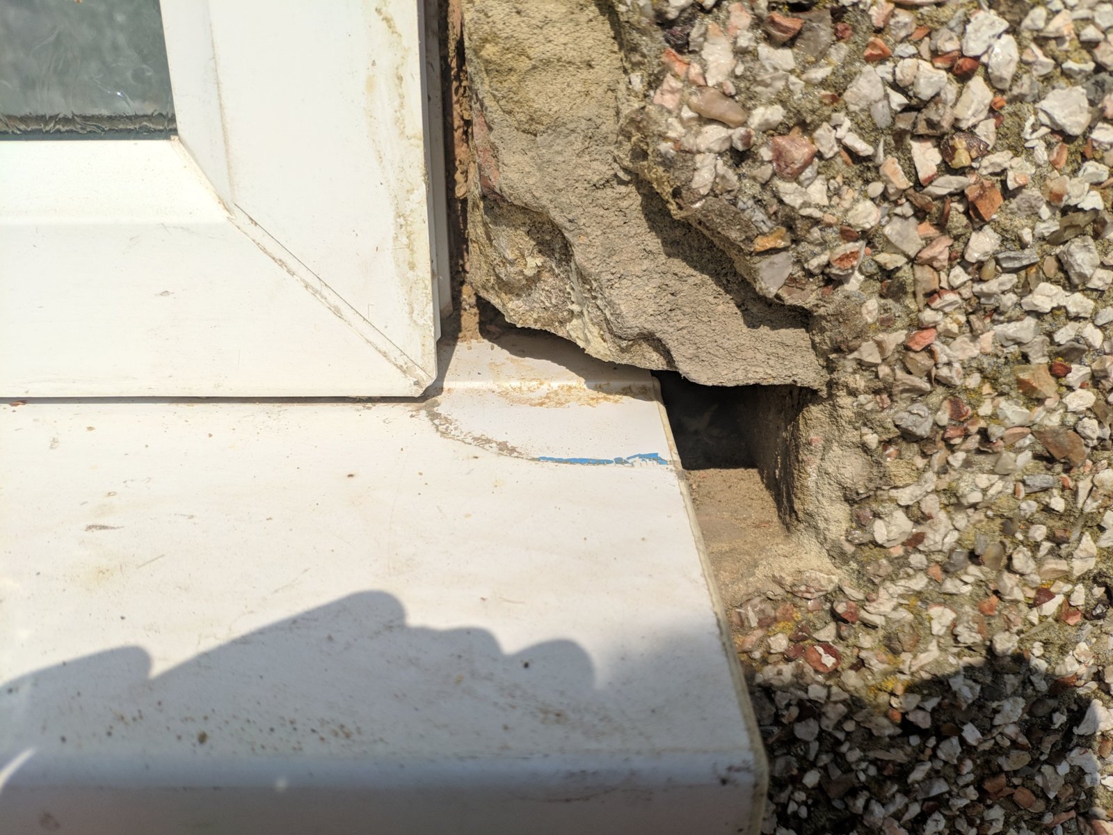

Upstairs windows

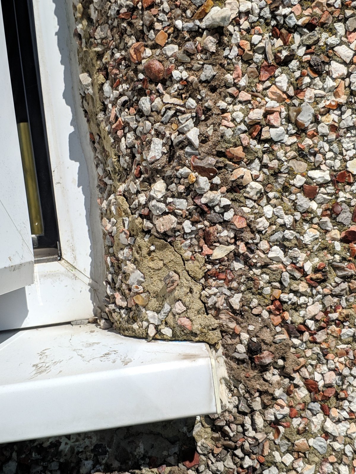

Downstairs side window
