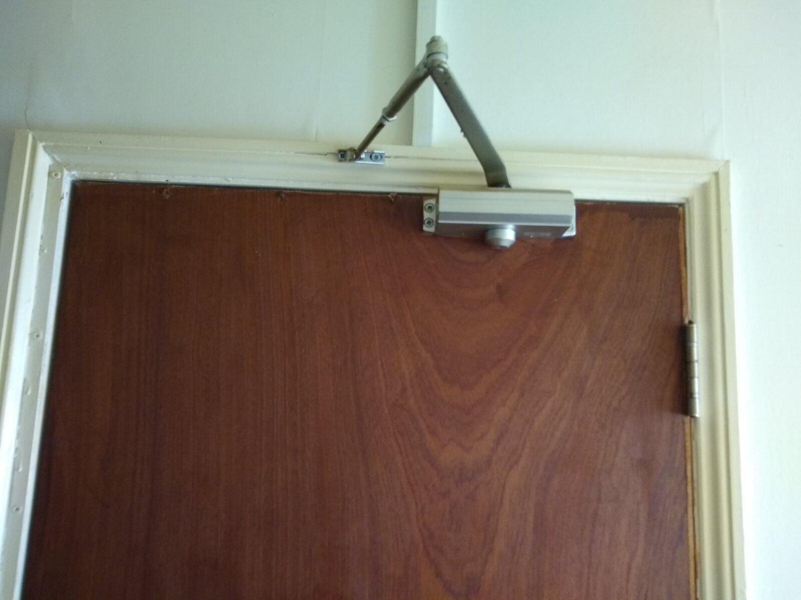

So I own a flat where the front door should have an FD30 rated one and all the bits that go with it. Strips, hinges, closer etc. And I need certificate(s) to prove it to whoever (I'm a freeholder).
I've put the job on mybuilder and I'm getting some prices ranging from £800-£1,400 as basic estimates but one reckons it can be done for about £250. I mentioned that the frame will likely need replacing and they said that with the intimitam strips it will be fine. Part of me wants to run a mile from this but I'd like to get some feedback. I have put quite detailed photo's of the current door and frame but none of these people has seen it in person.

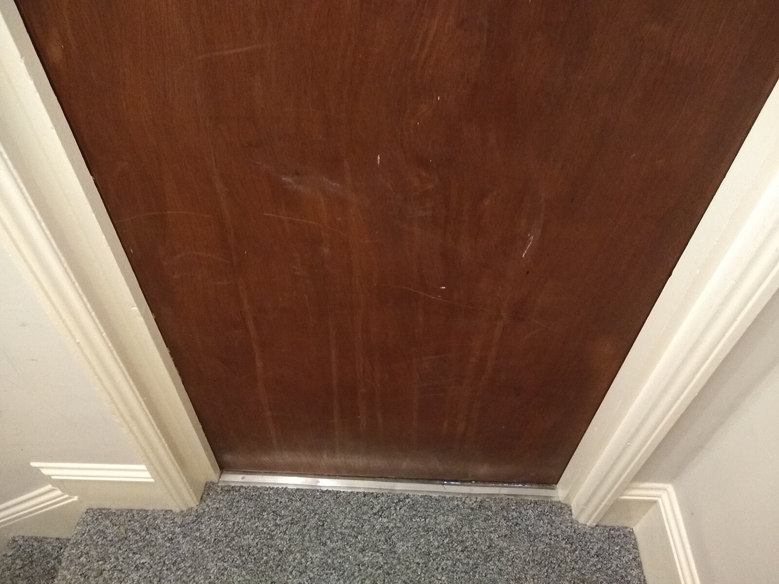

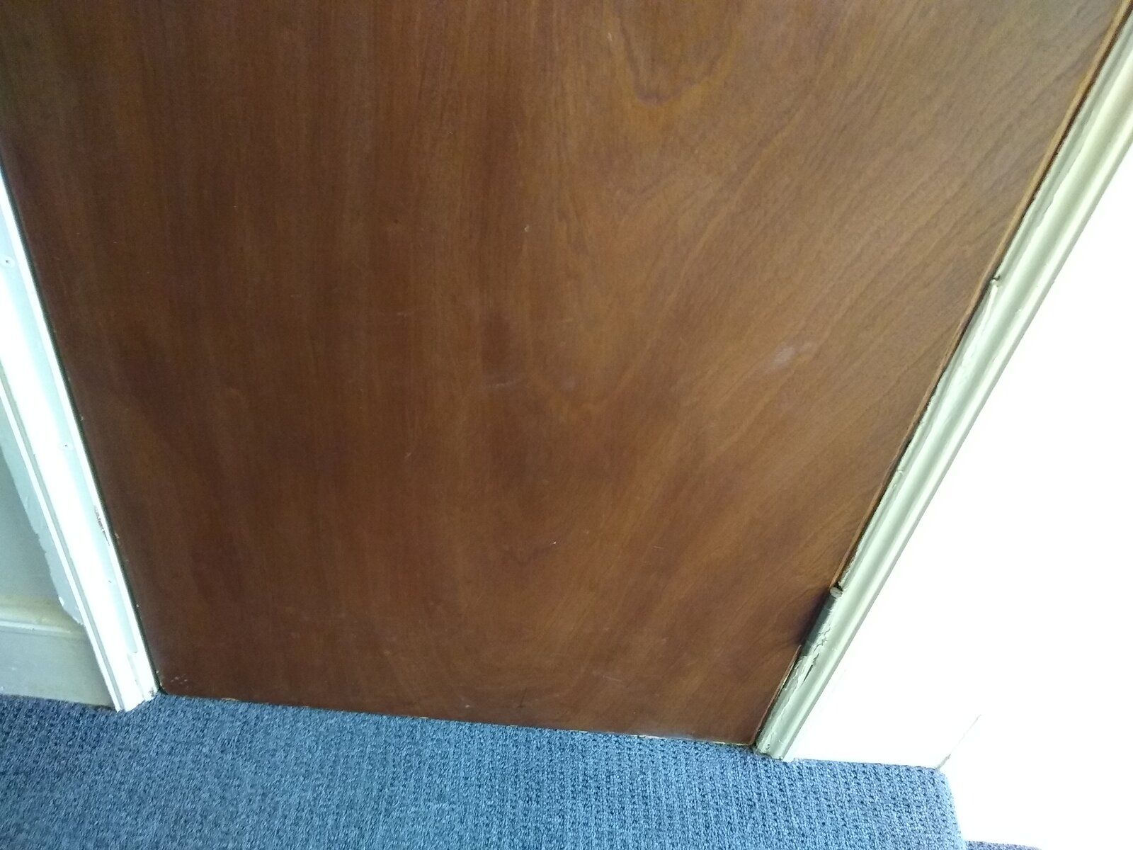

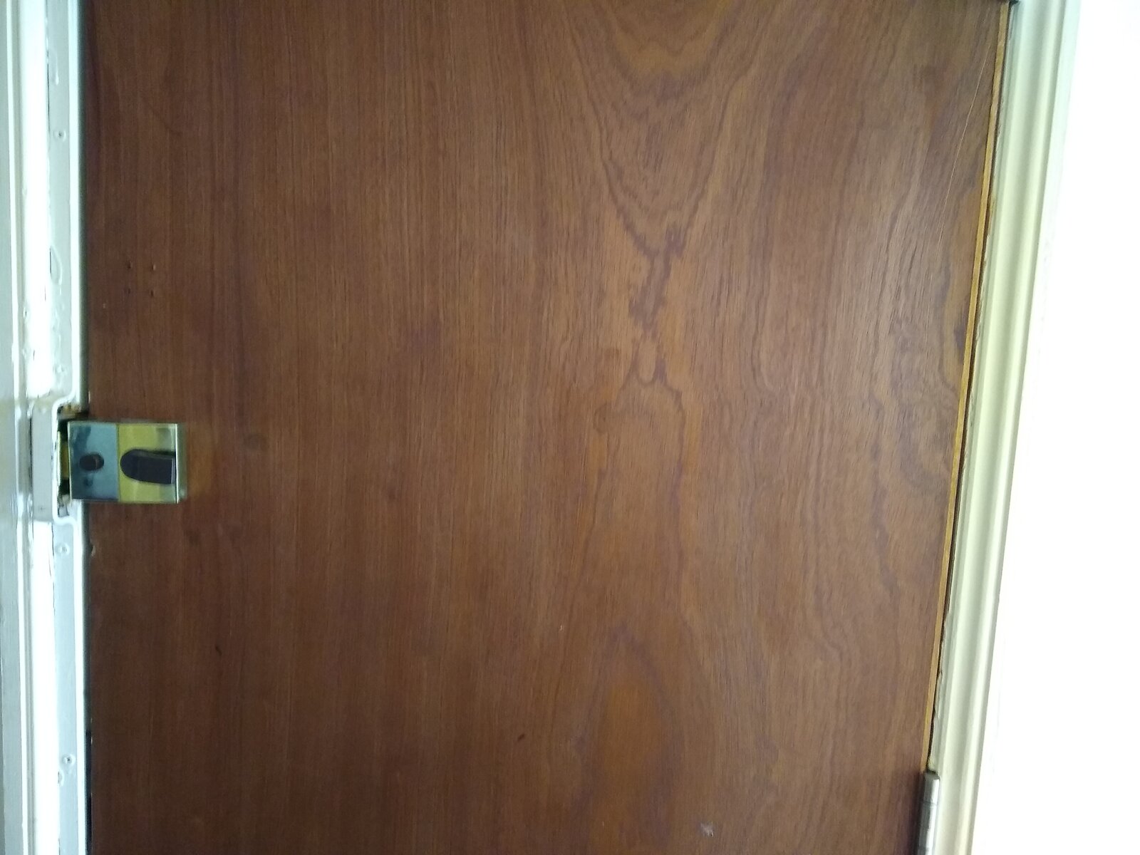

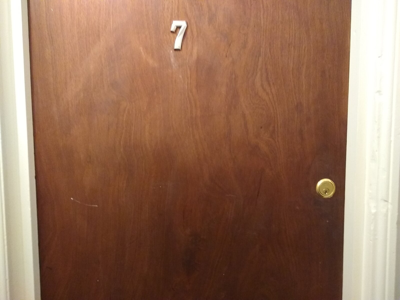

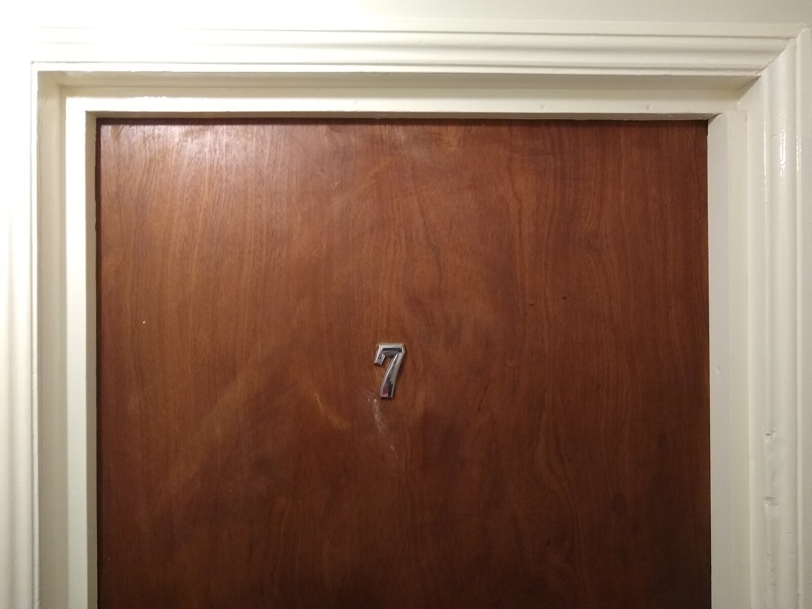

Photos??
My current door is:

As your required door is a standard FD 30, then all the fire resistance around that door will also only need to be 30min fire resistant and from what I can see in your photos, conversion of door and its frame etc to an uprated 30mins will be easy for your 'builder' although somewhat tight on that price of £250; my guesstimate would be around the £350 mark.
So, when this door is fitted, I need someone to do a check of the installation. The fitter will provide certificates for the materials. I think this is the way it works. I was hoping that the company that does the fire checks for the building (8 flats and I'm a freeholder) would be able to do it but thry are not due to visit for a couple of years and the certificate is needed for insurance. So I've had a google but I can only find companies that do commercial. I might be googleing the wrong terms. What/who should I look for and what kind of price am I to expect?
