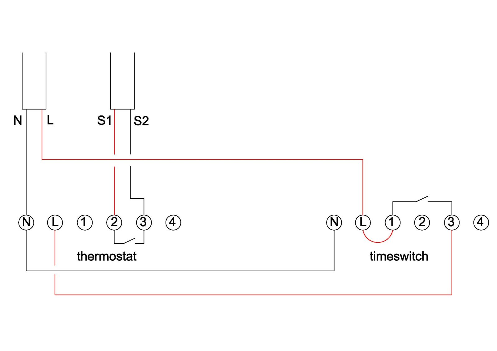

Here is one photos pf the insides.

I can't see all of the wires and exactly where they are connected, especially where they cross over each other, but looking at the photos and the connections together, I believe that one of the incoming cables will have its wires connected to the thermostat terminals numbered 2 and 3. These will be the switching wires. The other cable will be the 230V mains supply, the red of which I believe will go to the Timeswitch 'L' and the black to the Thermostat 'N' If the reality is different post back what you have.
From what I can see in your photos and knowing how the two items work, I believe this is the wiring is now. If it's any different, don't proceed and post back.

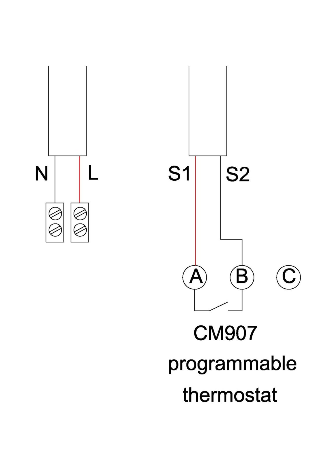

The CM907 is battery powered, so it does not need the main L and N 230V supply. The wires should either be disconnected from their source and removed, or isolated & insulated safely and tucked out of the way in a corner of the thermostat enclosure. Personally I would chose the latter in case they are required again at some point in the future.
The two remaining switching wires would then connect to the Honeywell CM907 as below.
