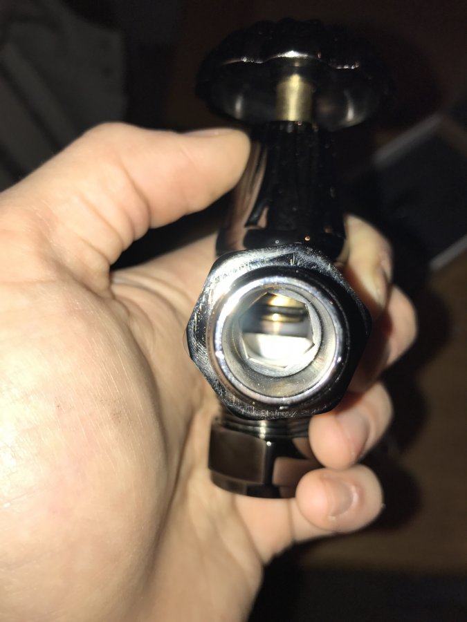

I replaced 9 radiator valves today (gone from TRV to manual cos the TRVs were not working out).
2 of the radiators are taking forever to heat up. They are not the first or last rads on the circuit.
The flow pipe to the rads is searing hot, but the radiator lukewarm and the return pipe colder still. I therefore don't think it's a balancing issue.
I've had a look inside the valve and when fully open the close-stop seems to only be half way up I would have expected a bigger gap for water to flow through..
Is this enough or is this causing reduced flow into the radiators and therefore the delay?
I've attached a pic of the valve.
Cheers!
Sounds like a balancing issue to me
Even though the flow pipe is burning hot and the rads are not the first or last on the circuit?
The lockshields haven't been changed.
The flow pattern geometries of the new valves have probably been enough to upset the balancing.
Try re-balancing.
How much water do you think flows through a 1kW rad every minute? It's not very much.
For a 10C temperature difference it is 1.44 litres; half that for a 20C difference. A two kilowatt rad will be twice as much - it's proportional.
Just to give you an indication of how little a valve needs to be opened, a good starting point, when balancing a system, is to open all lockshield valves by half a turn. Then make minor adjustments (1/12th turn or less at a time) to fine-tune the system. The most any lockshield valve needs to be open would be about one turn.

I ditched the TRVs because they were closing and staying closed for hours at a time even though the room and radiator was freezing. As soon as I took the cap off hot water flowed into the radiator, so I've had no TRV caps for a few weeks. They were crap.
I'll work on rebalancing. Cheers.
OK, they could have been cheap TRVs - you don't say which make/model they were. But your problem might have been caused by poor balancing, which could have meant that the pressure differential across the TRV exceeded manufacturer's specification. When this happens a TRV will behave like an on/off switch, rather than a proportional controller.
