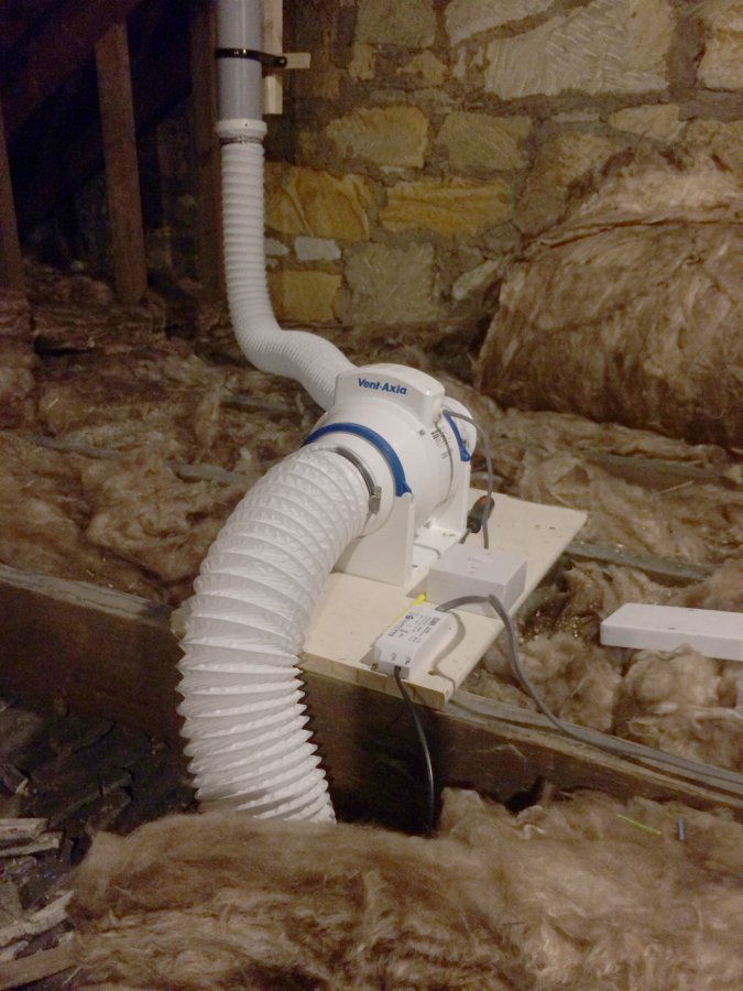

A lot of the fans you can buy now, especially out the DIY sheds are rubbish. I'm in the middle of fitting this for my ensuit/shower
Its about £150 compared to the typical £30-50 sort of fan, and its pretty impressive how much less noise I get from this compared to a cheap bathroom extractor (and this isnt even one of the purpose made quite models)

Even better if you ensure the pipe has a continuous rise on it to prevent water condensing and blocking the pipe ;)
Not finished yet, still got the loft insulation to put back down and joints to tape up, after which it will have a rise lol but well spotted
Rykard, is that wall go direct to outside, or is the fan located further away and that's just the inlet duckt?
You see the staining on the grills? Probably means there's a load of carp in the actual fan itself, could be worth stripping it and cleaning it out and using a can of compressed air (keyboard cleaner) on the fan/bearings
Apart from that I would just replace it
