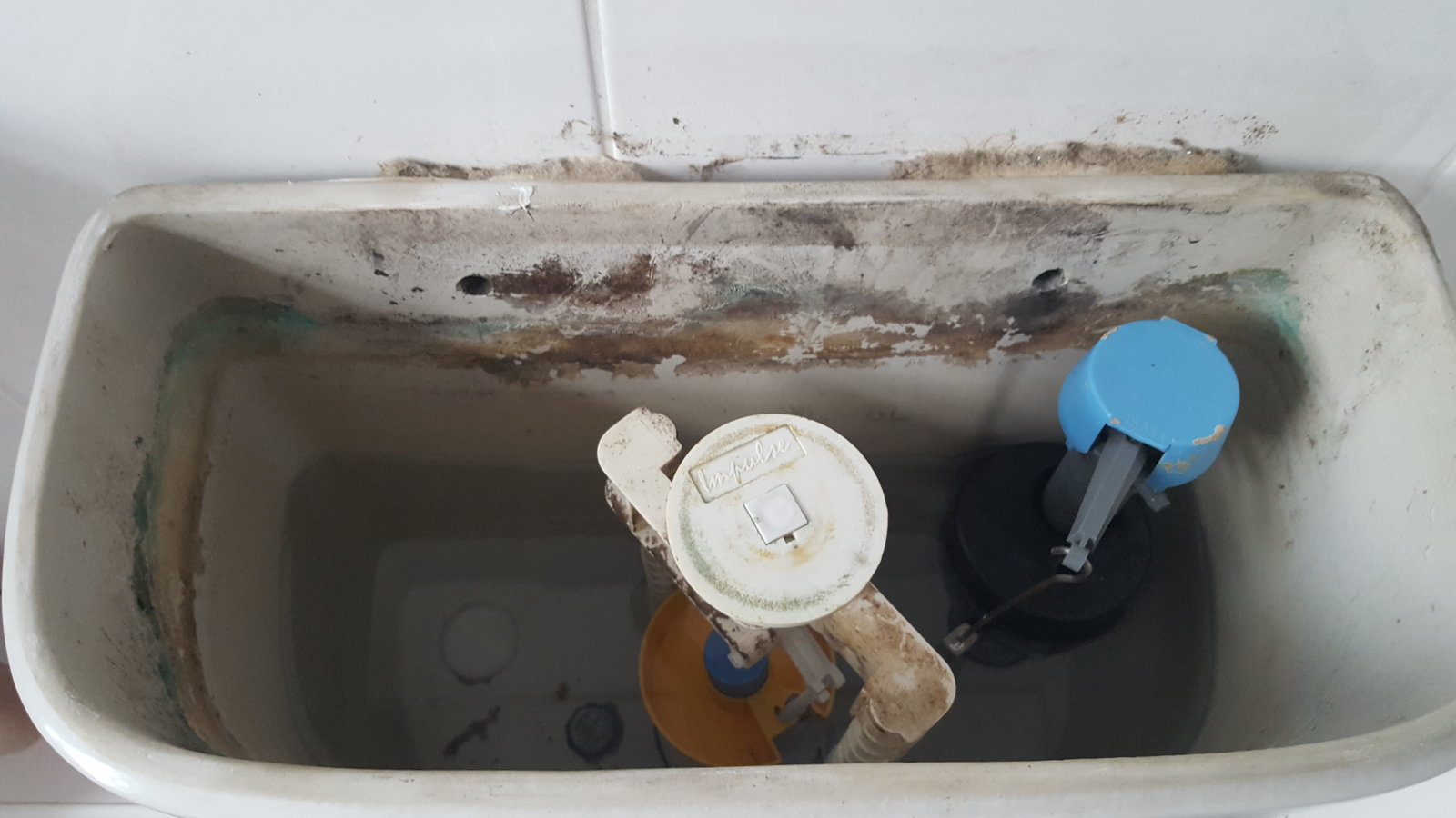

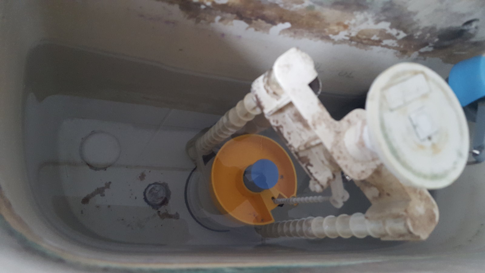

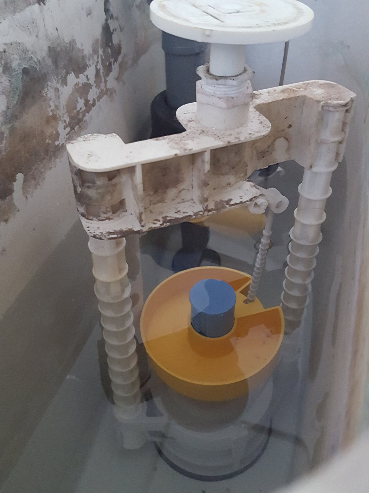

After having problems with a toilet which intermittently decides to continuously fill (normally in the middle of the night) I am looking to replace the fill valve (think thats the right term) it looks like a fluidmaster bottom entry one and should be a direct replacement.
My thoughts are that i take advantage of the fact that i have the water off etc to replace the flush mechanism too? Bathroom was in house when we moved in nearly 10 years ago so guessing its at least 12 years old.
The problem is it seems to be an impulse dual flush but they dont make them anymore. Can anyone recommend a decent replacement. Most of the ones i have seen online seem to have a cable mechanism linked to round flush buttons. Ours has no cable and an oval flush button.
Assuming I should replace the washers for the bolts joining the cistern to the toilet and the larger 'coupling gasket' too as they seem to be pretty furred up with what looks like limescale?
Finally is this a job best left for a plumber or something an optimistic diy'er could tackle.
Sorry for the long post - all help appreciated.
I have attached a pic
photo's are not very clear ,anyway ,as long as the hole in the cistern lid is round ,not oval, then a cable operated flush valve would be OK. cistern ,as far as I can tell from pic, does not appear to be anything out of the ordinary. you can buy for a couple of quid , a close coupling kit , new donut washer / bolts / nuts / flange . I prefer fluidmaster fill and flush valves , never had a problem,and get the fill valve with the brass threaded tail. if you have the tools its not particularly difficult to do. you must replace the seal where supply pipe fitting meets the fill valve tail.( more commonly known as the float valve ).

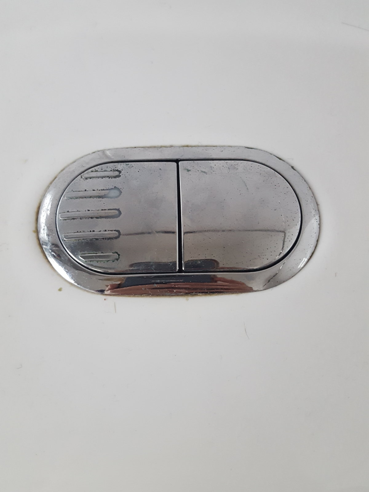

The push button is oval so I guess my options might be more limited (and probably more expensive) any suggestions?

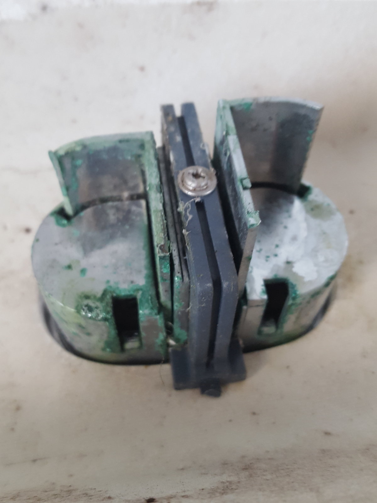

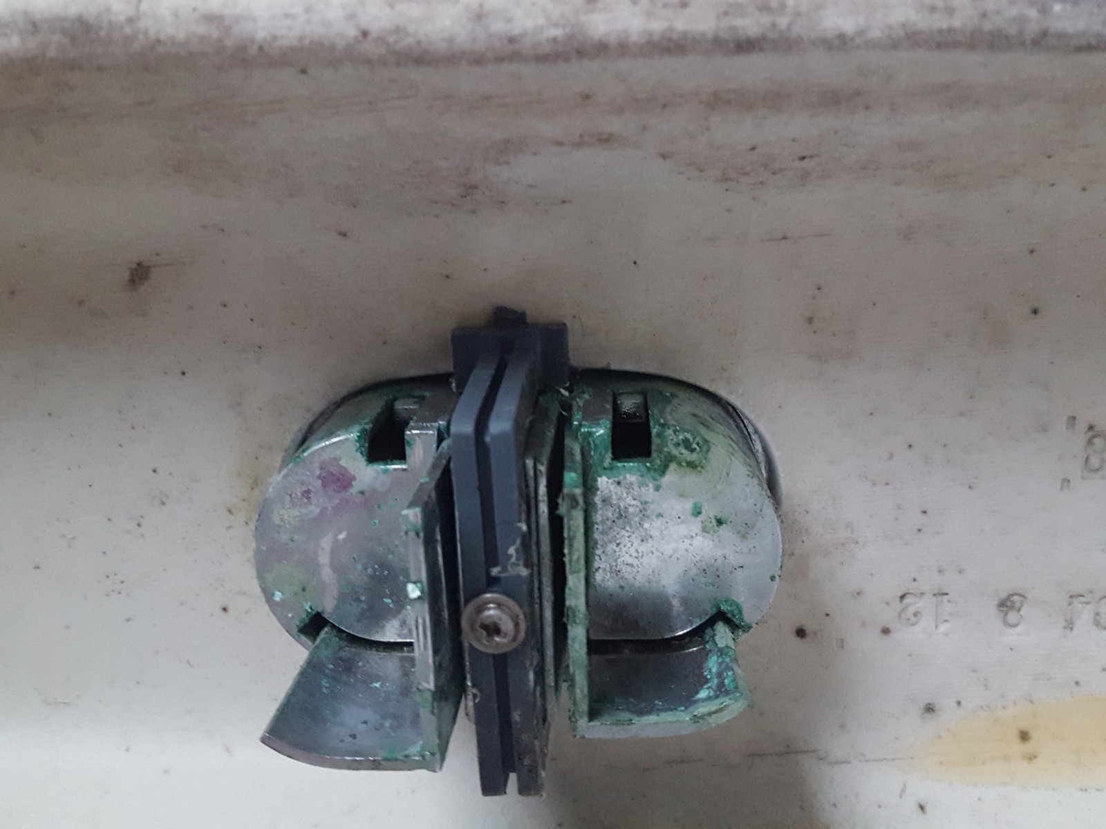

but is the hole on the cistern lid ,where the push button fits , round ??? as I have never seen one with an oval hole ??
Definately oval/ elongated shape
Pic 2 shows underneath
well those new pics sure look as though its oval !! new one on me !!! measure width and length of hole ,you may well find a replacement that is oval on top ,with a round " shank ". as long as it covers the hole in lid it will be fine .
