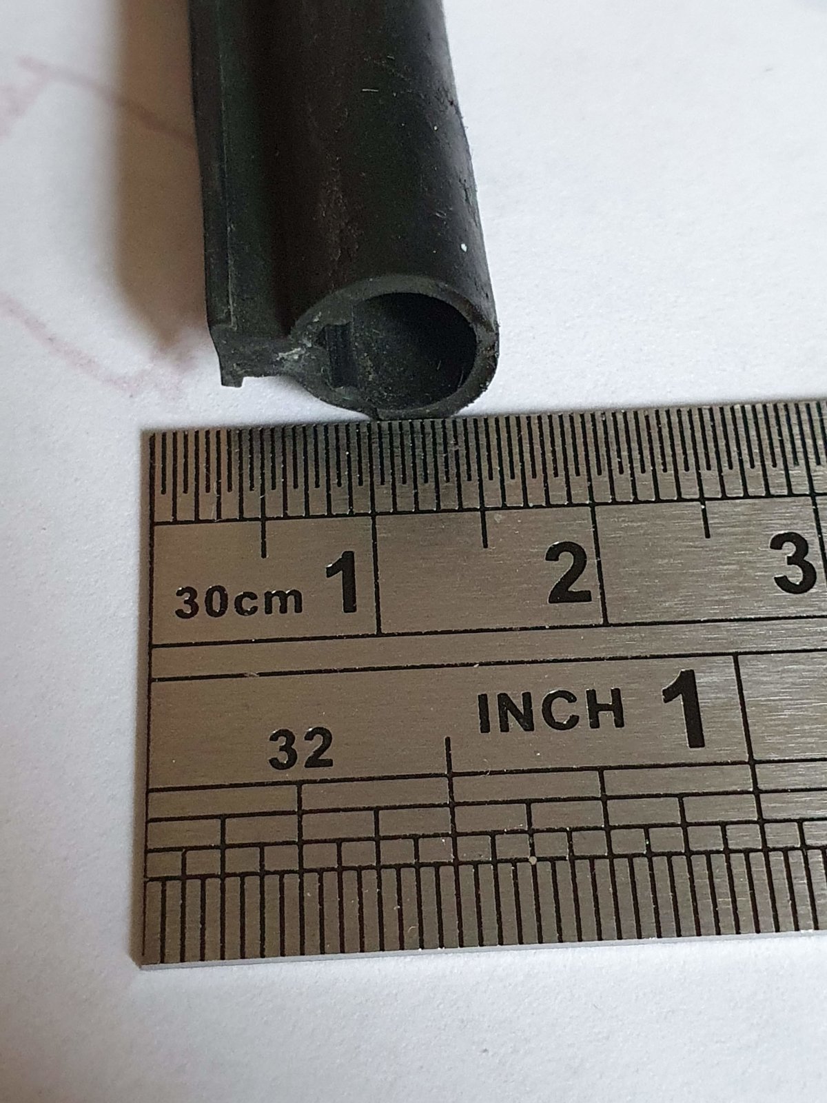

The door seal on a couple of our doors is damaged and falling off so I need to replace. However, when I measure the profile it does not appear to fit the standard seal dimensions:
The 'universal' upvc seals appear to be approx 6mm, but this looks more like 10mm to me?
Can anyone recommend where I can get this from?
Thanks,
Gaskets are notoriously hard to measure accurately due to the rubber being so flexible.. looking at that I would do a search for B006 bubble gasket on evil bay, I suspect that is closest
Some of the retailers on fleabay do a sample pack if you get stuck. And if you get really really stuck, Extrudaseal do a matching service if you send them a sample.
