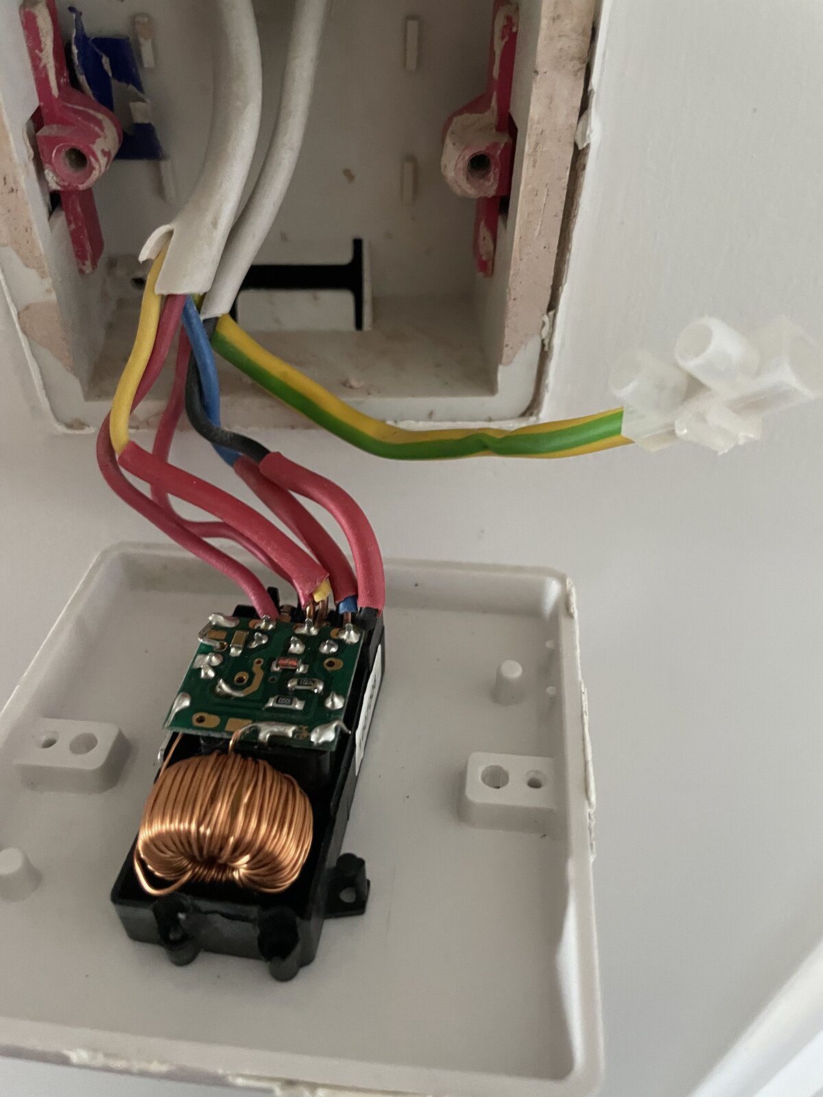

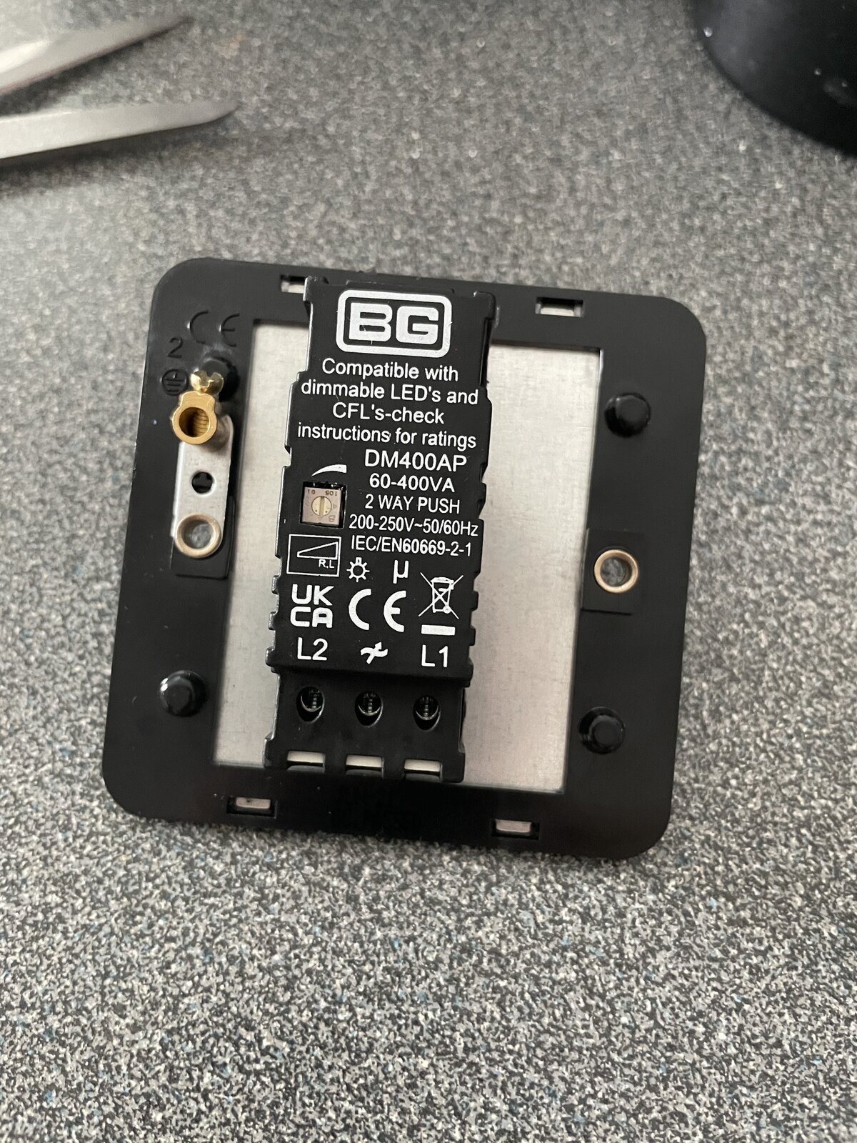

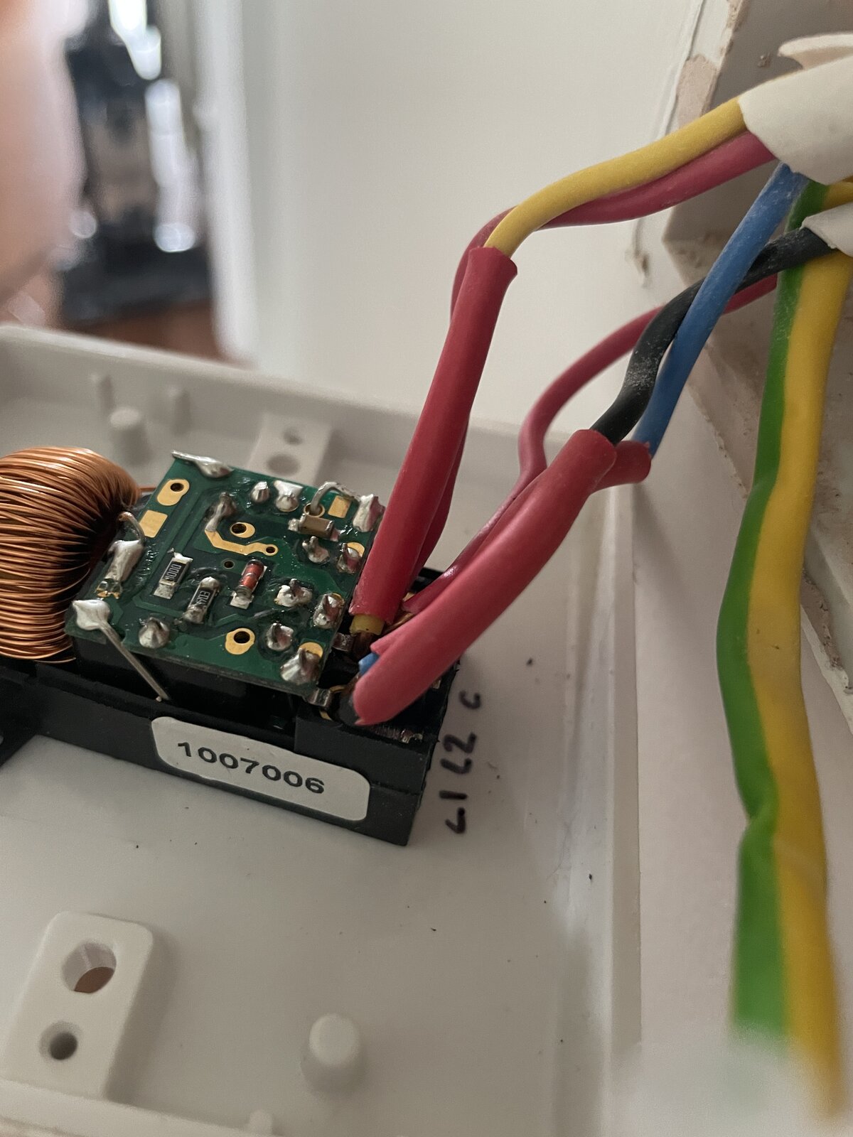

Hi there,
I am looking to replace a dimmer switch that controls 2 lights in my hallway. I just want to check that this all looks correct and I should just copy what is there. Plus adding the yellow/green stripe Earth cable into the gold terminal to the side on the new plate as it is metal.
Many thanks in advance for assistance!

Well spotted, that is rather poor, it says
Compatible with dimmable LED's and CFL's. Check instructions for ratings
which is rather misleading.

Thanks everyone, I emailed the company I bought the modules from and they said
the DM400AP this is also suitable for LED’s, the minimum is 5W of LED. Maximum LED Load: 40 Watts
Well it does say on the back suitable for dimmable leds. Perhaps it’s written in any manual/sheet that comes with the product?
Those BG dimmers do work with some LEDs, you will need to adjust the thing on the back with a small screwdriver to set the brightness when the dimmer is at minimum.
Try it with the LEDs you have got. It may work.
