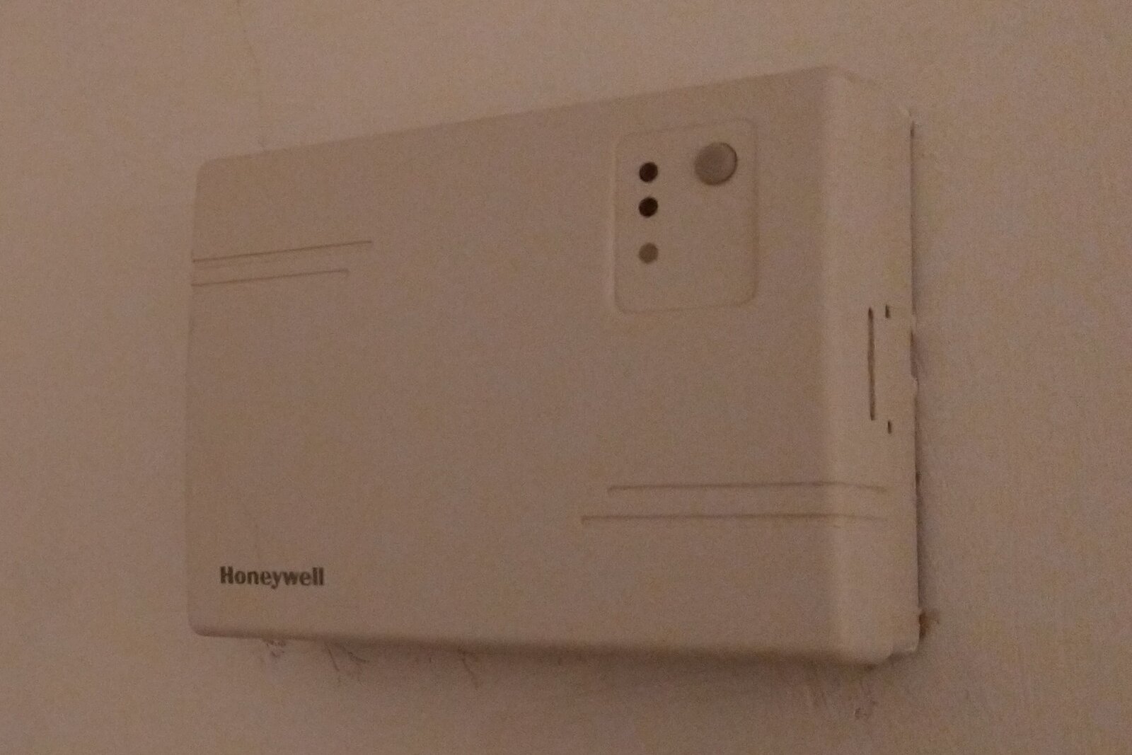

Hi

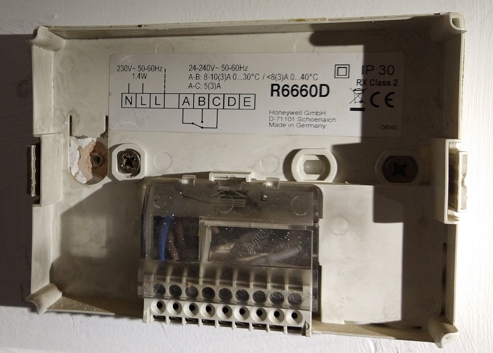

Can anyone help please? I have (what I think is) a Honeywell HC60NG Receiver/Relay unit that has failed. Despite the fact that I have their “top of the range” boiler and CH cover, SSE Home Services are refusing to cover the cost of replacement because, they say, the unit is obsolete and replacing it with the current equivalent would count as an upgrade (which my policy does not cover).

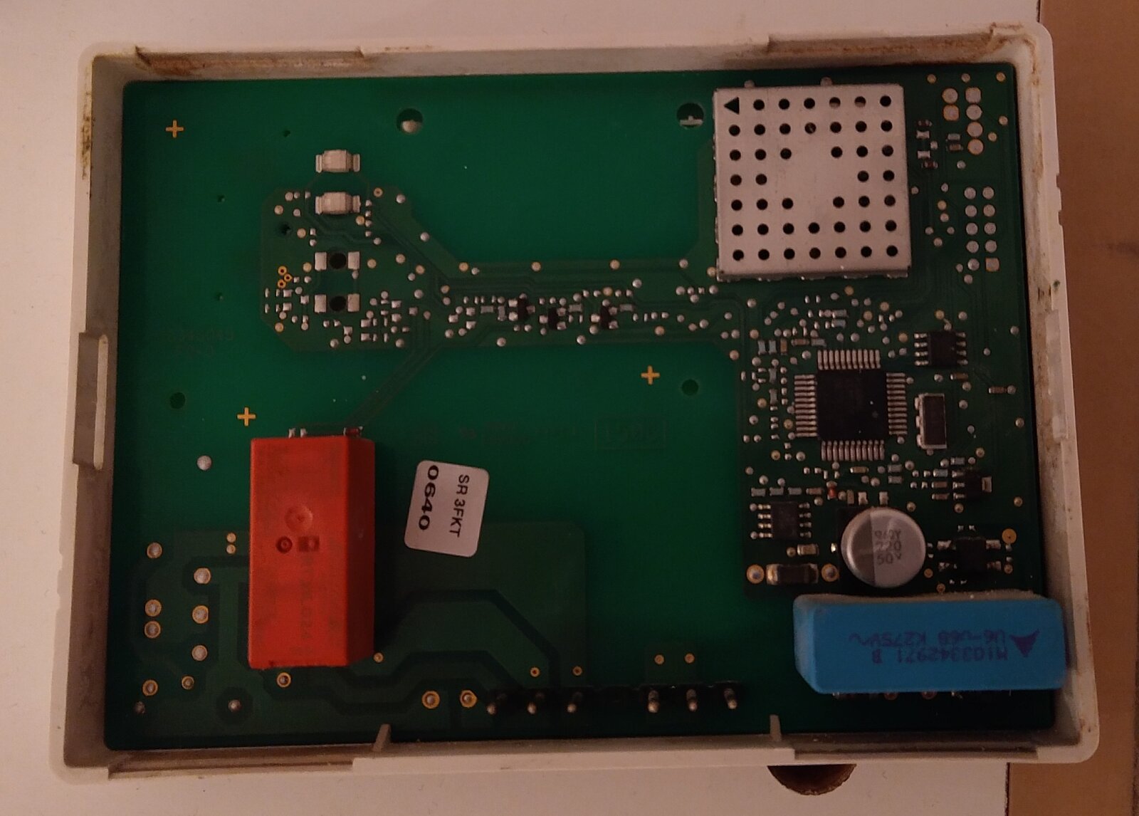

I see that some people are selling Honeywell HC60NG Receiver/Relay units on eBay, etc. and I’m wondering if I could just get one of those. My concern is that, where eBay sellers include a photo of the PCB, it looks different to mine.

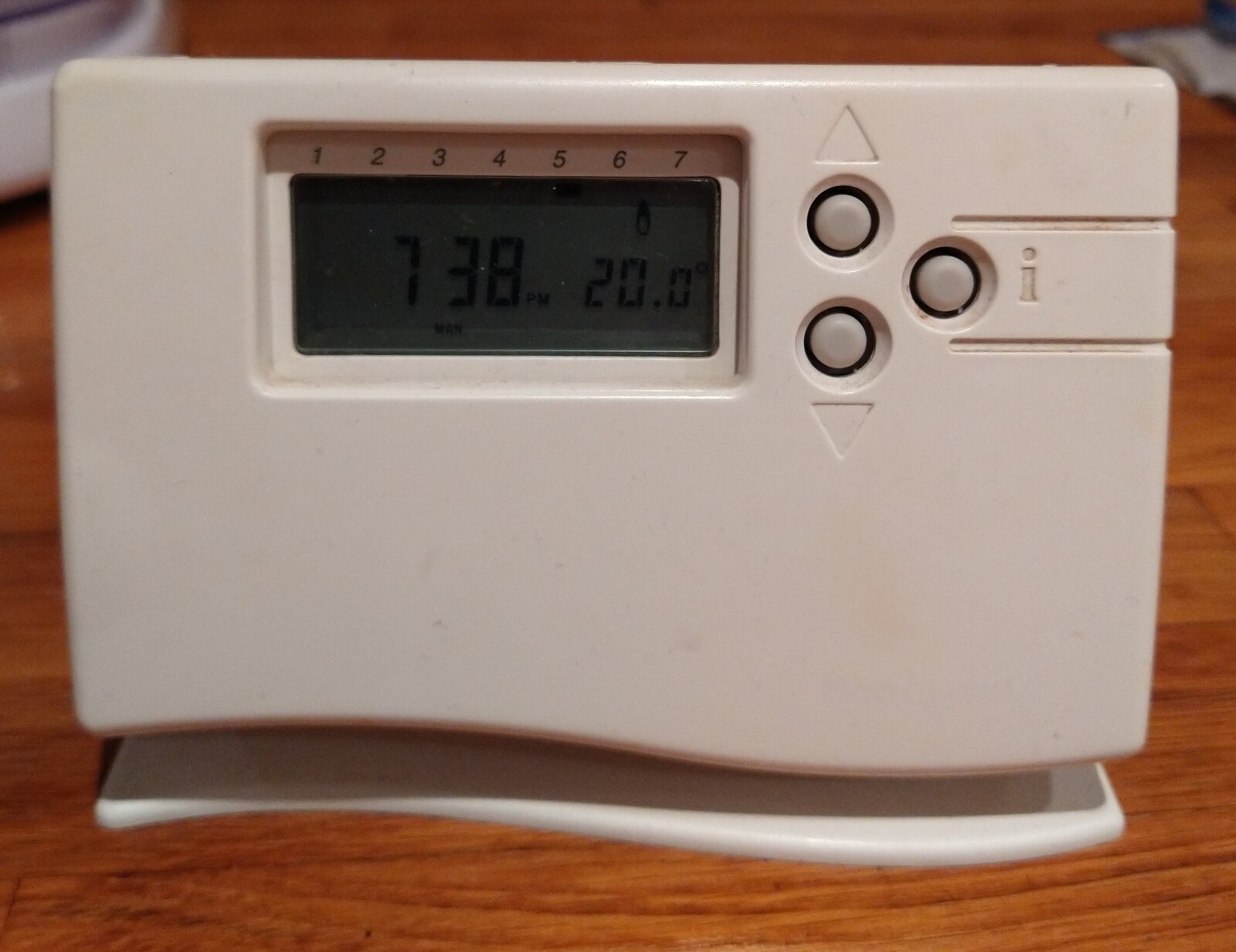

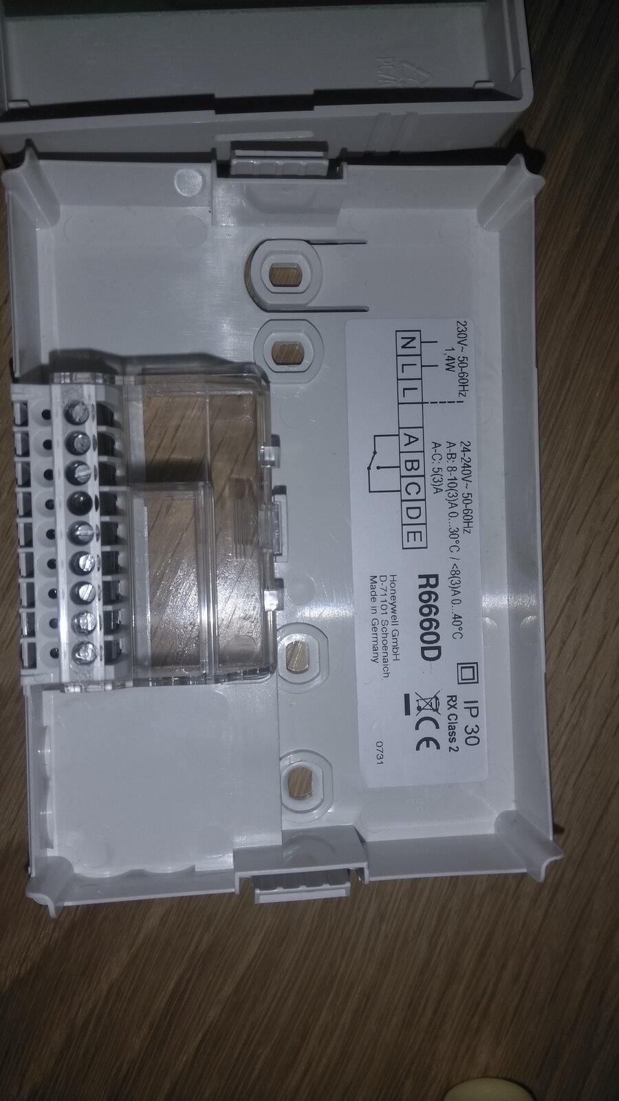

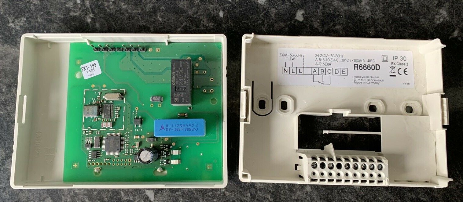

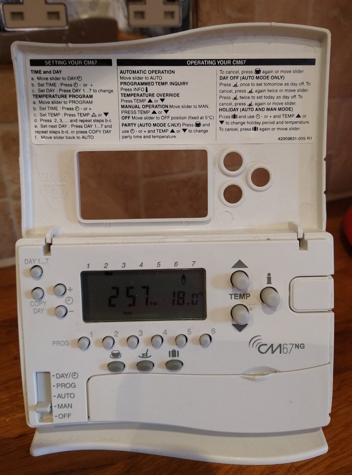

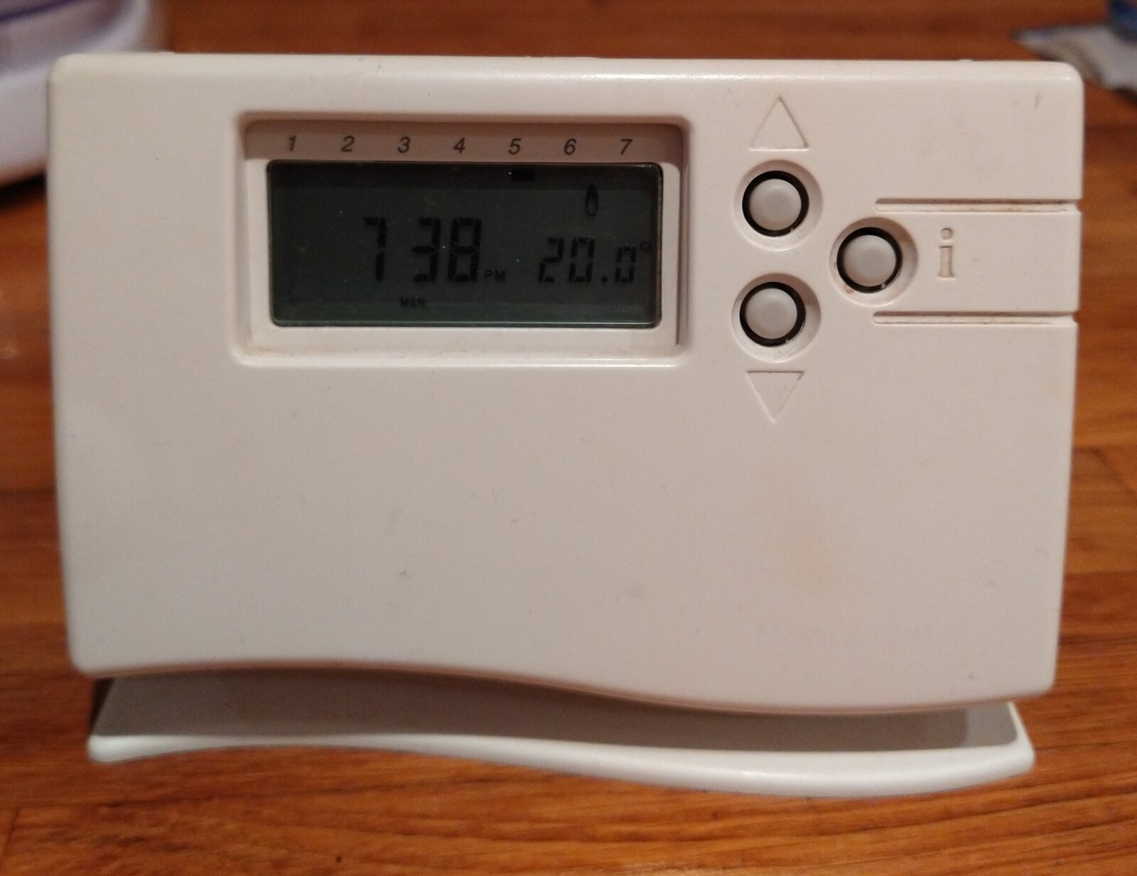

Also, the Receiver/Relay unit needs to work/be compatible with my thermostat/programmer unit (which is a Honeywell CM67NG – See Photos 4 and 5, below).

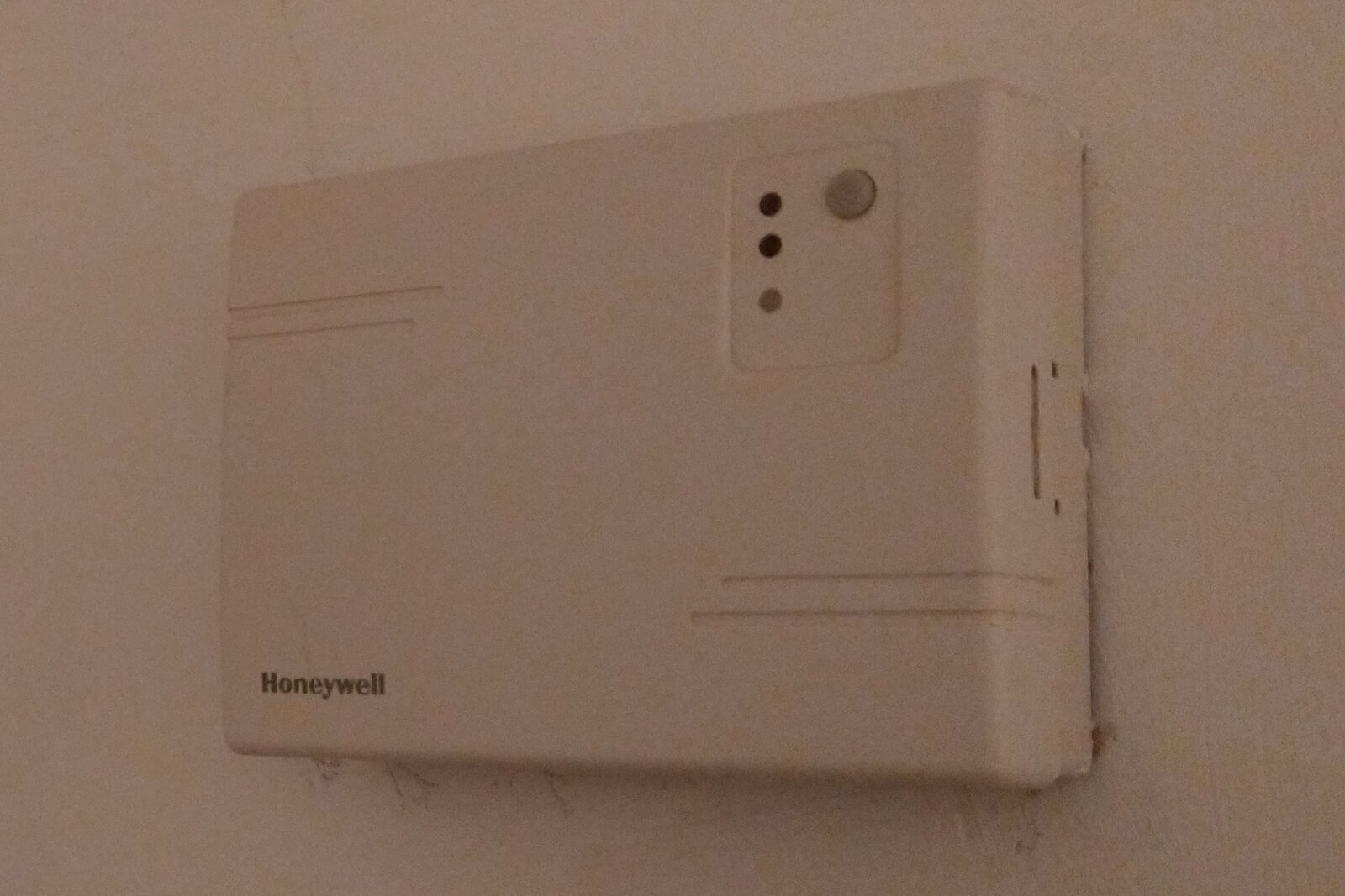

The outer cover is shown in Photo1.

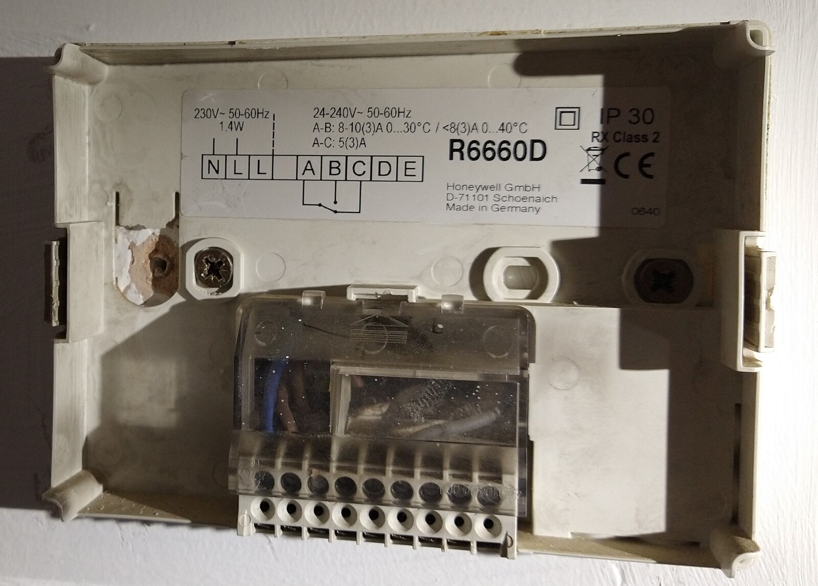

As you can see in Photo2, the inside of the Receiver/Relay unit box on my wall says “R6660D”.

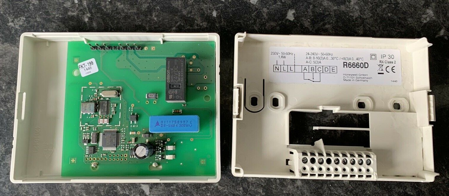

Photo3 shown the PCB from inside my Receiver/Relay unit.

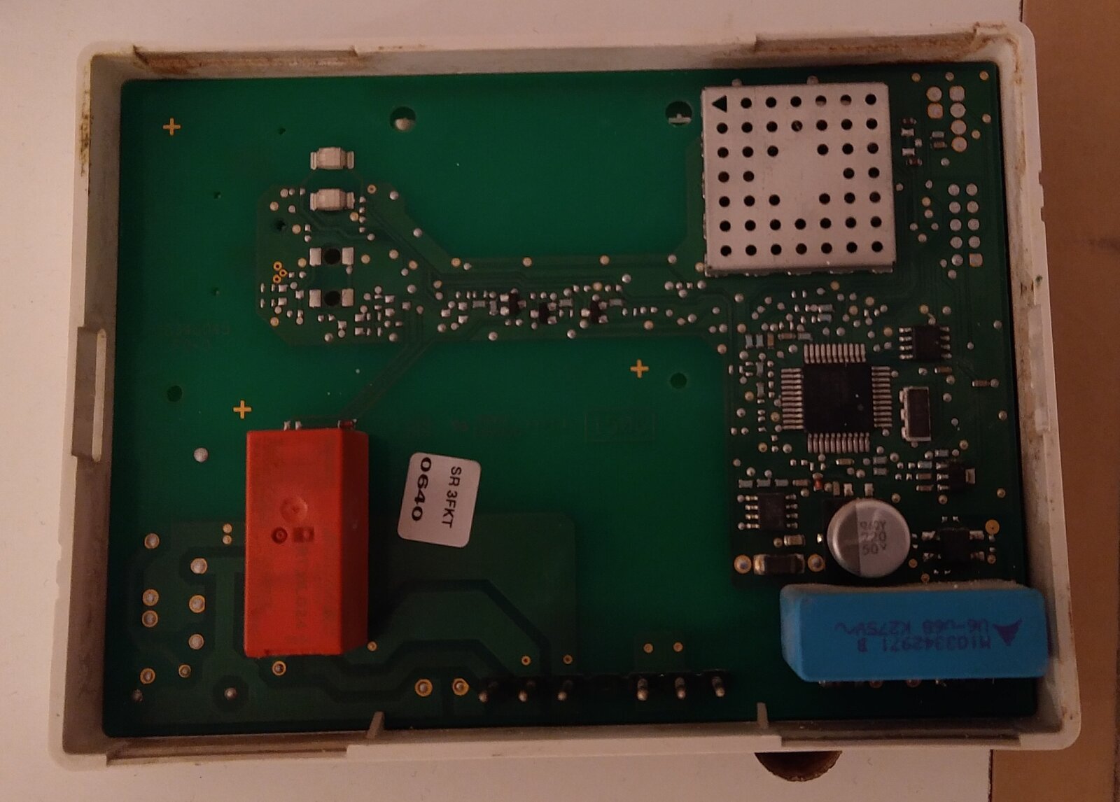

Most of the sellers on eBay don’t include a photo of the PCB but, of the ones that do, almost all show a different PCB to the one in my unit (please see Photo6). This fact, in particular, is why I’m concerned about simply buying one off eBay and plugging it in to the existing socket on the existing box on the wall).

I seem to remember there was a frequancy change so to be safe need to replace both base and thermostat.
You don't show picture of thermostat, could it be a simple flat battery.
Hi ericmark. Thank you for your response. As with other cases I’ve read about with faulty HC60NG units, it does work momentarily and fires up the boiler but won’t stay on (so not just a flat battery, unfortunately).
NB. I have tried re-paring the receiver and thermostat but that made no difference.
The ones on eBay are approx £70, why not just get a whole new wireless room thermostat?

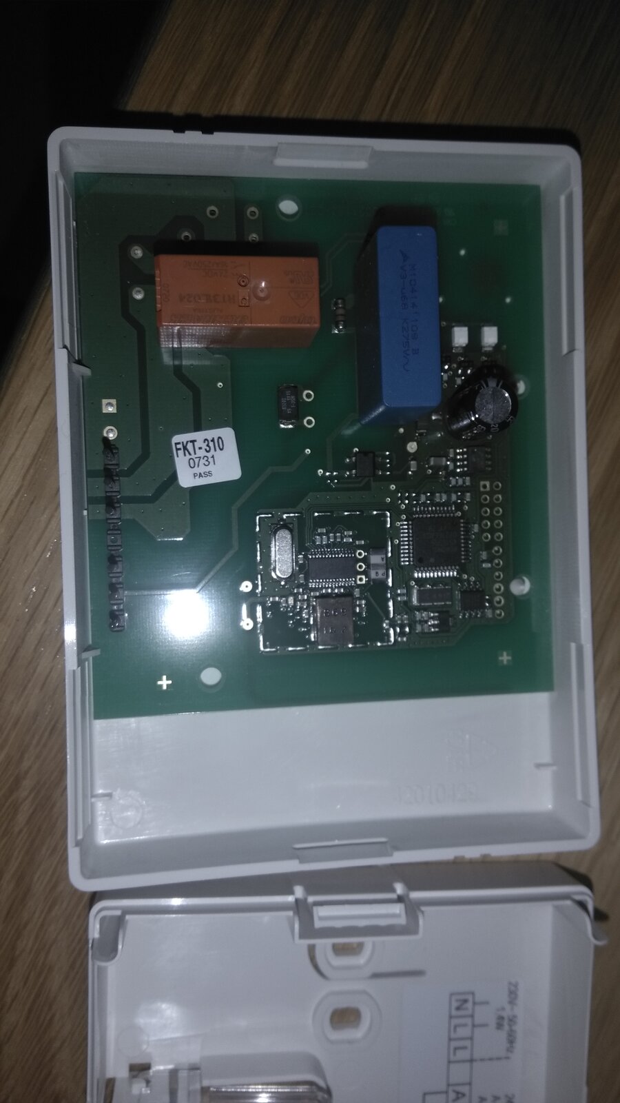

Removed this one last weekend. Working fine. Display had failed in CM927
PM if you are interested. Certainly would not expect £70 for it!
Hi lloyda. Thanks for your response.
The thing is, the unit in your photo has a different circuit board to mine so I don’t know if it will be compatible. Do you know? I rather not have to swap out the back box (redo the wiring, etc.) and just slot the new cover and pcb into place on the existing box (if poss).
If it turns out to be receiver, then you’d have to do it anyway? It’s 2 wires only, so should be easy enough.
The only real difference I can see is the manufacturer of the relay (red on mine). Can you read the part number of the PCB adjacent to e large blue object?
Both units have part numbers of R6660D. I'm pretty certain that Physically my unit will fit your back plate.

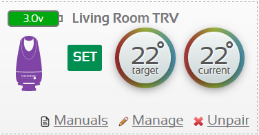

Idea 2) Was an electronic TRV, I selected Energenie with idea latter of adding Nest, and at first it did not work very well, but realised it was the lock shield valves being on supply side instead of return, so radiator heated up too fast, so PC shows target and current,
so I slowly opened or closed the lock shield until they both showed the same on all four fitted, I then started moving one head around to other radiators, and setting the lock shield on that one, once done the old TRV was put back on, and once set each room was spot on, so never bothered getting Nest it worked well enough without.
