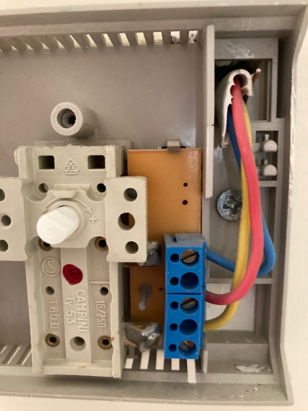

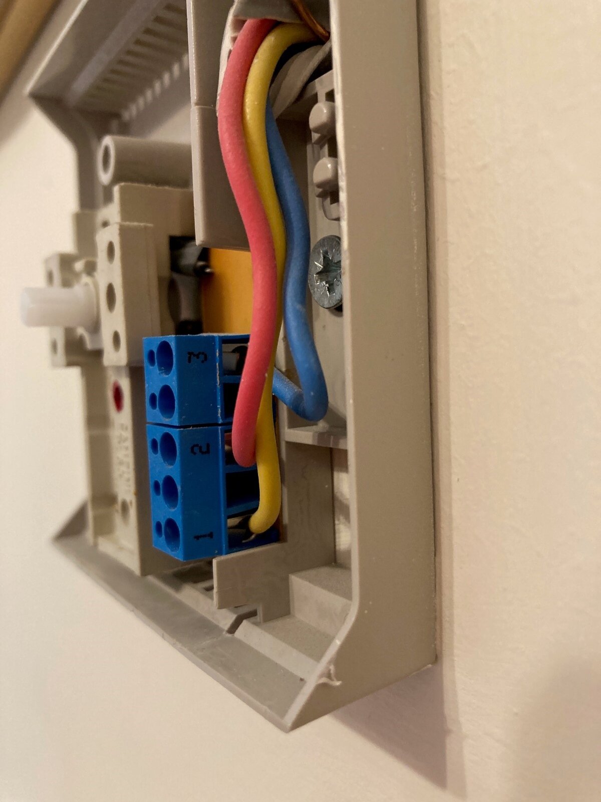

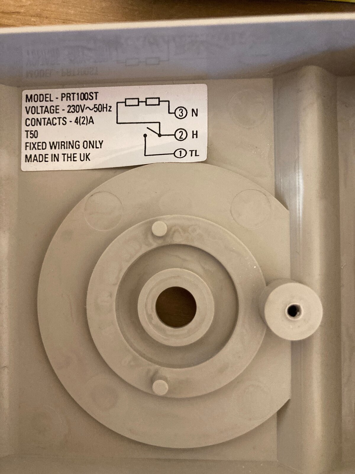

I am looking to replace the existing Potterton PRT100 Thermostat (20years oled/3 wire) with a new Digiatl Thermostat.
What/which would you recommend?
Also, I beleive the new Digiatl types only use 2 wire.
Could you offer info on connecting up?
I attach 3 pictures showing the existing wiring.

Usually the red wire is the 'live' and would be in terminal 1 (TL=Thermostat Live) and the yellow wire the 'switched live' that controls the heating and would be in terminal 2. (H=Heat) So, from your photos, yours wires are transposed. Wired like this, the thermostat will work, but not be as accurate as it should be.
Having said that, it's possible, but probably unlikely, that they are also transposed at the other end of the cable. If so, this is one of the rare instances where two wrongs make a right. :rolleyes: [Apart from the wire colours not conforming to the usual convention]. Someone who is competent with a multimeter would be able to test and confirm this quickly.
If you go for a battery operated thermostat that requires only two wires, these would be the two wires you would need, and with a non mechanical thermostat it doesn't matter which way around they are connected.
If not required, the neutral in terminal 3 is insulated / isolated and positioned safely out of the way.
