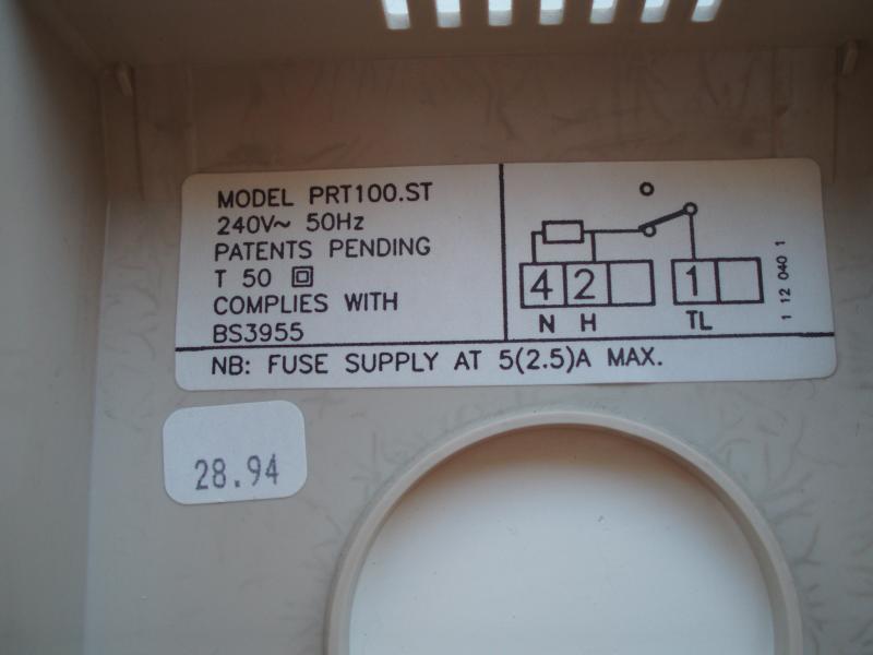

I need some advice on replacing an old Central Heating thermostat with a new digital Honeywell THR840DUK. The Thermostat controls an Oil fired boiler which provides Hot Water & Central Heating.
The old thermostat I'm replacing is a Potterton PRT100 and is wired as follows.
The wires are Red, Yellow & Blue. (The white colouring is actually paint)
Wiring Diagram for Potterton PRT100
Please can some one advise what wires I need to connect to the new thermostat A B C
Many thanks.
Old stat
Blue, Terminal 4 = Neutral
Yellow, Terminal 2 = Heat
Red, Terminal 1 = Live

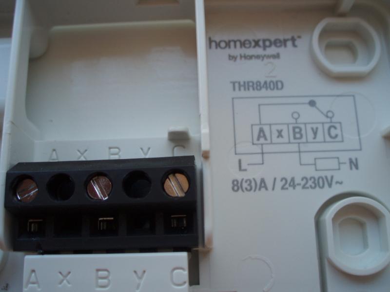

New Stat
Yellow = B
Red = A
As the "Neutral" is not required then isolate the blue wire but do not connect it to A, B or C
