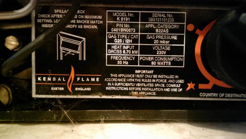

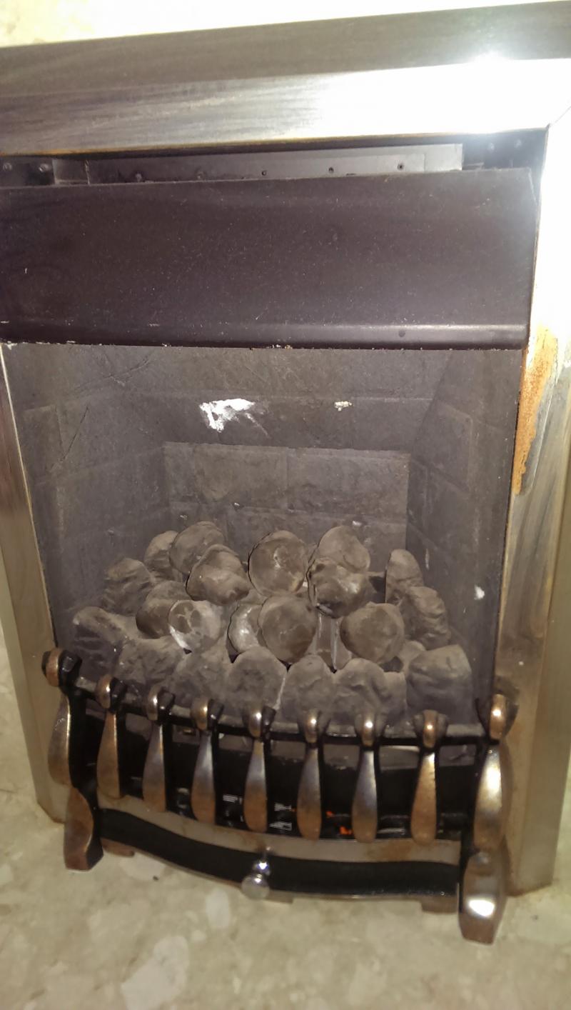

Hi there, looking to replace a powered flue gas fire which has gone all rusty. would really like to keep a gas fire as they look better and are cheap to run compared to electric. The house is 10 years old and has no chimney. I am looking at new flueless gas fire but does anyone else have any suggestions or recommendations?

Have a look at the Valor Dream Balanced flue fire.
Can get rid of the fan and gives decent heat into the room.
Will also work in a power cut which your current fire or electric fire won't do.

Servicing costs ARE an issue, but "most gas fires only give 20-30% of their heat to the room" is another of Agiles nonsense posts. Read the figures, most modern FF fires claim 50 - 50% efficiency, and gas IS cheaper than electricity. Balanced flues are more efficient, but not everyone like the glass front, and they do discolour. The flame effects are generally not as pleasing as a FF fire. Bear in mind that FF fires have a fan noise - obvious but often forgotten. Try to see the fire "live" in a shop to hear the noise - some are worse than others

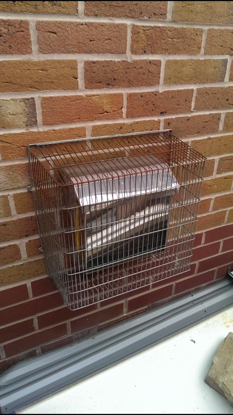

Thanks for the feedback. Would it be possible to go from a powered flue to a balanced flue relatively easily? Hopefully that would mean being able to brick the wall up behind and eliminate a cold spot in the living room. Looking at the efficiency of flue less gas fire's as well they seem pretty good. I know there are a lot of haters due to carbon monoxide, but I already have a detector and will have it serviced every year along with my boiler.
If you have a flueless fire fitted you need a permanent vent in the wall which will be more than a cold spot.
A balanced flue fire will replace a power flue'd one fairly easily.
Ted
