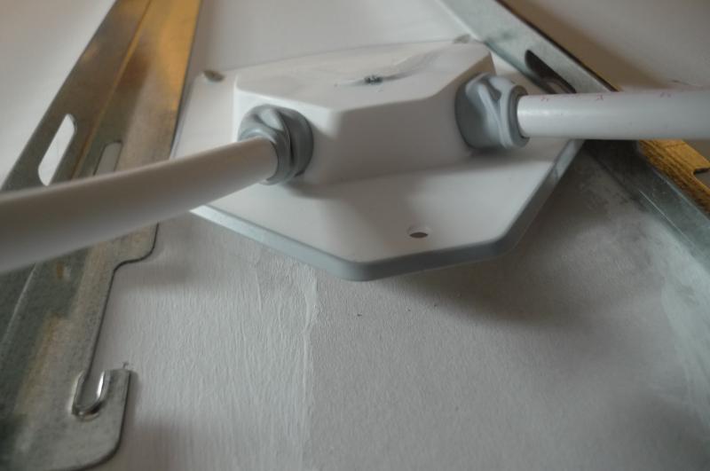

Hi all, we have just moved into a new build house and have a small radiator in the en suite which I'd like to replace with a heated towel rail.
The current radiator is only 400mm wide, and is supplied by flexible plastic pipes, as shown below in the photos:

- Am I limited to fitting a 400mm wide towel rail, or is there generally enough flexibility in the pipes to go to 500mm (as I think these look better and there seems to be more choice)?
- I'd prefer not to have to drain the system. Will the existing radiator valves (one is TRV) simply fit onto the towel rail, or do I need to fit new ones?
- The white box that the pipes emerge from - do people generally leave these on the wall (as it'll be more visible behind a towel rail).
Thanks,
Gareth
You can fit a 500mm wide towel rail. There should be enough slack to move pipes up a little, maybe remove the white cover and move it up to give enough length to reach towel rail connector.
You may need to drain down, to replace radiator with straight radiator valves so TRV will not stick out in front and only stick out at the side.
Daniel.
Given that towel rads are quite often bottom entry, the fact that the trv's are proud of a 400mm wide rad should give you considerable hope in fitting a 500mm towel rad.
Do take into account that towel radiators are designed to dry and warm towels rather than heat rooms, so make sure that the output of your new rad is sufficient to provide the same output as the one you are replacing ;)
A quick look in my screwfix catalogue suggests that both a 400x600 single panel radiator and a 500x1200 toweal rail will have an output of about 350-400 W, so that should be OK.
You might be able to do it without draining down, but it would be a great idea to first make sure you know how and where to drain, just in case it becomes necessary to do so in a hurry!

ok, so the towel rail was delivered today.
I do need to replace the standard angled valves with straight ones, so will have to drain the upstairs CH system :( Got the Loctite (thanks Dextraneous!)
3 questions -
1. The plastic pipes are 10mm, am I right in thinking I need a 10mm straight valve? Wickes only seemed to have 15mm or 8mm earlier.
2. How do I remove the existing angled valves? They look like push fit.
3. The existing rad has a TRV fitted - should this be fitted to the towel rail, or manual valves used instead?
Ta,
Gareth
All done.
Ended up leaving the elbows on the pipes, and fitting straight 15mm valves with TRV.
Am intending to tidy up the pipes at a later date. I'll have to chase the wall and bring each pipe out directly behind the valve, so I'd be able to fit chrome covers on them. Whilst I'm at it I'll turn the valves inwards, would look better I reckon.
But at least it works, no leaks! Yet.
Cheers for all the help
