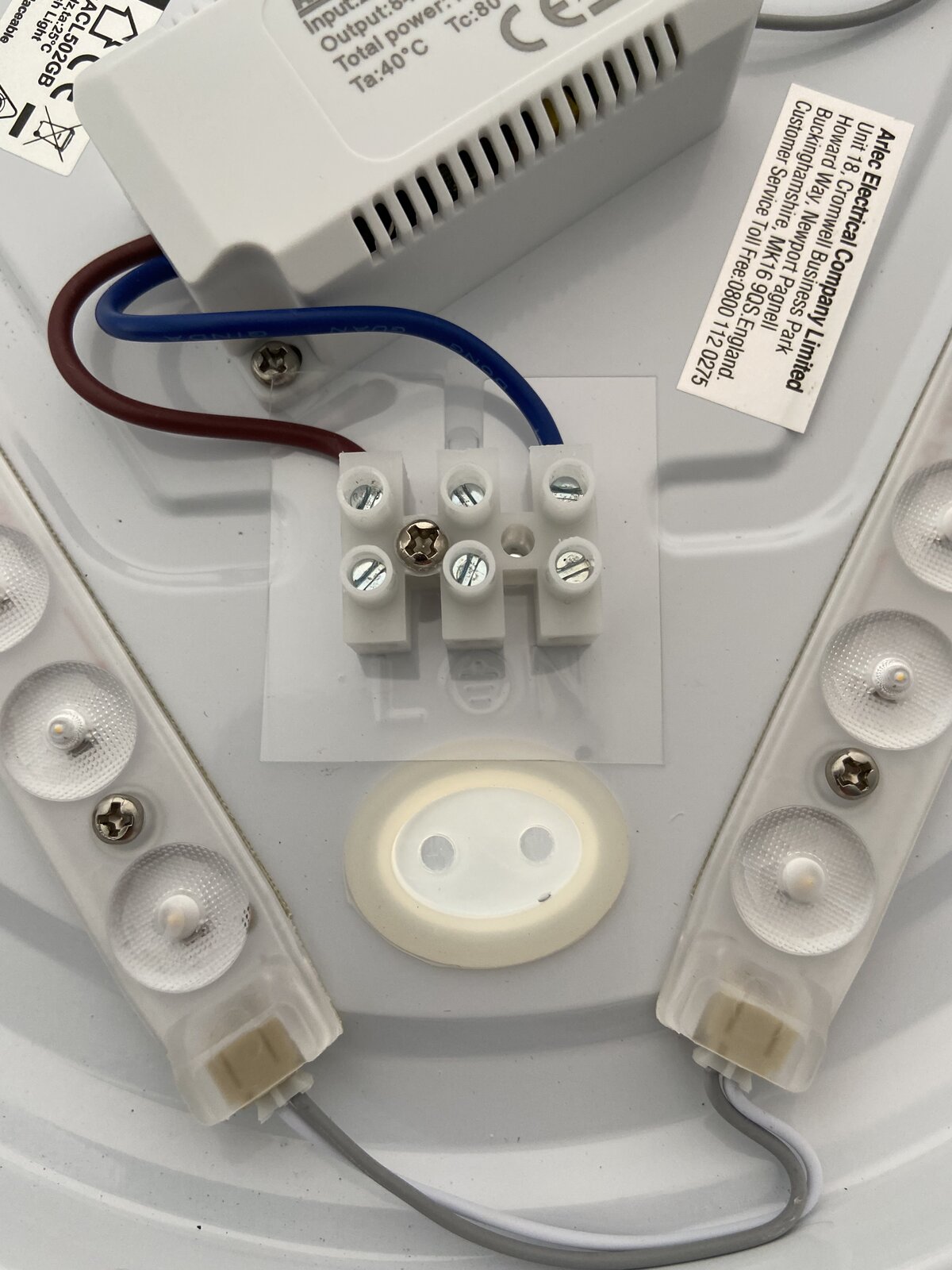

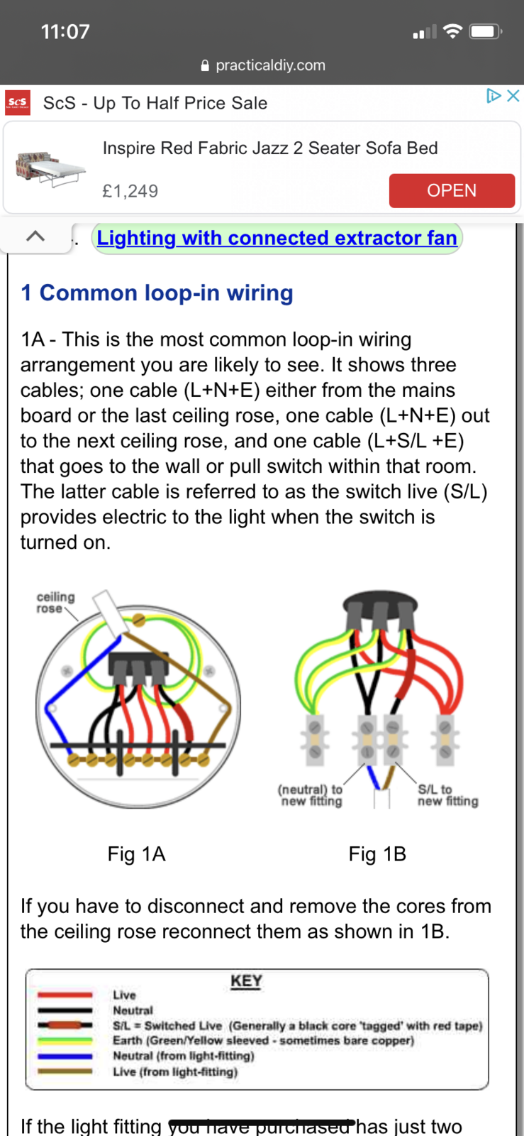

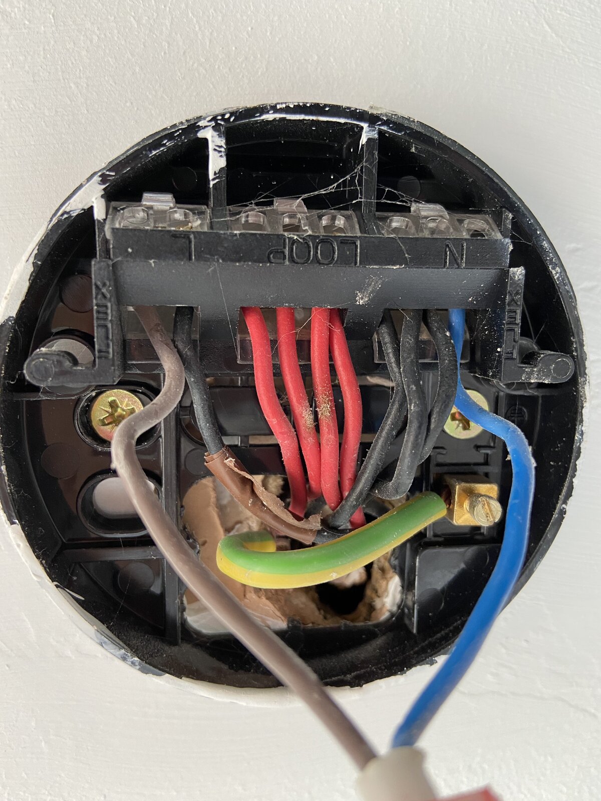

I’m replacing this ceiling rose with a flush mounted light fitting, I’m assuming that I need to terminate all the loops in a connector then just connect the 3 neutrals, switched live and earth to the new fitting as per the diagram?
