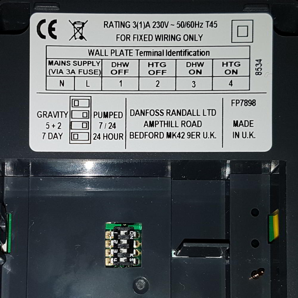

I have an unused Danfoss FP715 programmer and am wondering id I can use it to replace my pre-1998 Danfoss FP975 programmer?

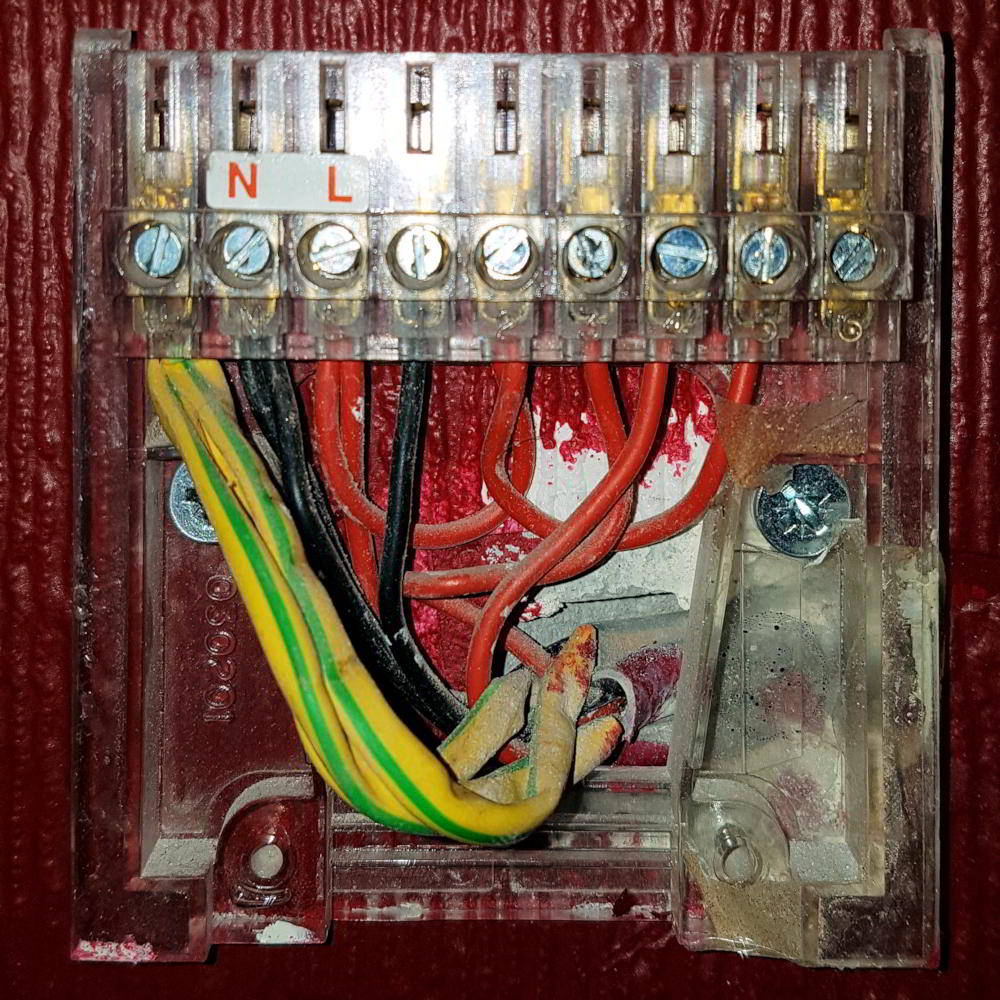

The terminal identification wall plate for my current programmer (Danfoss FP975) has 6 connections in addition to L/N/E and appear to be:
#1 Neutral (Black) - Direct Connection From?
#2 Linked From Live (Red)
#3 Live (Red) - Direct Connection From ?
#4 Live (Red) - Direct Connection From ?
#5 Linked From 2 (Red)
#6 Unused

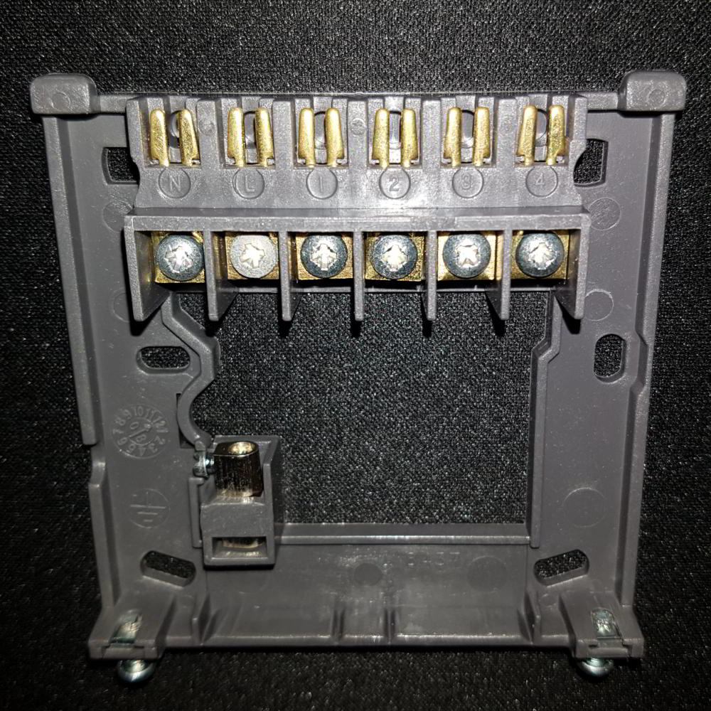

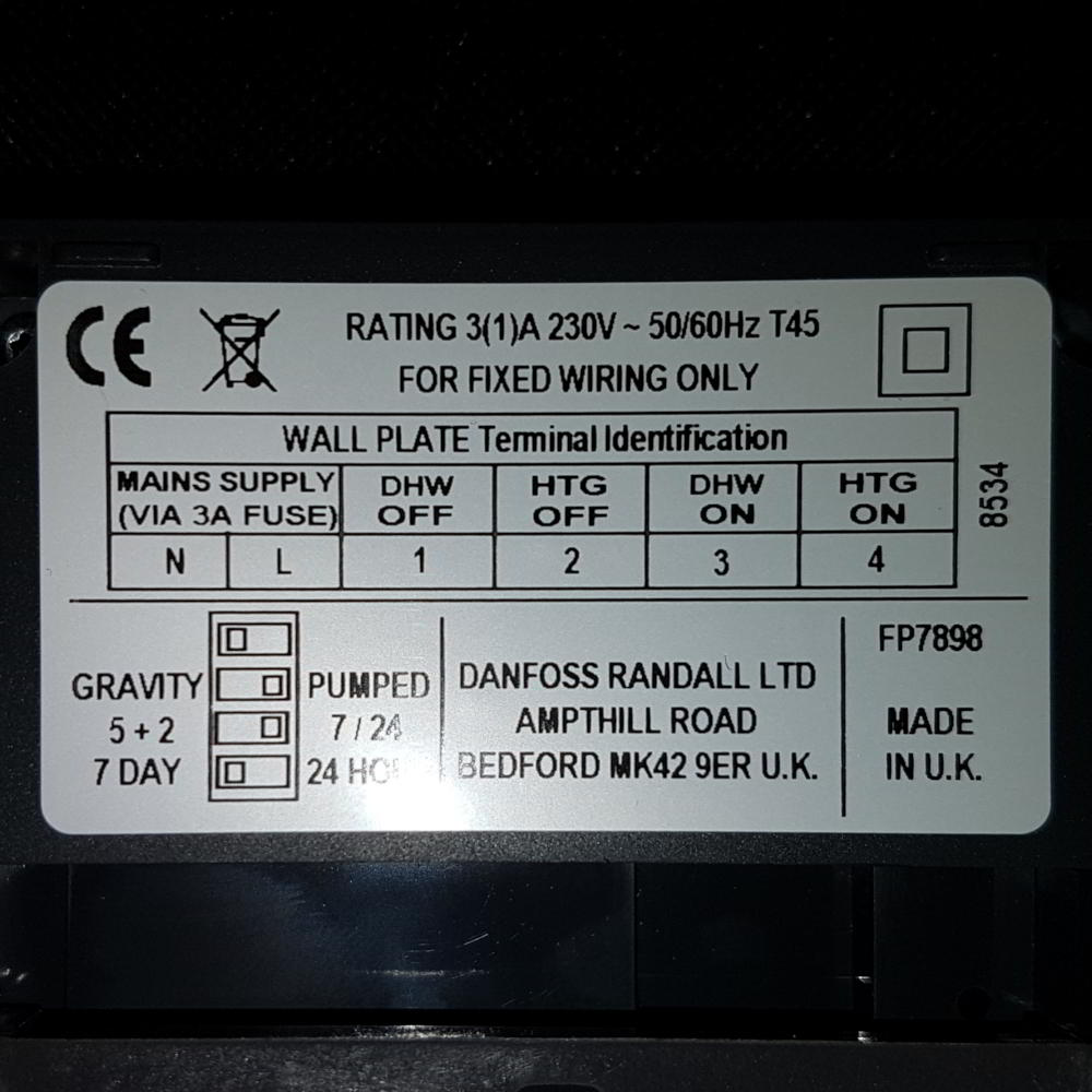

The terminal identification wall plate for the Danfoss FP715 only has 4 connections in addition to L/N/E
Also, the dip switch layout is a little different between the two progammers, but I think I've got them correct.
Could someone be so kind as to let me know if I've messed up her?
Got a funny feeling the Danfoss FP715 is incompatible for my current CH system, but worth asking
Ta.
