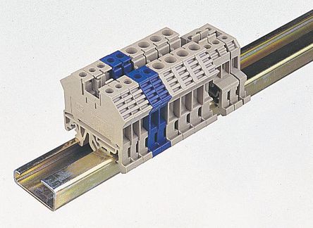

What about things like these:

Is this an excuse for not answering the rest of the question or do you simply not know. I have looked for the information in various books e.g. Whitfield; electricians guide to 16th ed., on-site guide, Brian Scaddam; Electric wiring: Domestic etc but cannot find any information on this particular issue. Maybe this cavity wall business is actually to do with building regs?
Anyway with regards to having additional junction box what's the problem?
a) I can't see that its any different to joining cables with a socket or ceiling rose. In fact if anything since your not having to push cables back into the pattress they're probably less likely to come loose.
b) Housed in a small cabinet the boxes/ chockblock or BAS suggestion would be 1) accessible for testing 2) Free from damage from mechanical impacts.
