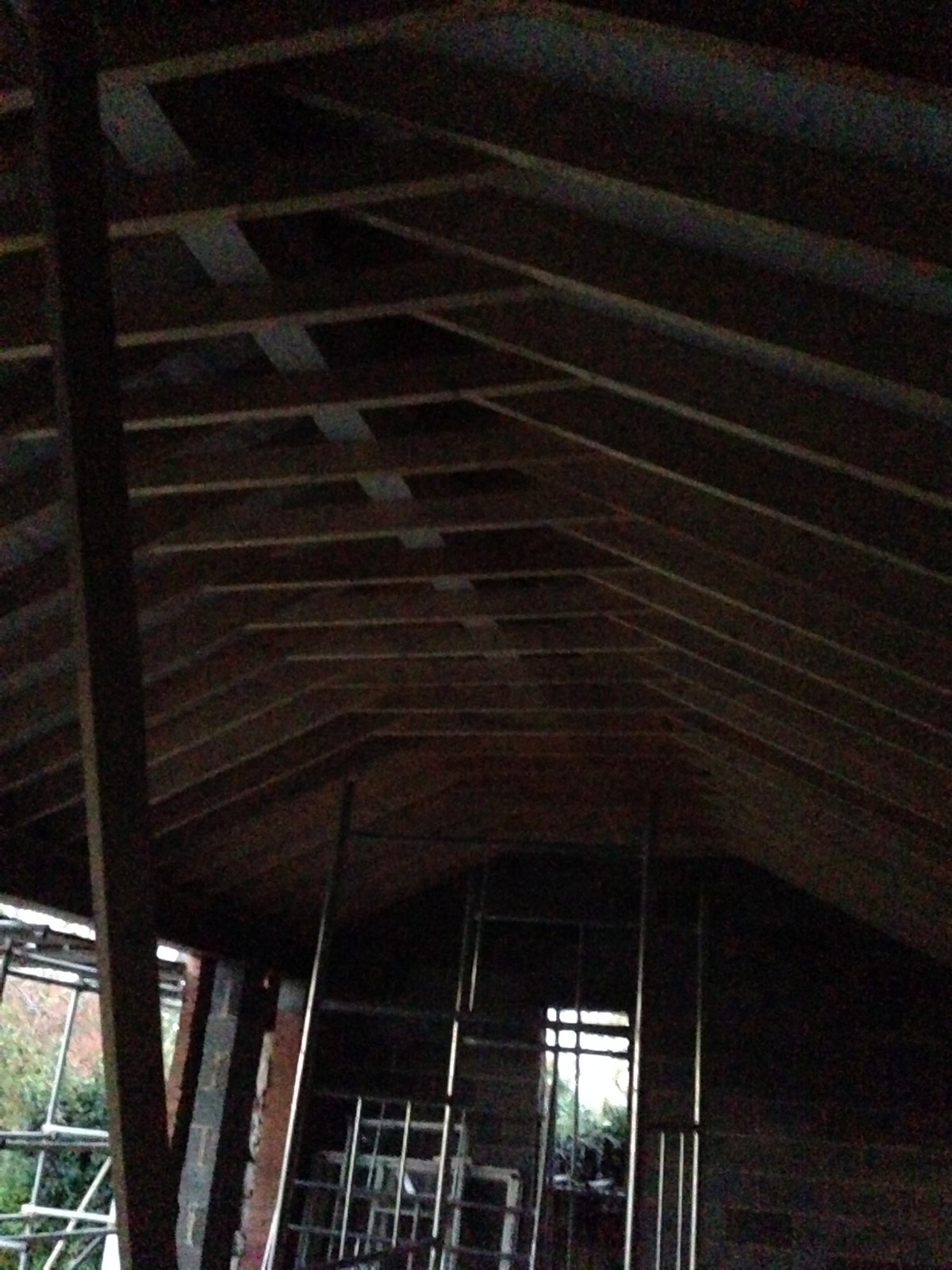

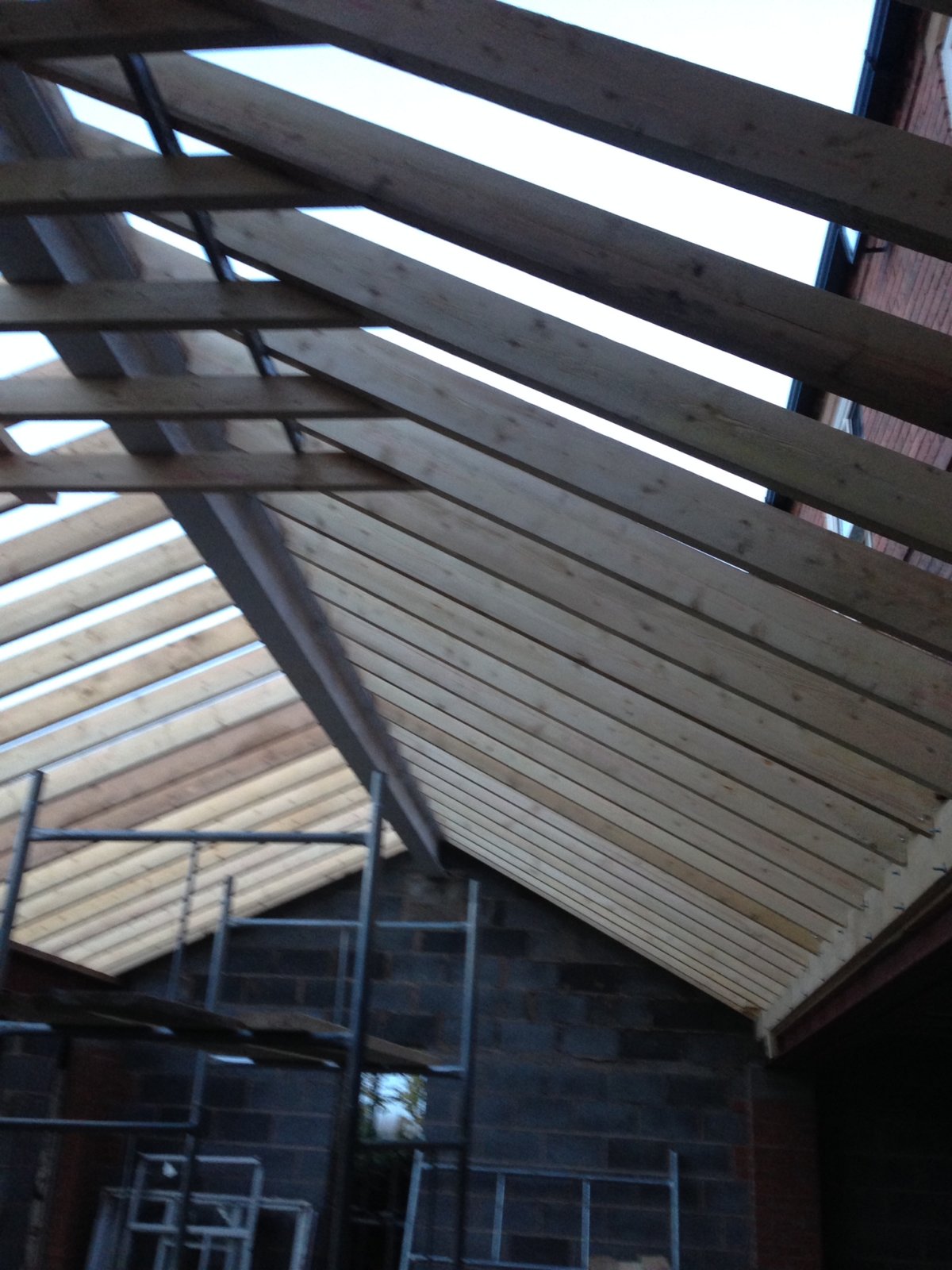

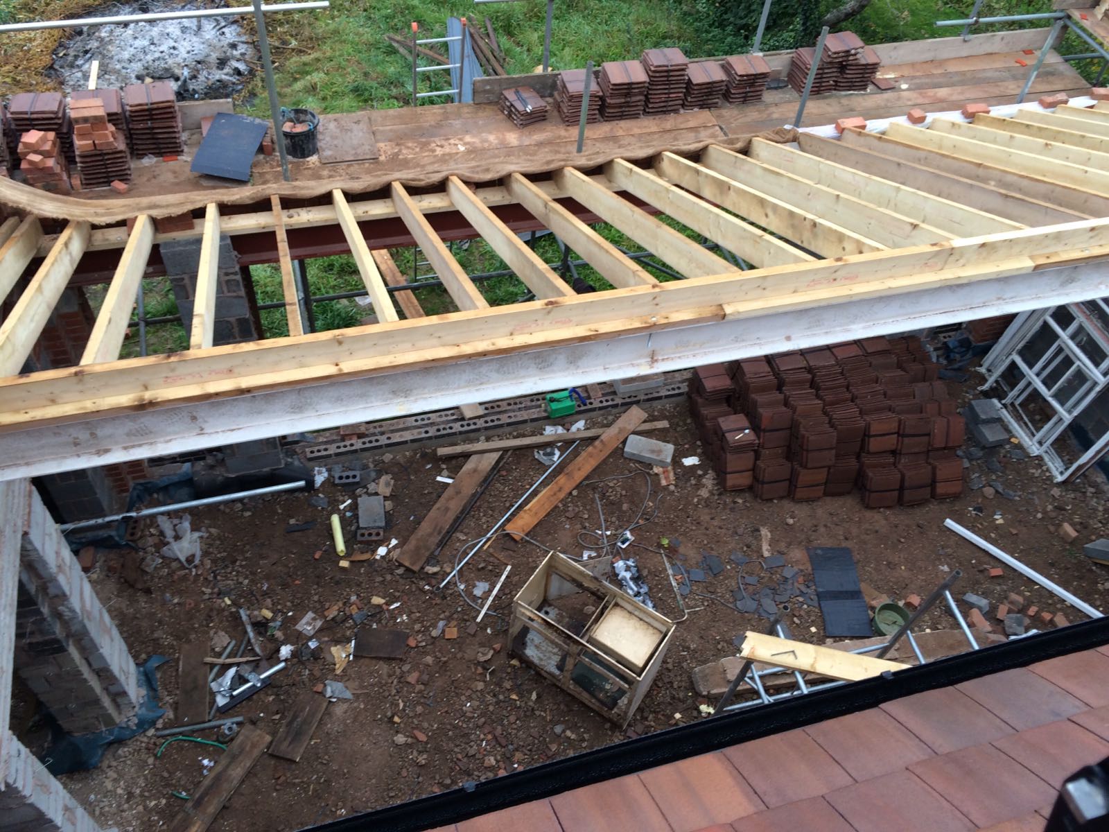

I had a single storey extension built 2 years ago. Full width of back of house 9m wide x 5m out. There’s a huge steel supporting the 1st floor of the house on pillars, a ridge steel on pillars & then another steel on the external wall above the bifolds. it’s a dual pitch cut roof with rafters. 27 degrees. No velux windows.
My problems with it are:
1. The pitch is too steep, so steep that I cannot see out of the bedroom windows. It’s about half way up the windows.
2. I thought it would be a cathedral style going up to a triangular point internally ( instead it pitches up is then flat for approx 1m & then slopes back down towards the giant steel)
At the time we were doing a million other things on the house & work 24/7 & really really didn’t communicate well with our builder & give this the thought I should have. It’s bugged me ever since & I haven’t got ‘used to it’. I’ve majorly messed up & clearly did not understand in the slightest what the final result would be. Hence why I am here for advice.
So my questions are:
where do I go from here? Would you have the roof replaced? If so, what are my options? Ideally I don’t want a flat roof/roof lantern as it has the sun on the back all day.
I would still like the cathedral vault style, possibly even with some exposed timber internally if feasible (its a period house so would tie in). Is this even possible if I reduce the pitch?
I’m happy with the brick work, lead work, valley & glass doors. Obviously I’ve majorly messed up. When it was all being built it didn’t look ‘that bad’. Once it was tiled & plastered i hated it. But had ran out of money & it wasn’t the builders fault.

The reason you have a flat section at the moment is because the roof has been pitched above the steel, with effectively a timber ridge sitting on the steel.
Additionally, the collars are fitted below the steel making the flat part lower and thus bigger.
The detailing is sensible as it makes the steel internal to the insulation so stopping thermal bridging.
The steel couldve been set at ridge height with timber plates bolted into the web for the rafters to be screwed to. Doing that would mean there would need to be insulation over the rafters to prevent cold bridging.
I cant see how with a pitched tiled roof you are going to make much difference to your bedroom window view. Unfortunately the vaulted ceiling look you want in the extension is what is causing the roof to obscure your view!
The only option is a flat roof with a tiled perimeter. Or a flat roof with a fascia around.
