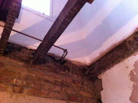

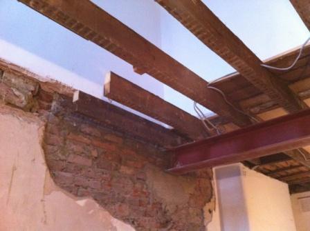

I had a chimney removed and the shorter joists to the chimeny on the left hand side of the room were not supporting anything so I have removed them, the cavity is left in the wall. I thought I should leave the joists overhanging on the right as they are supported on the steel beam and run into another room.
Could I have some advice on completing the joists. Should I make a cavity to the side of the existing ones, joist hangers and run into the steel beam. I could then bolt the two existing ones to this for addittional strength? I'm not too sure, none of the old beams have DPM or joist hangers due to its age. Are tehre regulations that you have to adhere to when repairing/adding new beams.

I'd just replace the new joists so that they sit next to the others and go into the wall at the other end.
You could bolt them together, if you wish but not necessary, as long as they're sitting on the steel beam.
The strutting will prevent twisting/movement, which should be replaced, including between the wall and the joist. You don't need to use herring bone strutting. You can use solid timber. I think it must be ²/³ the depth of the joist, minimum.
Any regs would apply to complete floor replacement, eg. size of joists.
Any dpc requirements would apply to ground floor installations rathre than first floor replacements.
To provide sufficient floor board support, if you were intending to place the new joists in front of the existing, looking at your first picture, nail a piece of 50mm X 50mm or similar along the top side of the joist that goes closest to the wall, before installation. You won't have any reasonable access to fix anything once it's installed.

The span is 4.1m. The centres of the joists are 380mm
Anyone got their timber tables handy?
I'll look for my mine in about an hours time.
According to the timber tables you need 170mm X 63mm, (at 400mm centres), so, as there's only two joists to be replaced and they're at 380mm centres, I'd settle for 165mm X 65mm. Or 165 X 63.
BTW, Strutting/blocking should be not less than ¾ the depth of the joists.
One at mid-span is sufficient.
Thanks. I’ve ordered 75mm x 200mm C16 treated timber and the timber merchants are cutting it to 165mm (so the thickness of the timber is slightly oversized – the timber could only be purchased in 50mm or 75mm and it would be unnecessary to cut down the thickness as it is offering more strength).
