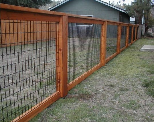

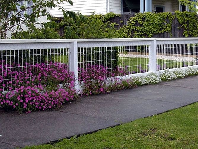

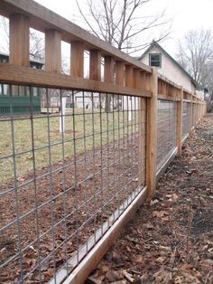

Heavy duty mesh? Like the stuff farmers use to control sheep? Or the type that schools use to control kids? :)
The life of a post depends more on what wood you would use, how you place it in the ground, and what you treat it with. You'll always hear scare stories of rotten posts, because corners were cut and rushed.
Do it correctly and it's something the average DIYers can complete within days.

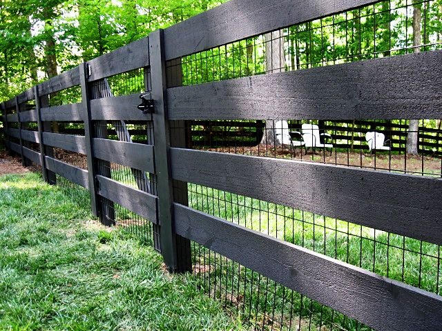

Haha, the stuff to control kids! I've seen some used on post and rail down the road from us and it looked smart. Coated in green plastic stuff. The last picture you posted is a long the lines of what I was thinking. Hubby is handy but just never done post and rail so not sure where to start.
Haha, I should have double checked what I typed before I pressed 'post' haha.
The black fencing?
Four things... 4x4" posts, welded wire, 1x4" for vertical mesh fixing, and 1x4" for horizontal fencing.
Five depending on whether you wanna use spikes to hold the posts, or concrete footings.
Additional items, would include wood preserver/timber treatment, screws or nails to fix the mesh onto the posts using the vertical 1x4"
This guy uses a machine to place his spikes, but with some patience and a string set of arms, a sledgehammer does a good job, with one person keeping an eye on the level.
Post and rail is used on farms because a tractor with post rammer can put up 100's of metres in a day, which when your a farmer with 1000s of metres of boundaries makes sense.
Its a cheap method for the above reason but the only reason it rots is because the posts are just rammed into earth. There is no reason why you cant build a post and rail type fence but set the posts properly in concrete and this will give a much longer lasting result.
