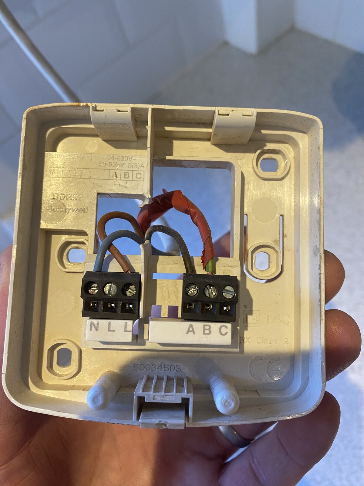

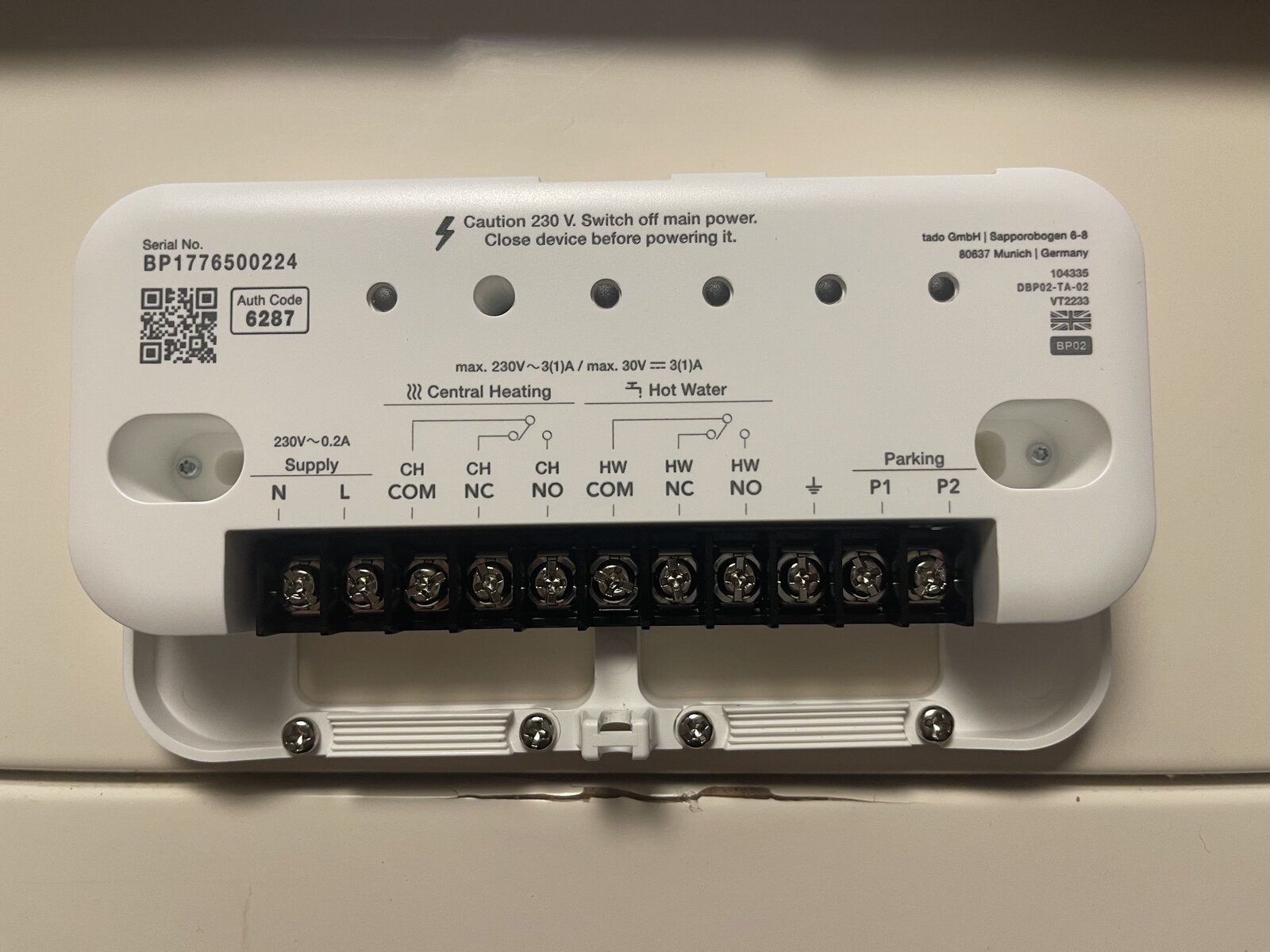

Hi all.
I have seen this question has been asked before but the current wiring in my BDR91 is slightly different. In other posts I have seen, none have an earth to the ‘B’.
I am hoping it’s a case of swapping over the wires.
I assume it should be wired as below.
BDR91 – 1x Blue Wire in N
TADO – Supply N
BDR91 - 1x Brown Wire in L
TADO – Supply L
BDR91 - 1 x black Wire in A
TADO - Central Heating (CH) - COM (1)
BDR91 - 1 x Earth Wire in B
TADO - Central Heating (CH) - NO (4)
