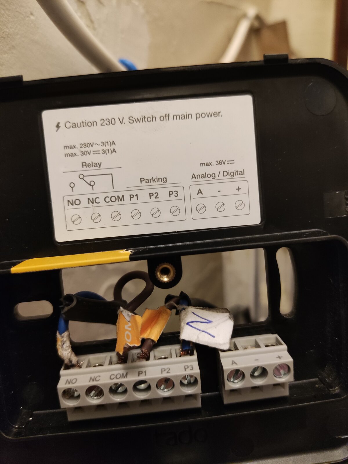

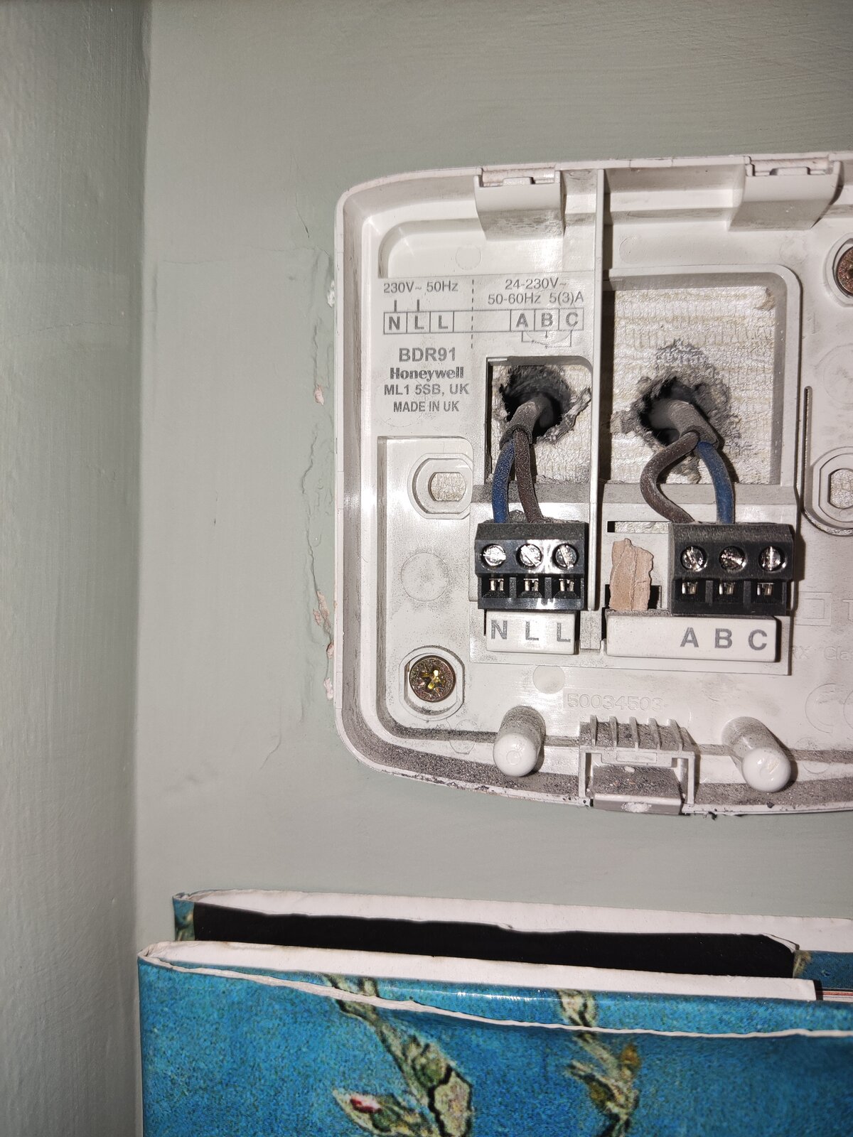

Hi folks, have been a stalker of the forum for a while during my DIY journey, but I stumbled upon an issue which I couldn't find suitable answers for in my specific case
I have a BDR91 receiver and I want to swap for a Tado V3+ wired system. Problem is that I'm unsure which wires go where. In the previous threads that I've seen, the wiring was all different unfortunately.
Boiler is Ideal Vogue C32.
My thinking is as follows about A and B, but not sure about the N and L
BDR91 A - Tado COM
BDR91 B - Tado NO
Really appreciate the help! Pictures of both are attached.
The Tado wired unit is battery operated. It doesn't require a connection to N, or L.
You can safely park them in the parking terminals - Say, L in P1 and N in P3.
The blue wire in your BDR91 terminal B, should be oversleeved in brown to denote it as a switched live.
When wiring up, isolate the power, and don't mix up the cables!

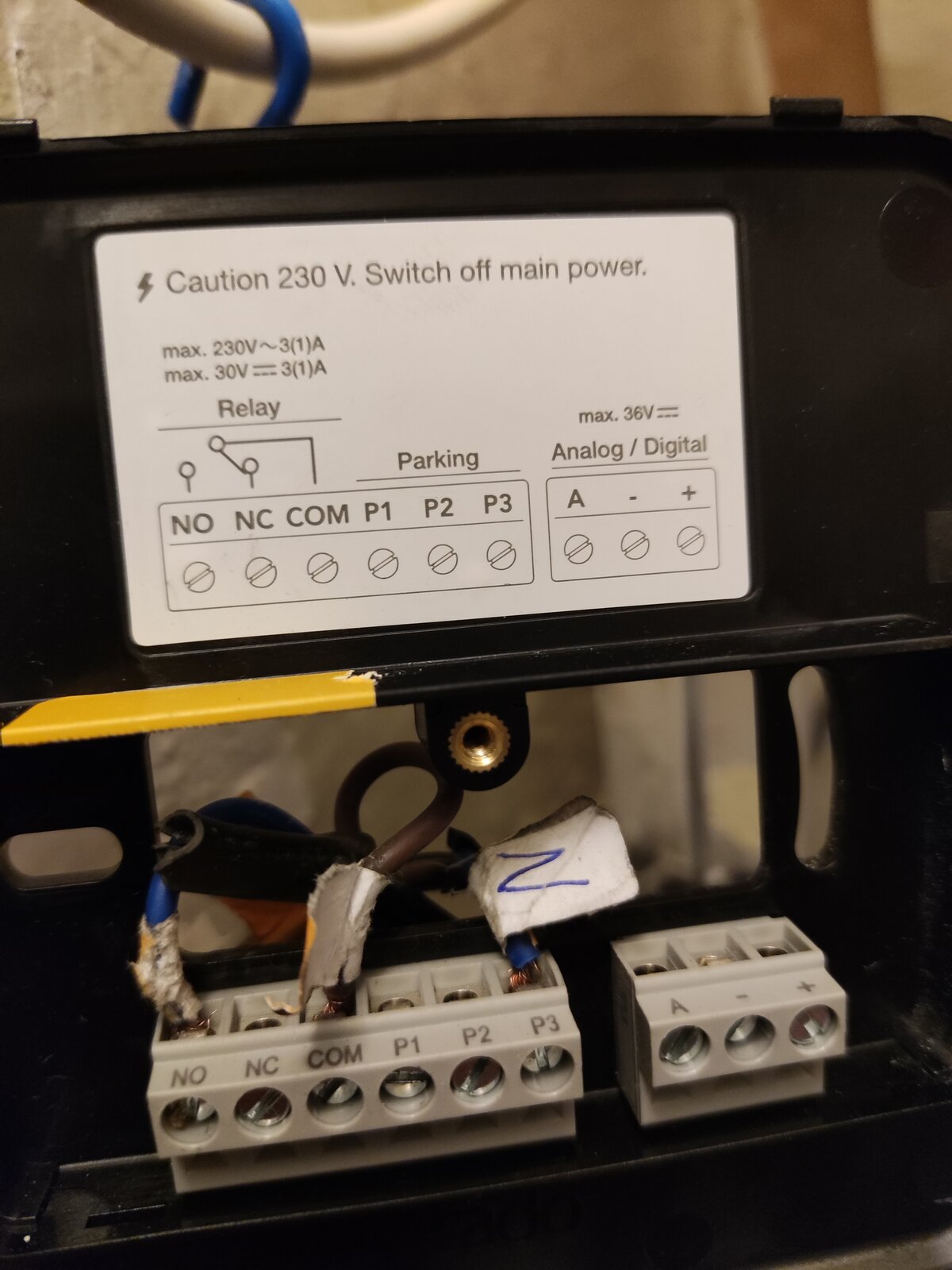

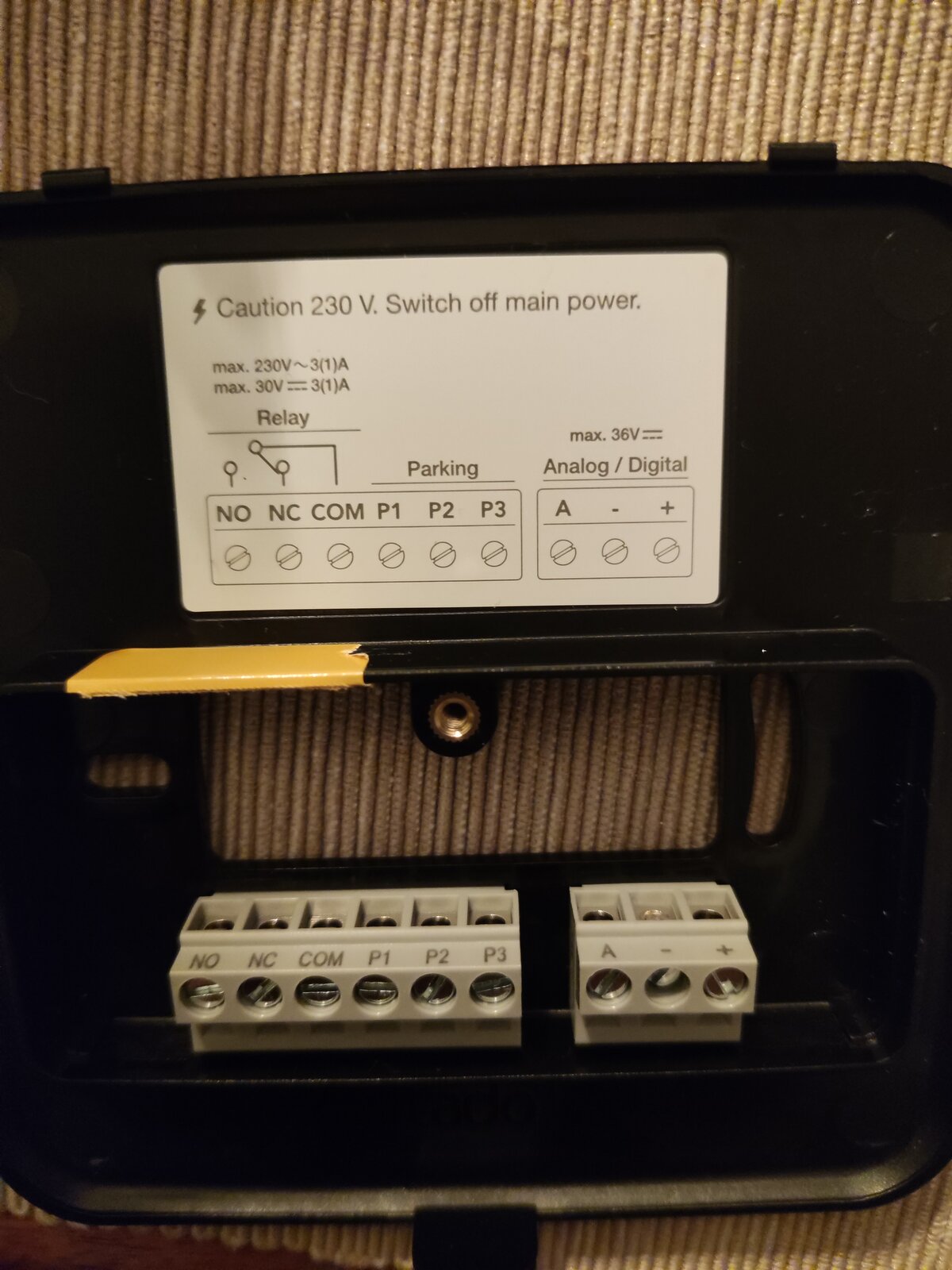

Reporting back progress, connected as above, however, the bloody relay doesn't seem to be working - Despite having the tado thermostat in the off position, the Ideal boiler is not turning off :/ it's constantly in the on position - I checked the connections and it's all looking fine
any ideas what might have gone wrong?
And thanks again for the help

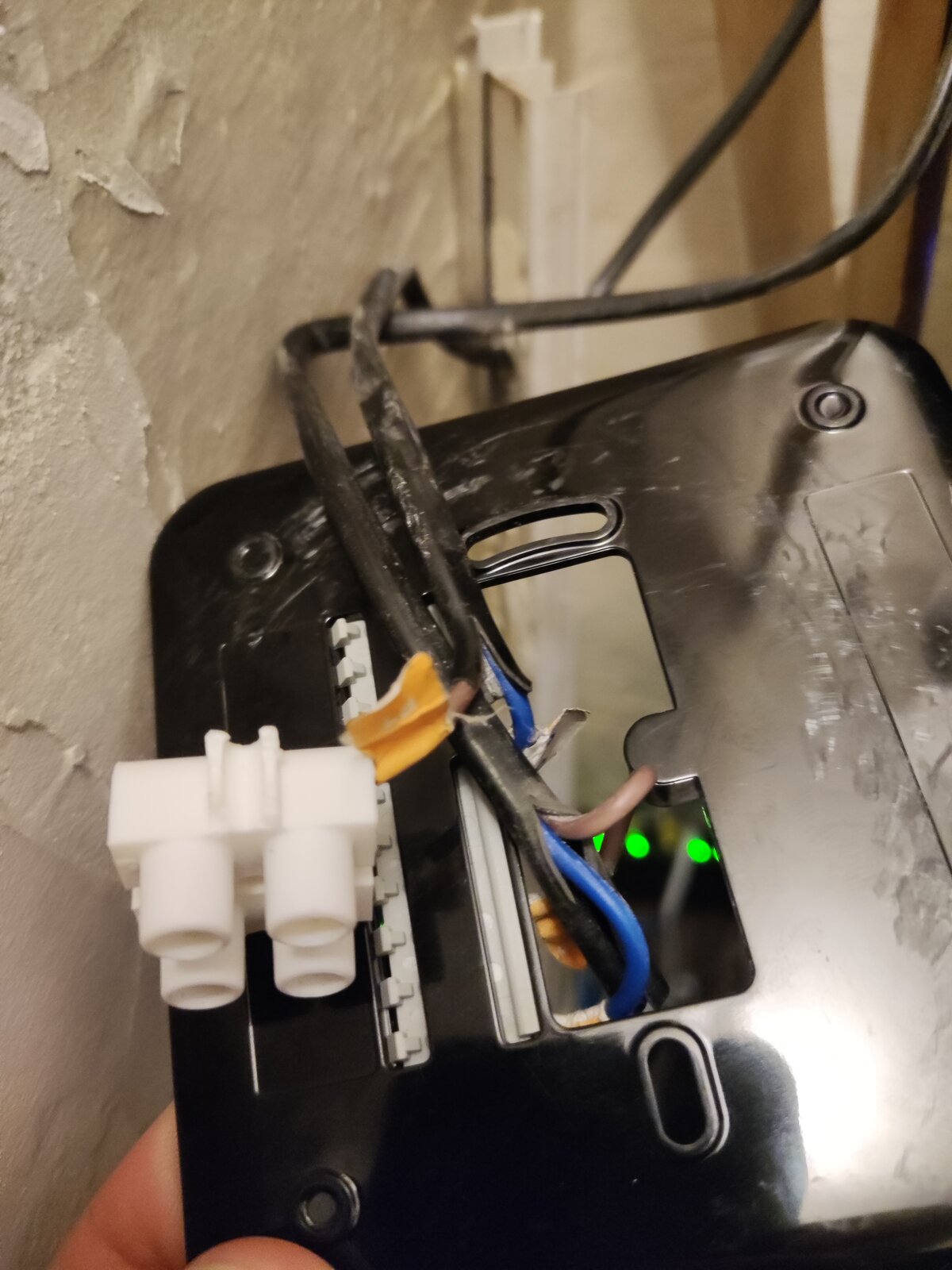

Wiring appears ok. Wonder if it’s the L in parking? Do you have a terminal strip block or Wago to place the L in for now?
Just put the L in a block and tried again, same issue unfortunately, boiler is still only in the On position.
Tried removing the faceplate (not sure if right term) of the tado and turning on the boiler and the correct behaviour is observed, where boiler in Off, not sure if useful info.
Thanks!

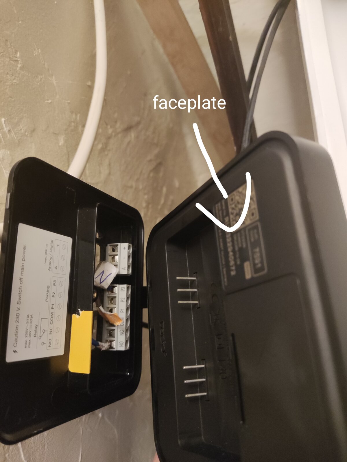

What do you mean by removed it? As I’m off the wall or wires disconnected?
No no, I mean, have the connectors connected, but removed the brains of the tado ( I did it as I was worried in case something was shorted and was causing to be on all the time.
Yes, that is useful, it tells us that the relay in the Tado is behaving incorrectly - either through some unknown setting, a sticky relay, or a fault.
I think from your description, you're telling us that the heating remains on, whether the heating is turned on, or off?
If so, can you remove the batteries completely and give the Tado a couple of gentle taps on its back with something like the handle of a screwdriver!
keep the batteries out for a while before replacing them and starting up the system.
That should hopefully free-up a sticky relay.
Are you using good quality alkaline batteries?
