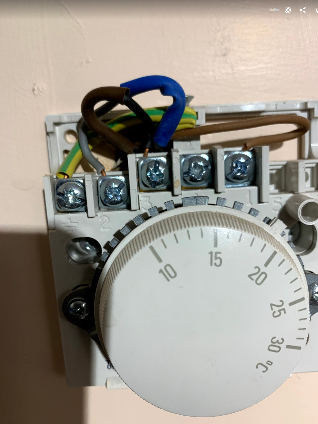

Hi Stem or anyone listening, came across this thread when trying to wire my Tado. It's the same thermostat but it's used to control the underfloor heating. (See attached picture). I tried the above but it didn't work so I think I need to use the NC as well? Attached is how my current Honeywell is wired. Thanks for any help! I'm keen to get this puppy working.
I'm not sure what your question is, but from your photo
1 = Live
2= Neutral
3= Switched Live
Earth = Earth
Thanks Stem, my question was do I need to write the Tado differently? I attached Com and No as you suggested, and parked the other terminals but the thermostat didn’t work. The thermostat is attached to an actuator because it’s underfloor so I’m wondering if it requires a different wiring format, perhaps using NC?
Sorry, bit of a numpty question I’m sure, but there aren’t any instructions on tado for my setup at the moment.
Happy new year!
You won't need to use NC. From an electrical point of view, the existing thermostat is just a simple on / off switch and the Tado is exactly the same you are simply swapping one switch for another.
If your Tado product is exactly the same as DamagedBob's, then:
The brown wire in Honeywell 1 should have gone to Tado 'Com'
The black wire with the brown sleeve in Honeywell 3 should have gone in Tado 'NO'
There are various Tado products. As well as the 'switch' some require a Live & Neutral connection to power them and some are battery operated. If you can post the specific details of your Tado product, I will have a look in more detail when I get home later.
Hi Stem, I found out the issue, your wiring advice was bang on, the issue turned out to be how the tado had been configured. All works well now. Thanks for the help, it was appreciated.
