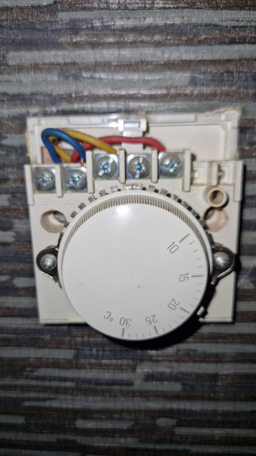

Planning to replace my son's Honeywell T40 Thermostat with Tado x wired smart thermostat and need some advice please.
Current set up is below:

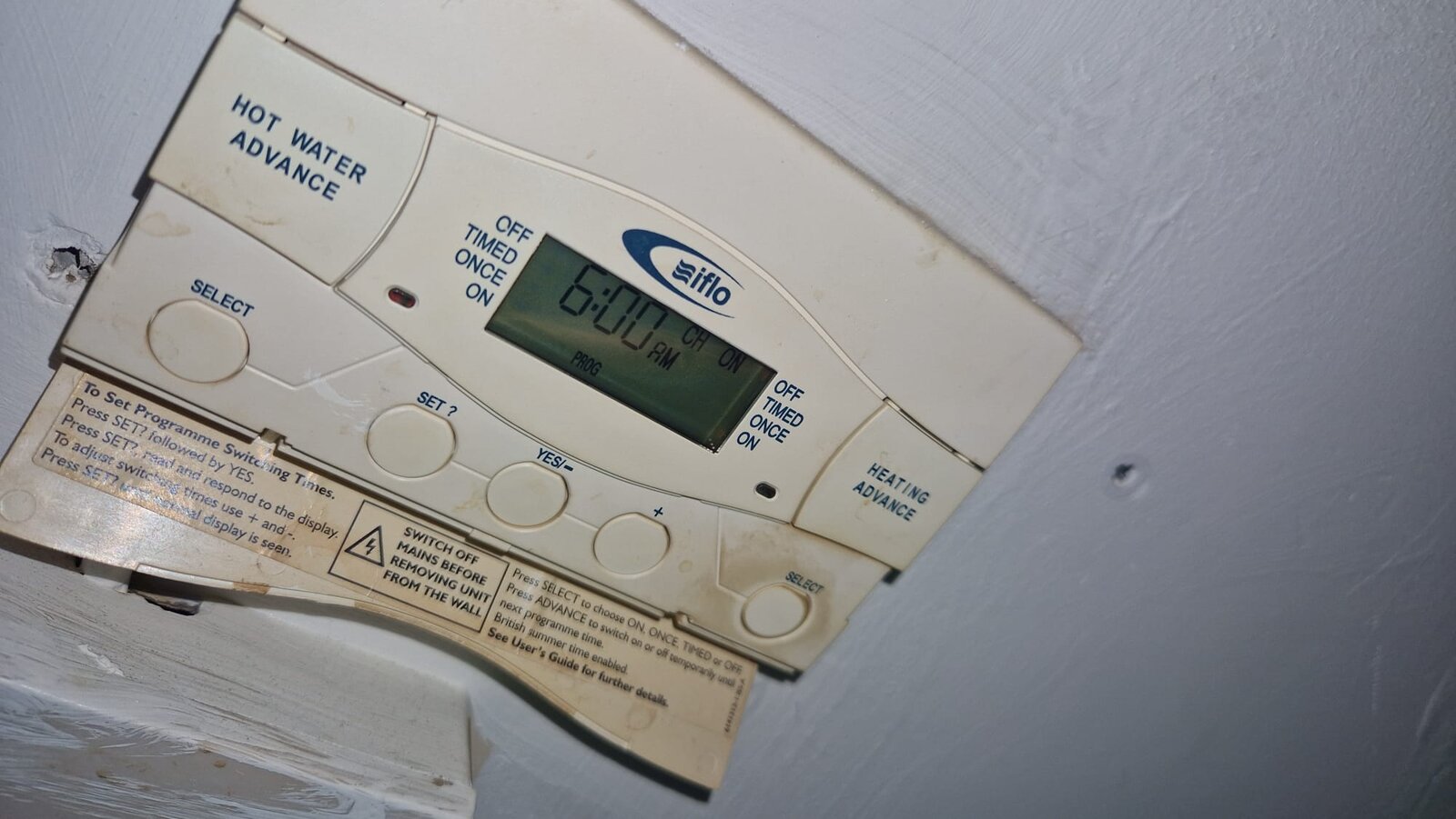

Iflo Timer/programmer
hot water tank in loft open vent
Boiler is Glowworm Flexicom 15HX Hight efficiency condensing boiler
Question:
i dont plan to change anything with the hot water. just the heating so we can have more control on heating.
will this work with the Tado wired smart thermostat X (starter kit) and if so how do i wire it please? anything i need to be aware of please.
i have attached some pictures of current Thermostat wiring, the iflo timer as well. unfortunately there is no model number anywhere on that Iflo so no idea what model it is.

Looking at the wiring diagram it's a case of swap the Honeywell for Tado.
Red = Live
Yellow = switched live
Safely terminate the neutral in a connector block unless there's a spare terminal in the Tado.
That's all there is to it other than follow the rest of the instructions
Thank you . I guess I can tape the blue cable up with electrical tape? Shouldn’t be an issue I guess?
Thank you for the response
I don’t know if it would be an issue, but I wouldn’t be doing that. Only because a Neutral could become live through a fault condition
