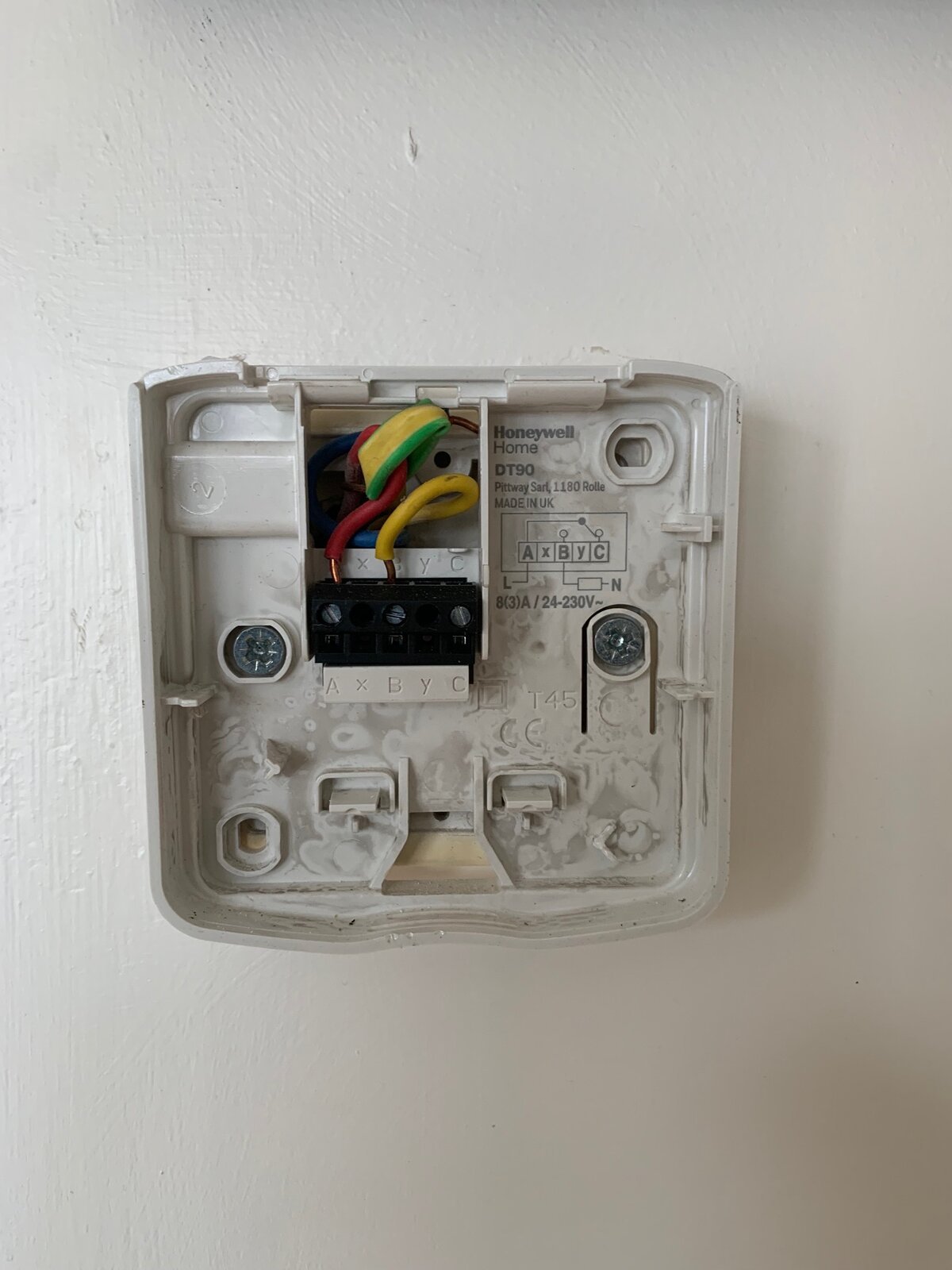

hi Everyone, i would like to replace my room thermostat currently honeywell DT90E with the Tado wired smart thermostat X (starter kit)
my current system detgails are :
-Vailant boiler Ecotec plus
-Drayton LP522 programmer
-Honeywell DT90E Thermostat ( has x2 AA batteries)
-hot water cylinder in airing cupboard(pressurised)
-no cold water tank in loft
Question:
will this work with the Tado wired smart thermostat X (starter kit) please? anything i need to be aware of please, as this will be a DIY job.
i have attached some pictures of current Thermostat wiring. currently although there are 4 wires as you can see from the picture (red,yellow,blue and green/yellow-earth), only the red and yellow cables are actually connect. am no electrician :giggle:
my current system has worked fine past 4 years with no issues at all, apart from the annoying fact that i cannot control the thermostat unless am home and infront of it. being able to control it from my phone will be great.

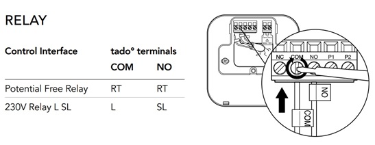

You have posted this question in the wrong forum. Plumbing and Central Heating would have been better than Car Repairs/Maintenance. So you may find the MODs will move it. However here is the information you require:
The Tado wired smart thermostat X will replace the Honeywell DT90E Thermostat using the same two wires.
Red Wire in Honeywell A = Tado COM
Yellow Wire in Honeywell B = Tado NO
As the Tado has both time and temperature control built in, the programmer will become redundant as far as heating is concerned. Therefore it should be set so that the Central Heating is permanently 'on' 14/7 and then the Tado will take over full control of the heating schedule. The Hot Water will still be controlled by the Drayton.

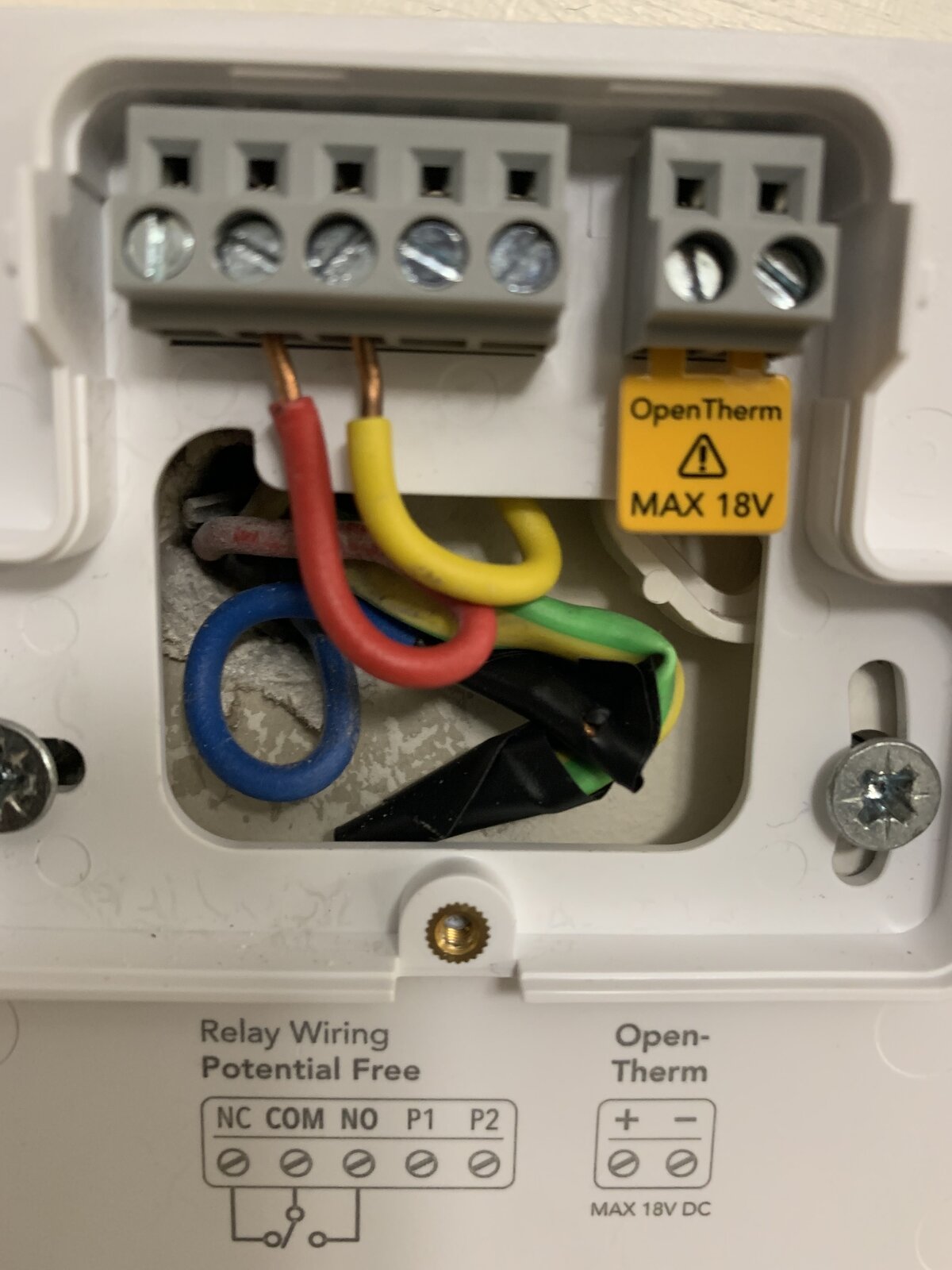

hi Stem, thank you so much. this has been done and now working perfectly. however i have a further question ref to wiring. please see below wiring on the tado. should the blue (neutral?) and yellow striped (earth) be connected to the P1 and P2 terminals? or can i leave it taped off please? thank you
