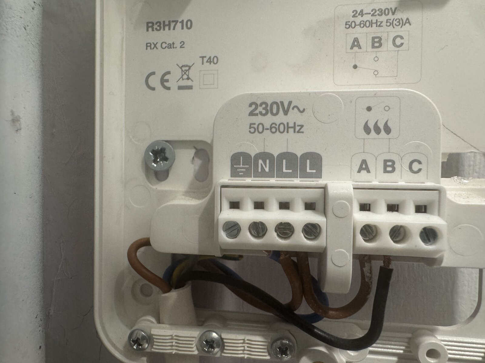

Hi all
I have a combo boiler. A Nest controls our radiators and the Honeywell our Underfloor heating. So the cabling is spurred from the boiler already.
I want to replace the Honeywell wireless receiver for a Hive.
This is the current wiring for the Honeywell. Is it a straight forward change?
Would be great full of some guidance.

Yes, it is straightforward (assuming a single channel Hive).
The Blue wire in N on the Honeywell, would move to N on the Hive receiver backplate.
The Brown wire in L to L.
The Black wire in B to terminal 3.
The short Brown link wire would connect L and terminal 1.
The Green/Yellow wire would ideally park in the Hives earth terminal.

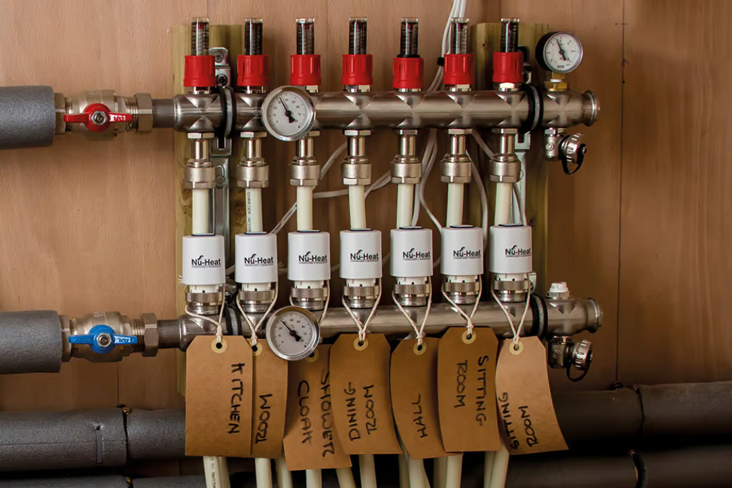

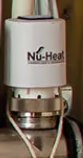

But what I can't work out, is how Hive works with UFH? 1732441425788.png this 1732441466856.png may look like a TRV head, but it is hard wired, not sure if you can replace them with smart TRV heads?
Underfloor heating is very slow to react, I found out in mothers wet room, it needs to go on hours before it is required, and geofencing is in the main activated when one is nearly home, I tried it with Nest and Energenie, and in both cases, it detects one is near home far too late, handy to auto turn off heating when you leave home, but needs manual intervention to turn it back on in time for your return.
