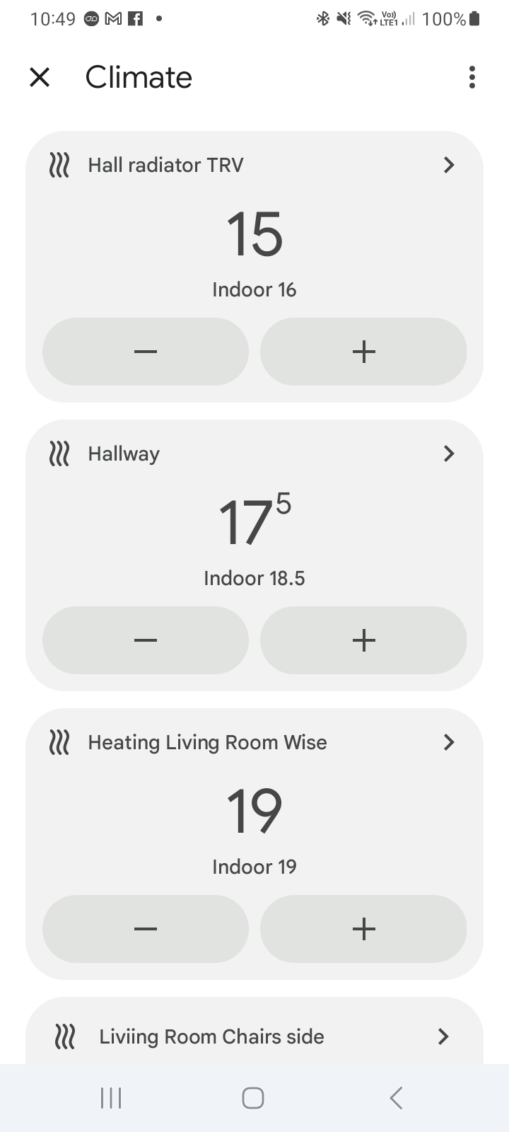

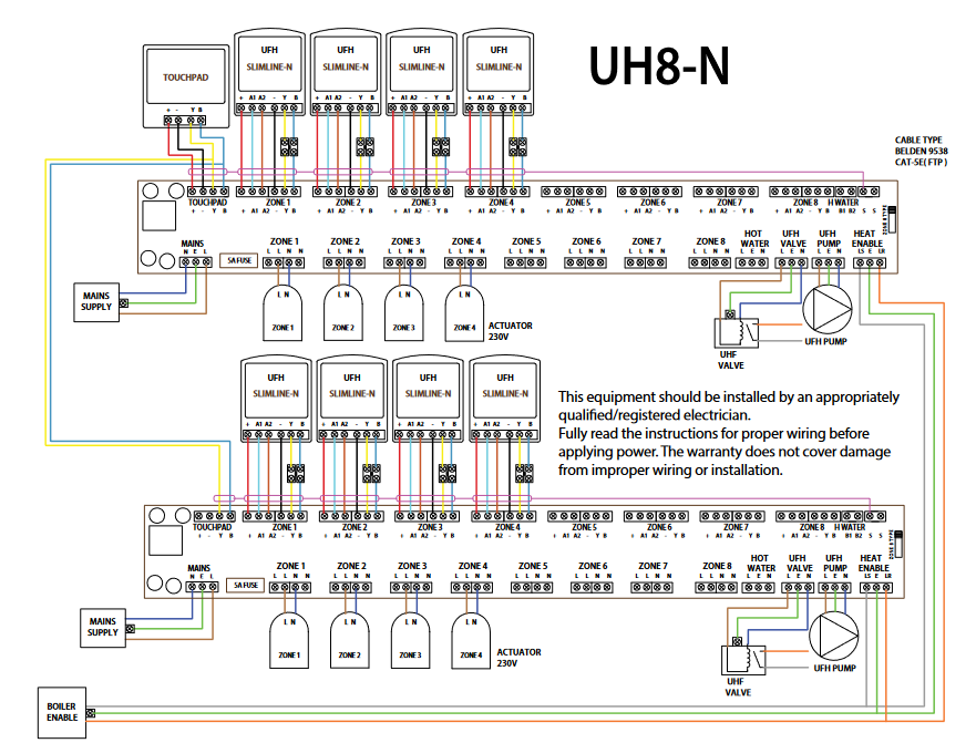

I have looked at UFH a few times 1732444431445.pngthe controller is full of relays, and loads of thermostats, I am sure there is a way to turn off all, rather than a load of internet connected thermostats? I look at my own house 1732445436259.jpeg and yes the app shows a whole host of thermostats, handy for the TRV thermostats, as don't want to bend down to alter them, but the wall mounted, easier to adjust it on the wall, than get the phone out.
