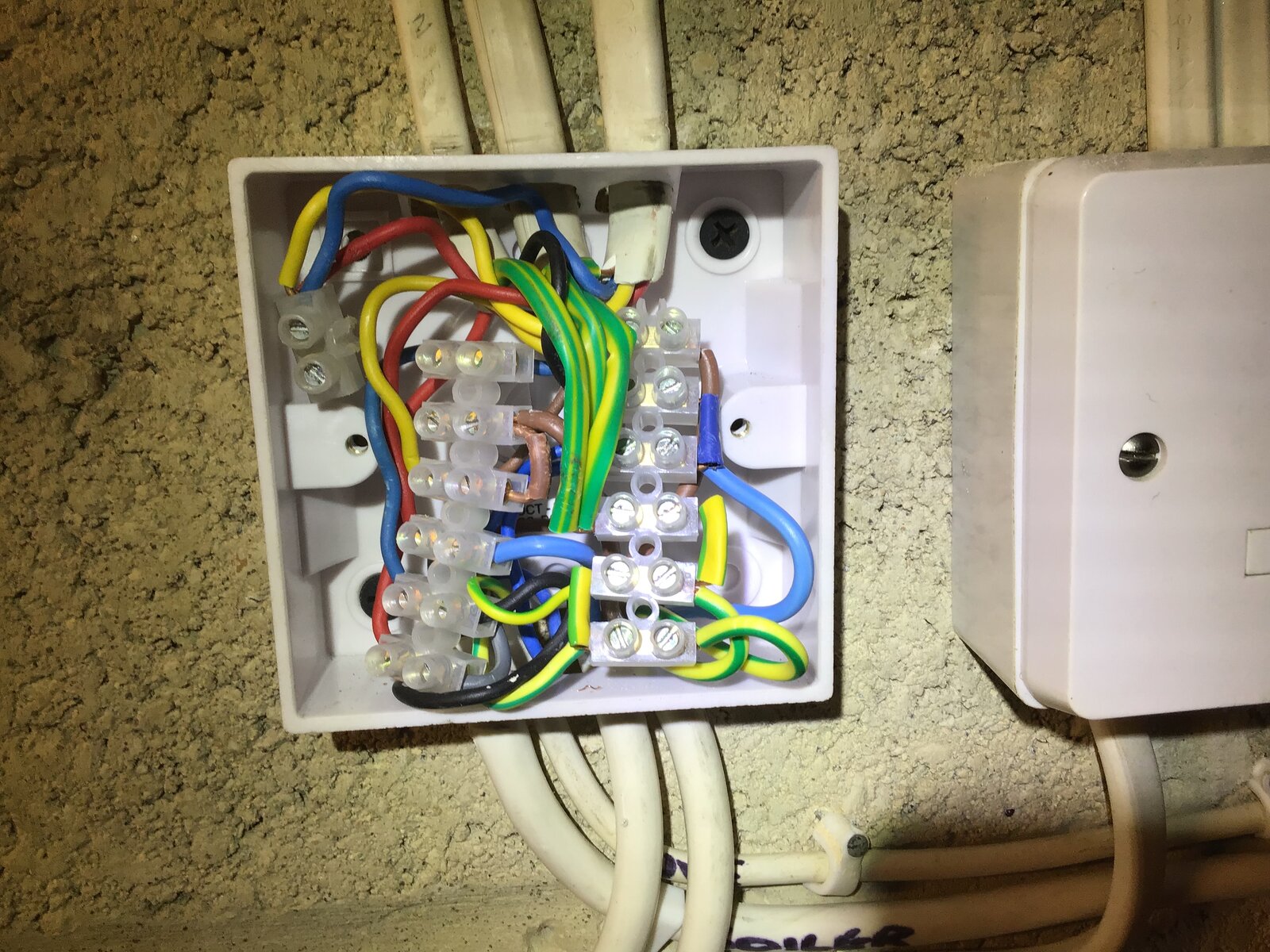

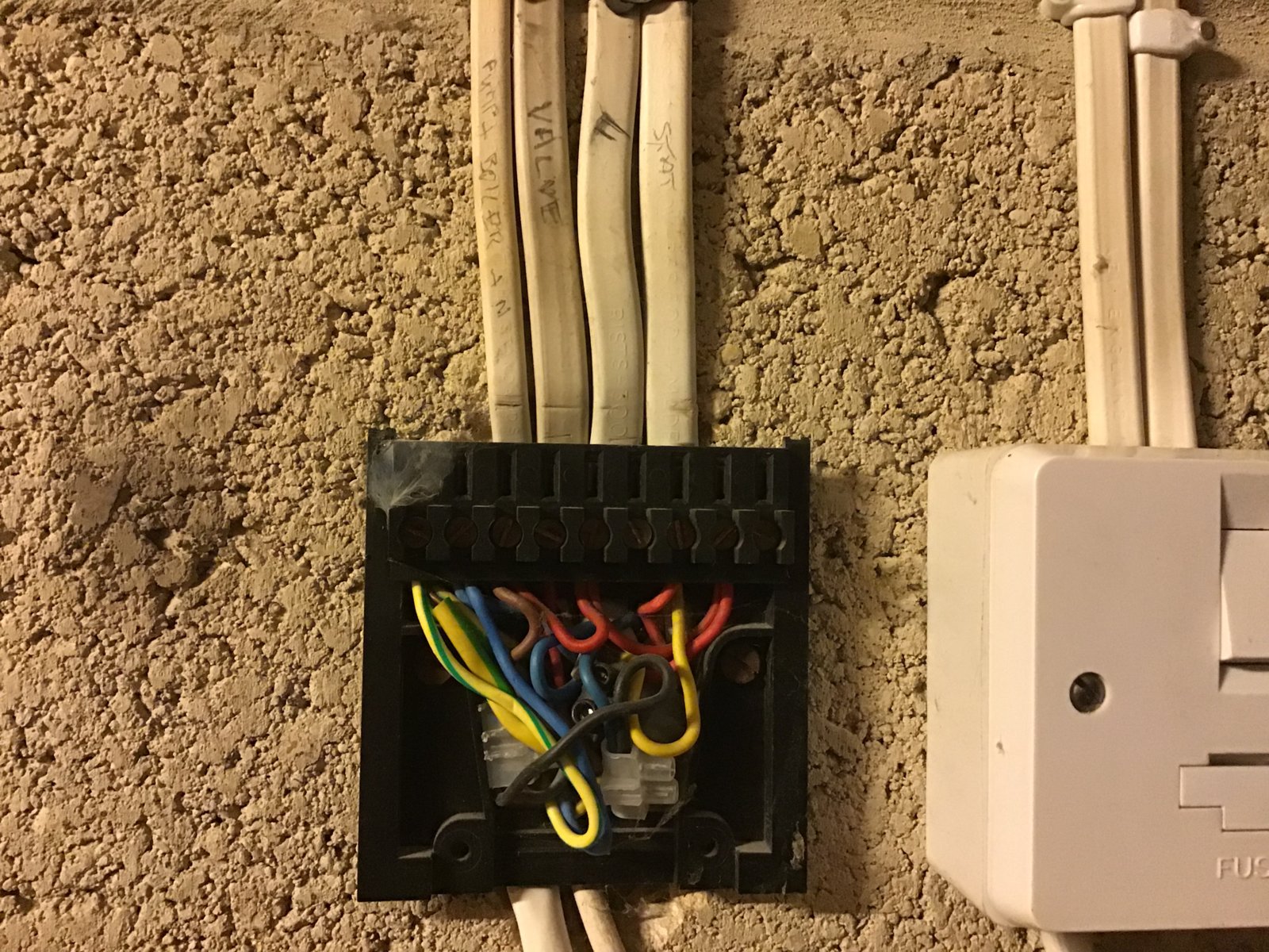

The 'wiring centre' in the airing cupboard is a fairly conventional set up...
...with the MPV coming in on the left, cylinder stat from bottom left and pump from bottom centre. But no sign of the room stat connections.

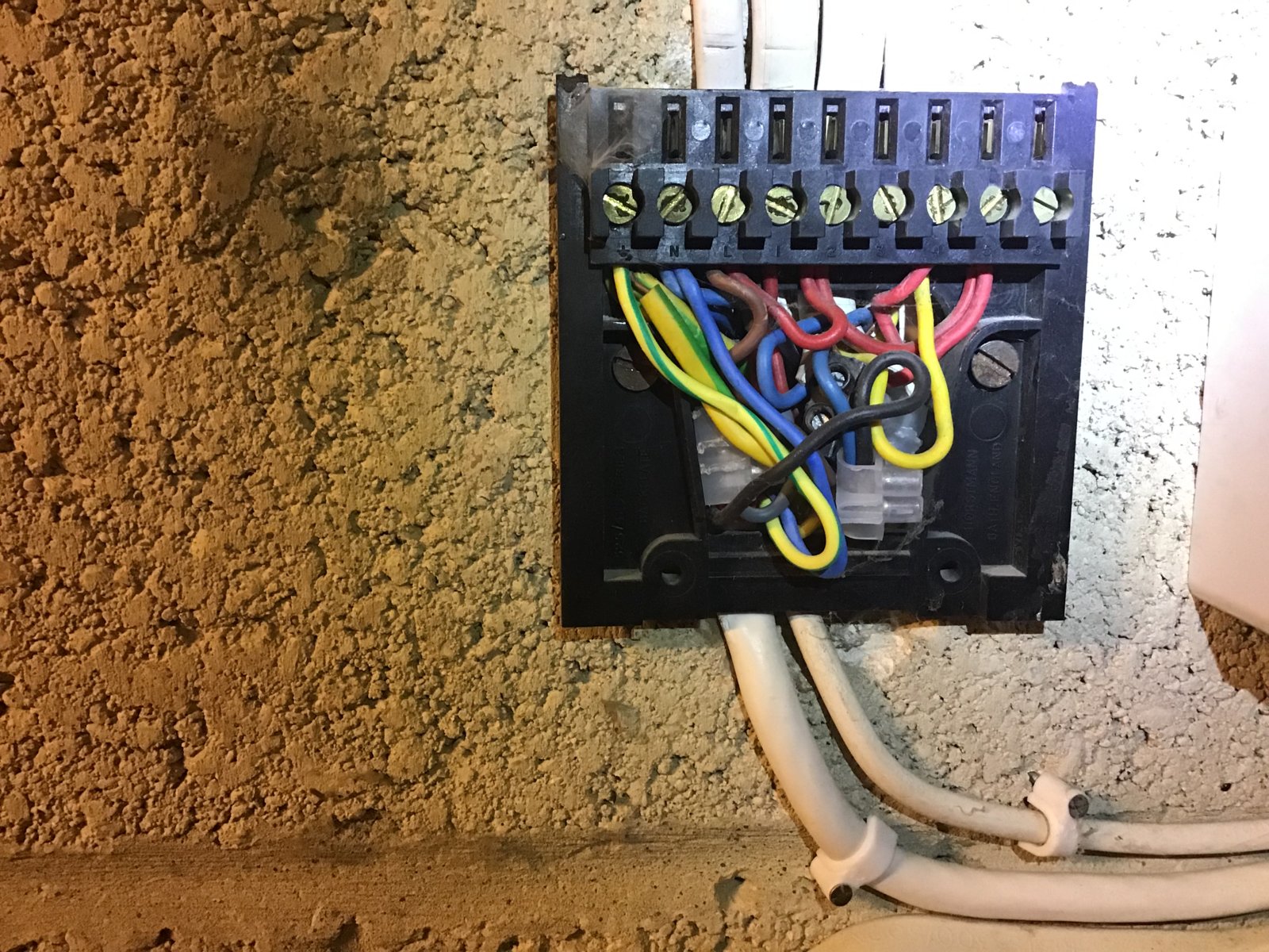

When I removed the programmer from the backplate I was faced with this...
...and this is where I get really confused.
Apart from not being able to see what is connected to where (but logic and a meter will show that in good time) there is no wire connected to terminal 3, HW OFF. It hasn't come out or been cut, it simply was never there as the terminal screw is fully in. Being winter I have no intention of opening this rat's nest and leaving the lady in the cold, until I have a day or two to understand it fully. The cables at the top are 'labelled' from the left, Pump+Boiler+N, Valve, F(Frost Stat) & Stat(Room Stat). Cables at bottom are Boiler on the left and mains on the right.
My question is why was this system wired like this (no wire to 3) and what is happening if HW OFF is NOT being sent to the grey wire on the valve? Permanent hot water when the CH is on I guess. Having a mixer shower, and being in a new-home cleaning frenzy, the lady needs the hot water, just not permanently.
Of course, being a mere DiY'er, I have probably missed something obvious here...
Your thoughts gentlemen and gentleladies?
A Hive Dual Channel receiver can replace the Horstmann Diadem
Horstmann
Hive Dual Channel
From the above diagrams, and assuming that the system is presently working correctly, the wires move from the Horstmann terminals to the Hive terminals that have exactly the same function as follows:
Diadem E = Hive Earth Tether
Diadem N = Hive N
Diadem L = Hive L
Diadem 1 = Hive 3 (Hot water on)
Diadem 3 = Hive 1 (Hot water off)
Diadem 4 = Hive 4 (Heating on)
There shouldn't be a wire in Horstmann terminal 6 (heating off) and don't worry about the links to the Horstmann terminals 2 and 5. Hive has these already made internally.
The room thermostat should normally be connected to the white wire of the motorised valve, which I have circled in purple below:
Therefore it would be usual for the yellow wire in the same terminal will be the 'switched live' from the room thermostat (you will have to check this)
It's difficult to see properly in the photo, but it appears that the red wire going to the terminal circled in green is from the same cable as the aforesaid yellow, if so, that is likely to be the 'live supply' to the room thermostat wire (again you will have to check this).
If after checking, you find that my assumptions are correct, and the cable at the top of the junction box is the one going to the room thermostat, it should be disconnected completely and removed, and then the white wire from the black cable of motorised valve should be put in the terminal in place of the removed red wire.
If you have any doubts, or any of my assumptions aren't correct, don't proceed and post back. It looks that the Horstmann may be being used as a junction box in addition to the circular junction box, so you may find the reality is different to the norm. (if there is a norm)
If it were me I would be stripping everything out and starting from scratch with this one, at least with the connections but perhaps reusing some of the installed cables.
You are right about the 'HW off' from the Horstmann terminal 3, it should be connected to the grey wire of the MV, I can't see the photo clearly enough. Are you sure its not hidden in the rats nest.

Here is a better photo of the rat's nest...
...and you can see that terminal 3 is empty and the screw was down tight.
As you say, stripping back and re-purposing the cables is the best solution. I never like to strip out things like the room stat cable in case future owners want to go back to a simple system so that will be re-routed into the airing cupboard, isolated and labelled. Also, I have always installed Lifestyle Wiring Centres in all my homes as it makes future changes much more straightforward.
However, between the Valve cable and the PumpBoilerN cable I should be able to get everything back to the airing cupboard with nothing more than a simple piece of chocolate block in a patress box to get the boiler connection sorted.

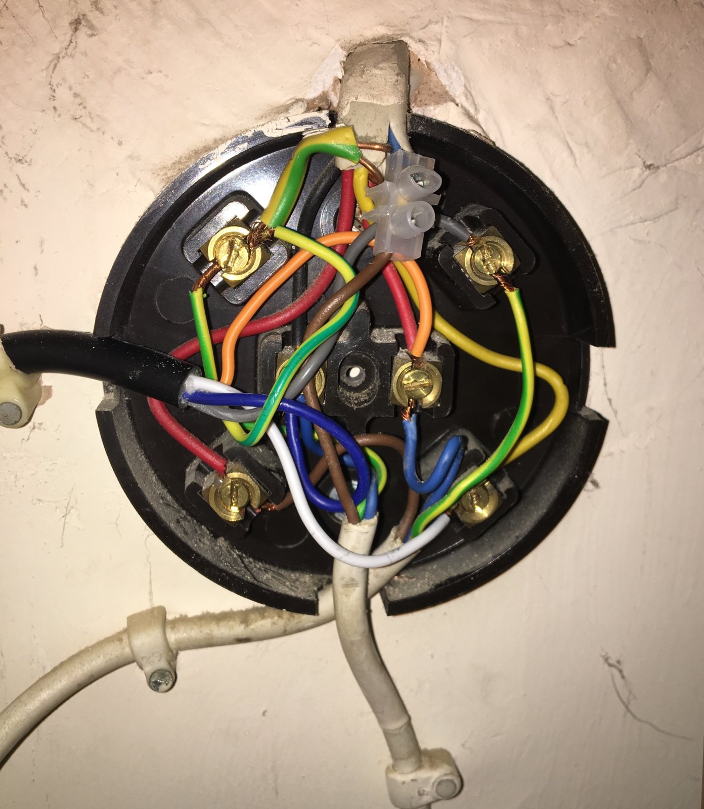

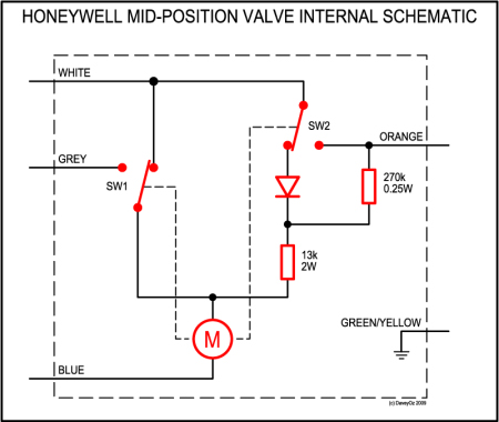

Some of what you have said makes sense, if you look at the internal wiring of a mid position valve
the supply to the boiler is in two positions through the tank thermostat, the first thing to remember grey is made live when DHW is not wanted, and it seems if DHW is on at programmer this will become line once water is warm enough, so SW1 is made to grey when half way and SW2 is made when all the way, white is CH and grey NO DHW.
So for DHW on its own valve does not move and the boiler gets supply from the tank thermostat.
for DHW and CH the boiler is still powered from the tank thermostat, and the motor in the valve is powered by SW1 until half way, then the diode and 13kΩ resistor hot it in centre position.
for CH only power on the grey moves valve all the way, and white powers boiler through SW2 and orange wire, but in your case no power on grey if programmer switched to DHW off, so CH would not work, if the programmer was set DHW on then when tank warm enough it will just run CH but not is programmer turned off.

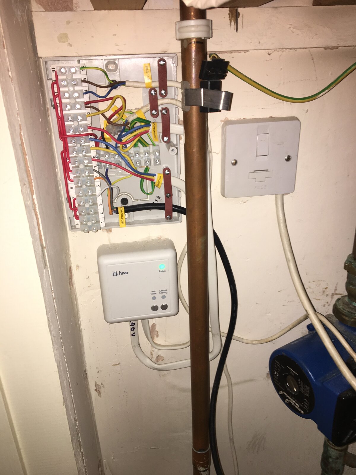

I have since stripped out the rat's nest behind the original, defective Horstmann and replaced it with a separate patress box and chocolate block prior to eventually fitting a Lifestyle wiring centre at this end of the wiring run...
...with a second one replacing the junction box in the airing cupboard for neatness and completeness.
And as you can see, I now have the Hive receiver fitted alongside and working perfectly within the limits of the wiring...
Once all the wiring behind the Horstmann was exposed it became obvious that the 'missing' wire to terminal 3 was not a mystery, merely a system wired to operate on the basis of no CH without DHW, possibly in some earlier or even original installation. The place was converted into a dwelling back in the early '90's.
For now, the system is still working in this configuration (with the Hive schedules for CH and DHW set to run at the same times) until such time as I can get a cable through the gable end wall from the garage into the rest of the house. I could re-purpose the wire from the room stat but don't like to make things non-reversible and if Hive ever disappears then reversible it will need to be.

You could set the Hive into "gravity mode", then when heating is set to come on it will also turn the hot water on automatically.
To do this first turn the power off wait 10 seconds then turn it back on.
Now press the left hand silver button on the receiver for 10 seconds and the top green light will turn blue.
Job done.
The other alternative is to wire the receiver into the junction box where the valve is, but that would require a few wiring alterations.

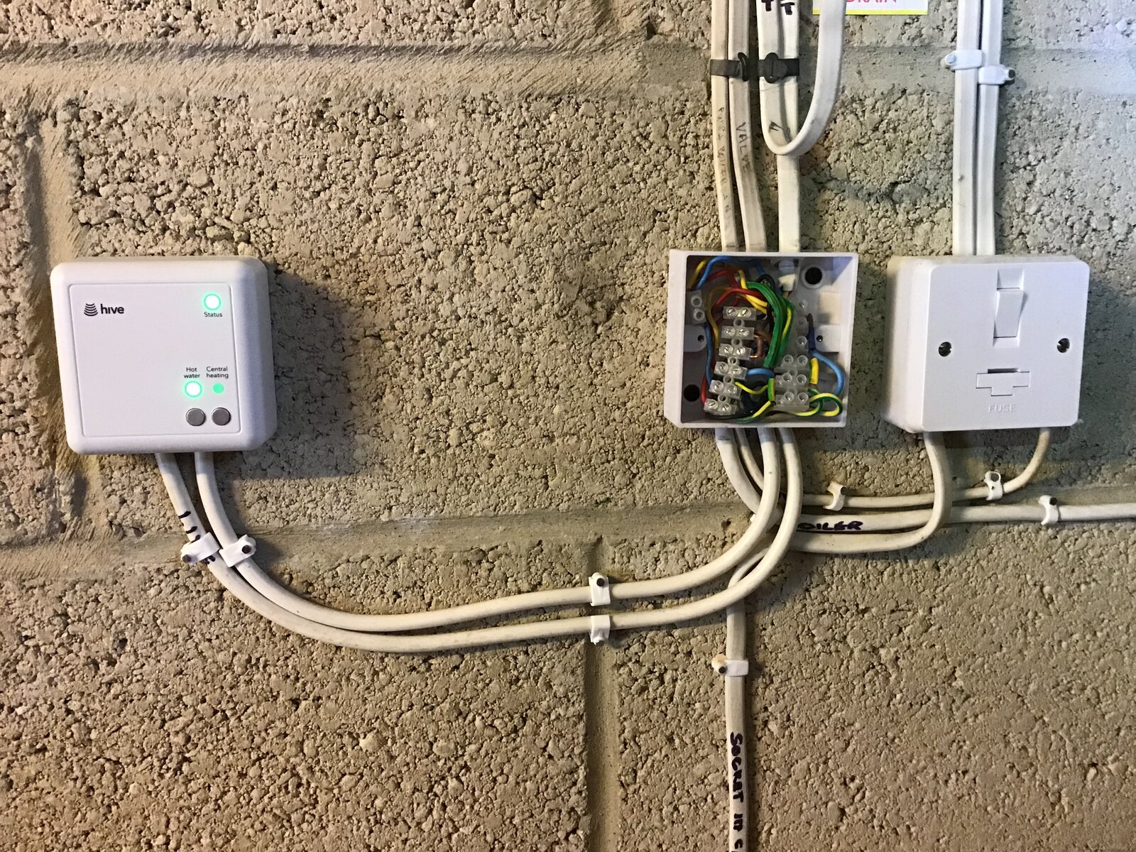

Well, yet another lockdown. But, before we all got sentenced, I finally managed to get everything working.

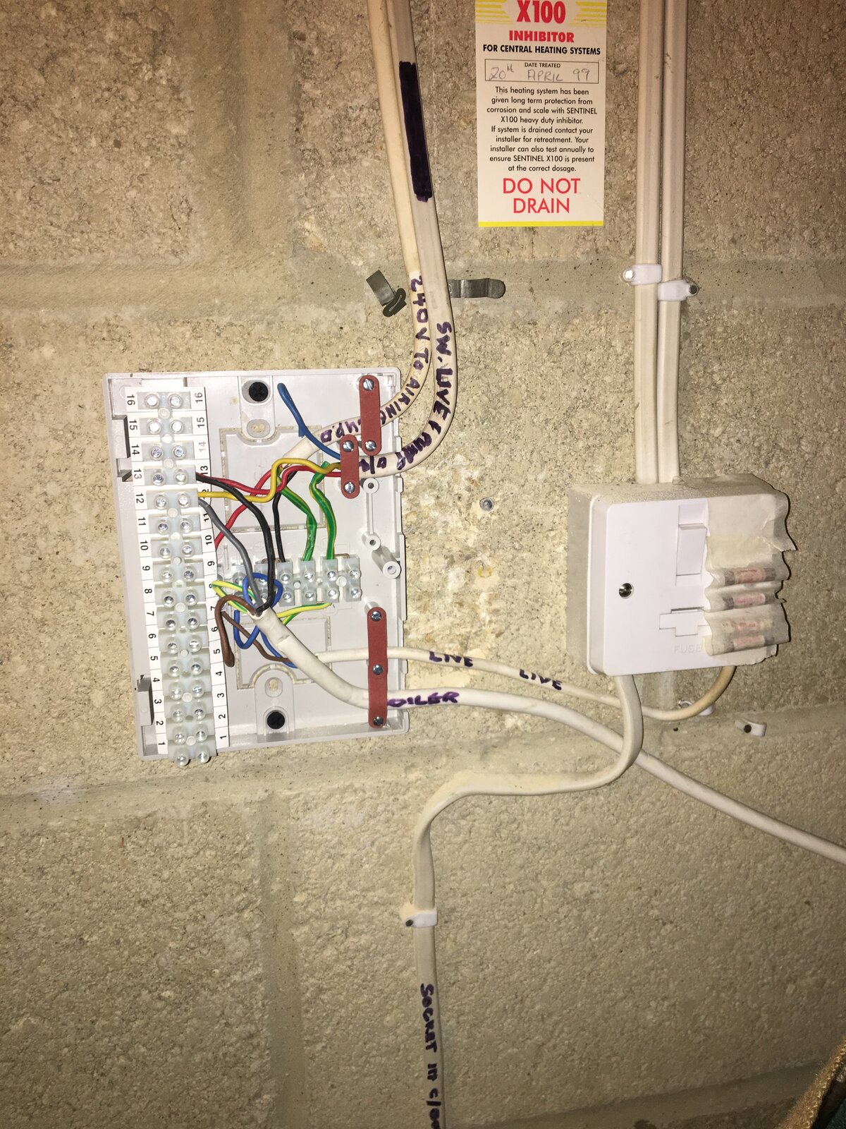

I followed John's excellent advice and moved the Hive receiver to the airing cupboard. This meant that there were enough cables to re-jig everything without having to venture into the loft to add more.
I had already bought two Lifestyle wiring centres, one for each end of the run and although that was now overkill at the boiler end, it produced a much neater and more logical result than the original...
...and as the boiler has its own froststat built in, the wiring became even easier as I could now ditch the separate one.
The result in the airing cupboard was even better...
So, all in all a great result and the lady is delighted. No need to visit the garage to set the hot water 'on' just so she can have heating 'on' and indeed no need to visit the airing cupboard because she can control everything on her Hive schedule and have whatever combination she likes, even turning her heating on before she gets home from a weekend away. Doncha just love technology? When it works.
