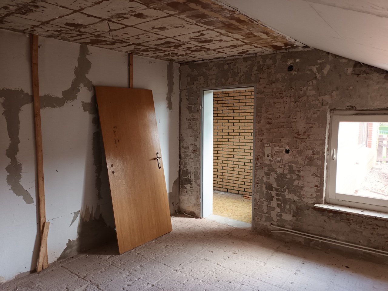

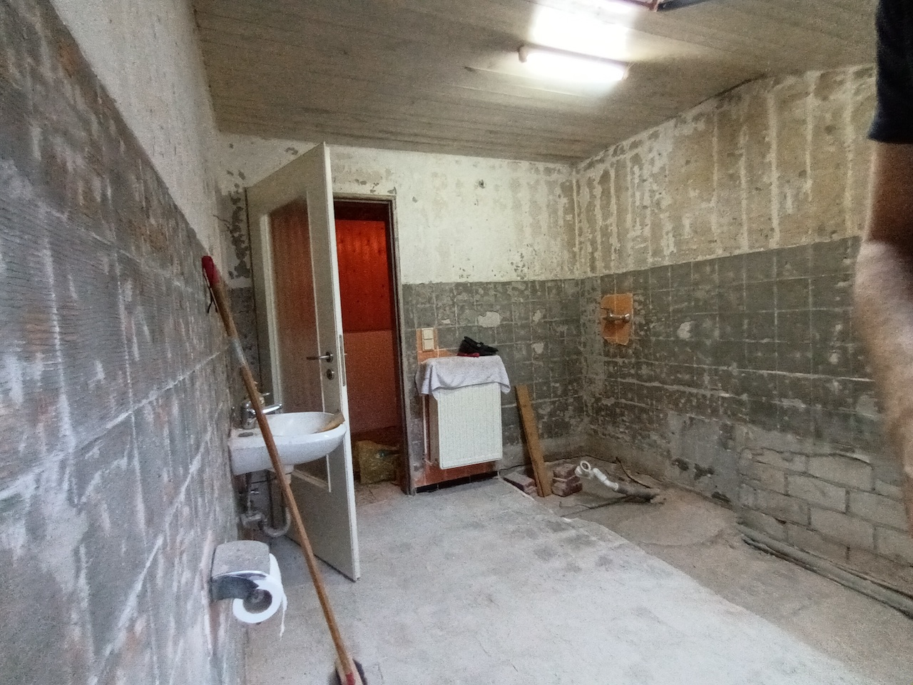

Some of the door frames in our new property are metal. We would like to replace with wooden frames. Am I correct to assume that there is likely no lintel above the frame, and that the metal frame actually acts as a lintel itself?
I assume for a builder this is a fairly small job, however I don't fancy tackling it myself. Is this a job that some builders would be happy to do?
I am correct to assume that there is likely no lintel above the frame
I think it unlikely that the door frame serves as a lintel, but as the pictures don't show what is inside the wall above the top of the frame it's not possible to guarantee that. Concrete lintels are cheap, if absent
