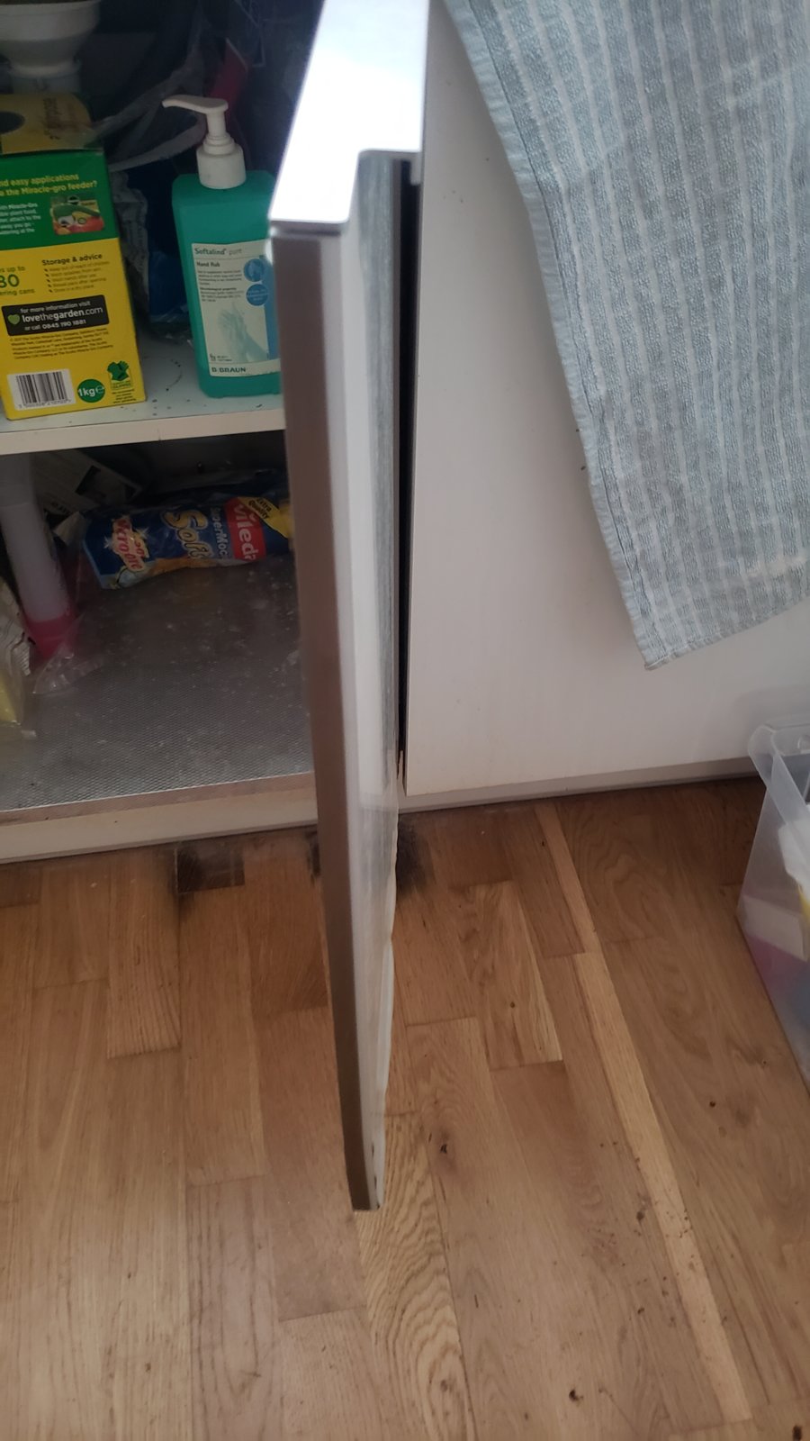

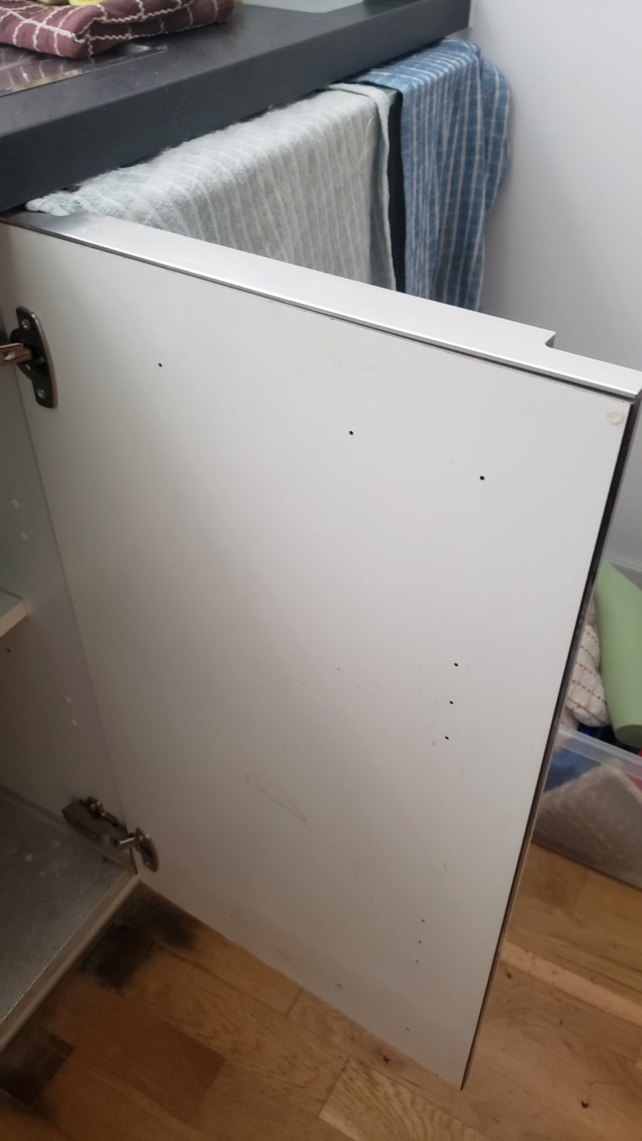

I need to replace a couple of kitchen doors but don't know where the kitchen came from. Can anyone help based on the photos below please?

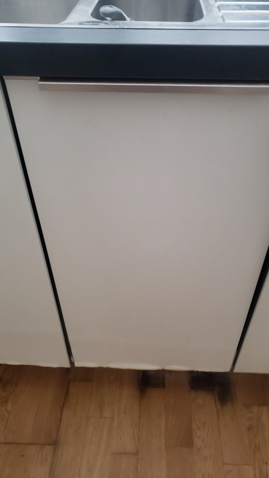

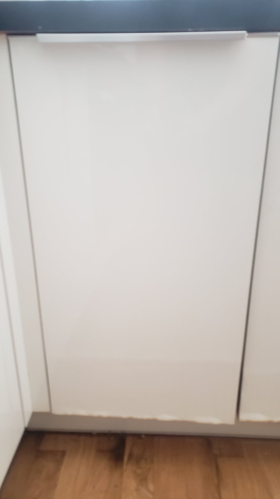

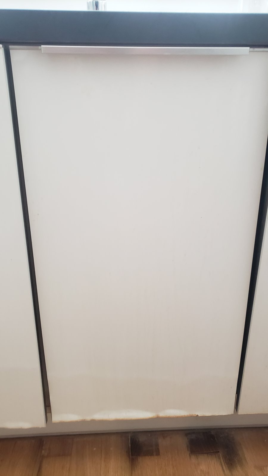

Hi @JohnD And thanks for replying. The doors are 400mm x 720mm ( not counting the metal handles).
Here's photos from the front:
I'd like to keep the handles if possible.
400x720mm nominal is probably 396x 715mm actual, so the doors open and shut with clearance.
It looks to me like they are simple rectangular slab doors. Presumably either laminated (very hard finish, can be gloss or matt) or vinyl-wrapped (tends to peel off at the edges, especially if they get damp, or hot, or a cat scratches them)
If they are white, they will be very easy to match. You might find that modern ones have the hinge positions slightly different, but this is easy to get round by drilling new screwholes in the cabinet.
The handles may possibly have a fin that is pushed and glued into a slot on the top of the door (unless you know otherwise). You could probably replicate this if you have a circular saw. I've seen them readymade like that but AFAIK it is not a standard design.
Standard sized doors are cheapest from the manufacturers.
Can you work out if they are actually white; and if they are laminated, wrapped or painted? There are quite a variety of standard colours, but a special colour will be more expensive as the budget makers probably won't match it.
