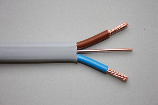

This picture shows what the cabling is like:
http://www.heluxgroup.co.uk/page/upload/modproduct_4bfb985d5f501_b1.jpg
The differences being that the colours are the old ones, and the middle earth core is snipped back to the grey sheath. I'm now pretty sure it is twin and earth cable that has been snipped back and I will buy a multimeter to verify this. If it is, and assuming there is sufficient slack or a safe way to extend it (?) I can connect the earth to the new faceplates. If there is no earth continuity I will be getting an electrician in to make it safe.

As you will now have realised that the issue will not just be at this particular switch, but will likely to be common throughout your lighting circuit, so you are going to come across similar earth/CPC(Circuit Protective Conductor) problems at switches and fittings and very likely junction boxes/joints within ceiling/floor voids, these will all need to be addressed to get continuity throughout this circuit. Then you would also need to check that there is actually and earth/CPC at the board for this circuit.
It is not unusual to find single cores at the board and no earth/CPC for lighting circuits, even though there is evidence of an earth/CPC at other parts of the circuit.
Even though it is not unusual to come across lighting circuits that have no CPCs in installation dating back to the 60s, you also come across ones that used the metallic conduit as a path to earth.
A multi meter or low ohms reading continuity meter will be a helpful tool to confirm the continuity of the earth/CPC.
This test is performed with the circuit isolated and is generally done using one of two methods.
1) r1+r2, these are the Line/live(r1) cables and earth/CPC(r2). These conductors are connected together at the fuse board, the meter is nulled out and test made at lighting, switching and junction points, testing across live/line and earth/CPC.
2) Wander lead, this would require running a long lead to lighting/switching points from the earth/CPC at the board. The lead will need to be nulled out from the reading taken and the test is done between lead and earth/CPC at the accessories.
