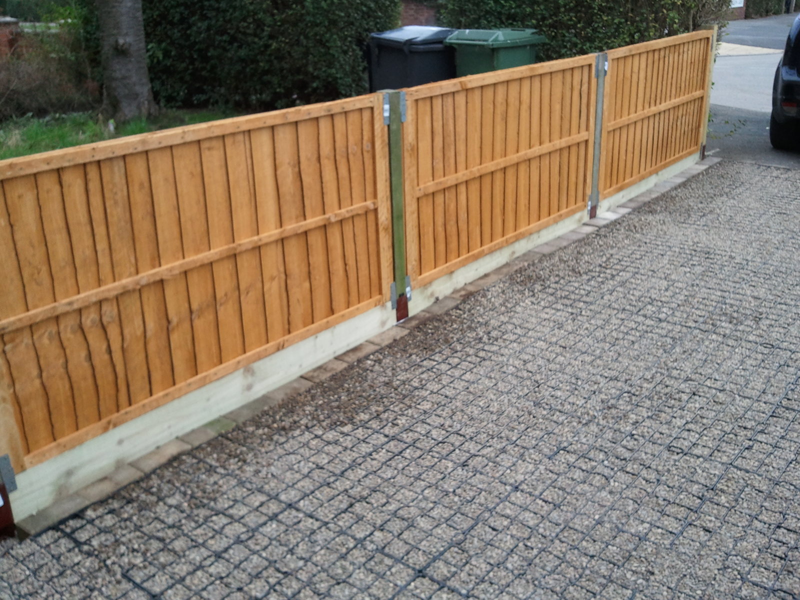

Depends what sort if finish you want really.
I bought the plastic grid and filled with 10mm gravel, been down 6 years and in use daily.
Drains very well as well.
I noticed a house down the street was having a resin driveway done and they used the same grid and gravel as a base for the resin top coat.
With mine I put a thin layer of gravel down first to level it then the grid and gravel on top.
Took a day to do drive and fence.
@Keithmac
How does that drive cope with weeds growing through? Maintenance? Clearing with a snow shovel? Losing stone etc.
I like the fact that it acts as a giant soakaway rather than the rain water heading down the drain.
Weed wise it's not bad, couple of goes a year with the Round-up.
Weed break underneath would be a good idea though.
I've not lost any gravel at all, went flush to the top of the grid and it's all stayed put.
I haven't shovelled snow off it so can't comment on that one yet, never had any problems driving off it.
As you say it's a giant soakaway which was part of the appeal.
The other side is large gravel only and crap in comparison, on my to-do list!.
