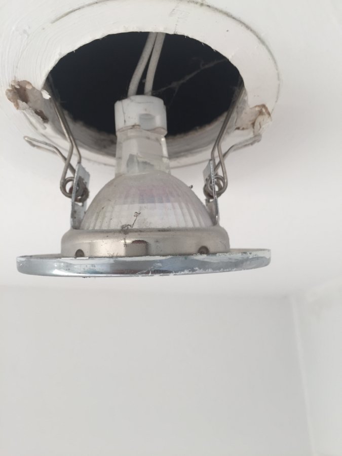

Hi - I have 5 spot lights I inherited in our bathroom, which are looking pretty shabby.
I'd like to replace them with some inexpensive white replacements as I plan to gut the whole room in 3-4 years time.
These are bulbs I'm not familiar with but I'd like to replace them with GU10 LED bulbs. Can anybody recommend a suitable replacement fitting and anything I need to look out for?
Thanks, Nick
It is a GU5.3 fitting and likely it is 12 volt. Somewhere likely there is a transformer or electronic transformer which would need removing to change to GU10 and also the wiring will need an earth even though likely there is nothing to connect it to it will be just taped back. Find the transformer first and then work out what needs doing.
Thanks ericmark
I have 7 spots in the bathroom all working off the same switch (pull cord) - 5 are GU5.3 as you noted and 2 are GU10.
I think the transformer is buried in the ceiling somewhere
Should I just replace the GU5.3 fittings - like for like?
Thanks, Nick
No transformer just inside the hole? Most just get stuffed through the hole when they are wired from below.
