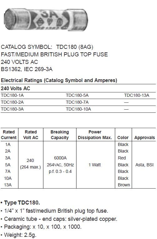

How about a 1 amp fuse and a slow acting type C MCB ? Such as for installations where discrimination is essential to ensure that one lamp going bang does not mean all the other lamps lose power.
1 amp fuses are not standard and difficult to get. The fuse is to protect the cable, not what is on the end of it. The 6 amp MCB in the CU does this admirably. If double pole isolation is required fit a double pole switch. It may cost a fraction more but cost should not be the major consideration.
Anyway a properly installed outside light should never fill with water (mine don't) and therefore don't require double pole isolation any more than an inside light does.
https://uk.rs-online.com/web/p/cartridge-fuses/0412986/
The only standard values are 3 and 13 amp. 3 amp for small cables and 13 amp for larger cables.
Then go and tell Busmann and other companies that they are wasting their time and effort producing 1 amp, 2 amp, 5 amp, 7 amp, and 10 amp fuses.
Remember the fuses are only to protect the cables not whatever is on the end of it.
That is the regulatory requirement to prevent heat / fire damage from overloaded cables.
Fuses can also be used to disconnect defective appliances from a distribution cable ( such as a ring final ) leaving the distribution cable still able to supply power to other appliances. This a very very common use of fuses in every building in the UK. ( exept those buildings that do not have an electrical supply ).
