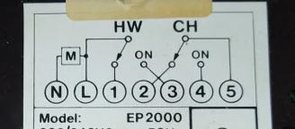

The EP connections from your photo are
and the Hive connections are
hive-jpg.160971
As you can see they are identical in function, except that the EP has a terminal (5) that has a wire linking it to the (L) terminal. The Hive already has this connection made for you internally, so you simply loose the link wire between the EP (L) and (5), then the remaining wires transfer from the EP to a Dual Channel Hive like for like. [N, L, 1, 3 & 4]
The brown wire in terminal (5) will need reconnecting to (L) as you have figured.
The other terminals A to D are just there as handy terminals, they have no function other than to facilitate the connection of the wires that are in them. The same is true of the earth and neutral connector bars on the right and left. These wires should remain connected together as they are now. You will need new terminals for them.
If there isn't one in place already (I can't be sure from your photo) would sink a single back box into the wall to contain all of the extra terminations and just bring the N, L, 1, 3 & 4 connections into the Hive receiver. [If it's a metal box don't forget to make sure it has an earth connection to it] Make sure you identify the wires before you disconnect them, get them mixed up and it would be almost impossible to fault find over a forum.

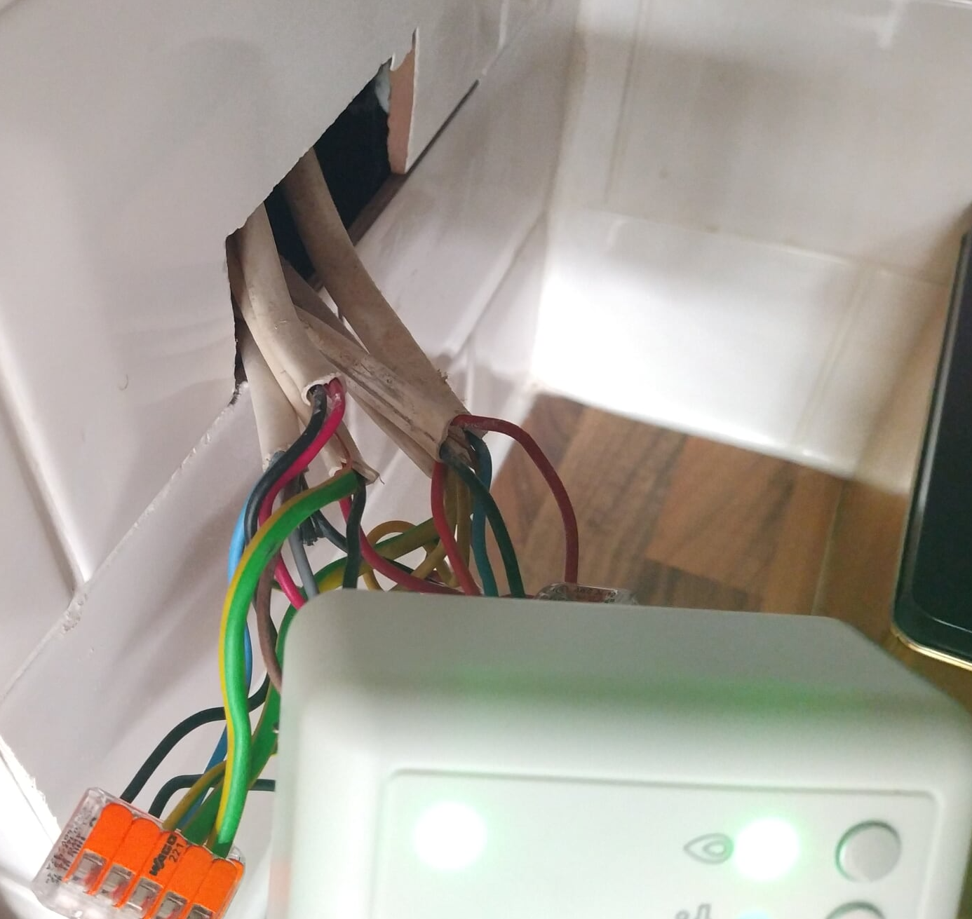

Just an update to let you know that it's worked a treat, so thank you very much for your guidance which was very much welcomed; just the stat to contend with next. The only significant issue I have is sinking a box into the wall, the kitchen was fitted by a very large UK DIY chain and the quality of the workmanship is sub standard throughout so from your explanation of how it should be I'm left to contend with what you can see in the attachment, a small aperture cut into a tile to permit cable access. Perhaps it's appropriate for me to submit an enquiry on another subforum so please let me know if that's the case however perhaps can you offer any advice as to how a tile can be cut in situ so I can fit the box or if there is another acceptable solution. This tiled area in the corner of the kitchen extends half a meter square in to the kitchen and also has the waste water connections behind it. Thanks.

Hmmm......Yes I see what you mean. Normally I just draw around the outside of the back box and carefully drill a series of holes with a small new sharp drill bit, however it will be a delicate operation to do that if there isn't physically any wall behind the area you are drilling to support the tile whilst drilling.
If there is a big void behind the tile and you can enclose the wires in small junction boxes so that just the sheath is exposed and then push them into the void that might be one way around it....
....or as you suggest, post on the tiling forum see if anyone has any ideas about cutting the tile.
