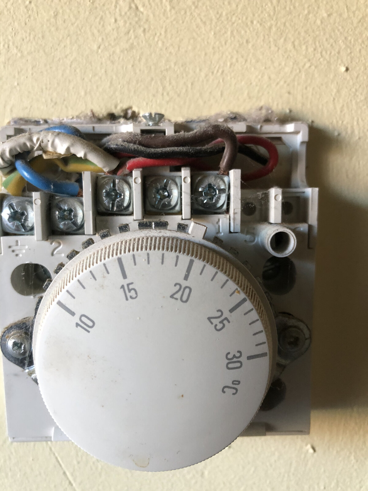

I am looking at replacing my T6360B manual central heating thermostat to a digital DT90E thermostat. The current wiring in the T6360B is yellow/green earth in left terminal, blue in T2 which I assume is neutral, red in T3, second wire with white tape wrapped around with yellow/green sleeve in T3, brown in T1 and black not in use which I assume is the Live wire
Looking at the DT90E thermostat it only requires 2 wires (red & black) so I am unsure what wires I need to use and to what terminal they need to be fitted. Once I know what terminals and colour wires I need to use I’ll be fine once power is off but just need some help with the wires required
I have included a picture of the old thermostat to show you what I mean for reference but any help will be appreciated

your wires are earth in earth
neutral in 2
live and switched live in 1&3
use the wires in 1(live in) and 3 (live out)and make the others safe
Thinking about the wiring and after the reply from gas112 it has dawned on me that, although I knew there were 2 lots of wiring in place, it would appear 1 is the old wiring and 1 is the newer wiring which explains why I have brown and blue in place and what looks like an extra earth. Does this mean that I can join the 2 live (brown/red) and the 2 neutral wires (black/blue) together before connecting them to the thermostat with the earth (yellow/green) wires put to one side?
you do not connect a neutral to dt90
you just have live in and out which is the wires in 1 and 3 on existing

@gas112 has correctly told you what to do, nothing else required, you need only two wires , purple pink yellow beige does not matter use the two wires to the two terminals and safely isolate everything else

@gas112, @ianmcd & @Chris_W rather than being disrespectful to people who are asking question to make certain they do things right maybe you need to read my comments first before being sarcastic in your responses. I totally understand I use the wires (regardless of colour) in T1 & T3 but my question was regarding the 2 wires in T3. Do I use both wires in this terminal or just the red one which I have seen in videos. If you are gonna be sarcastic in your response then don’t bother responding as all I am trying to do is be safe and I can go elsewhere for my answer!!!

what bit of use wires in 1 and 3 and make others safe and do not use neutrals where you struggling with ?
