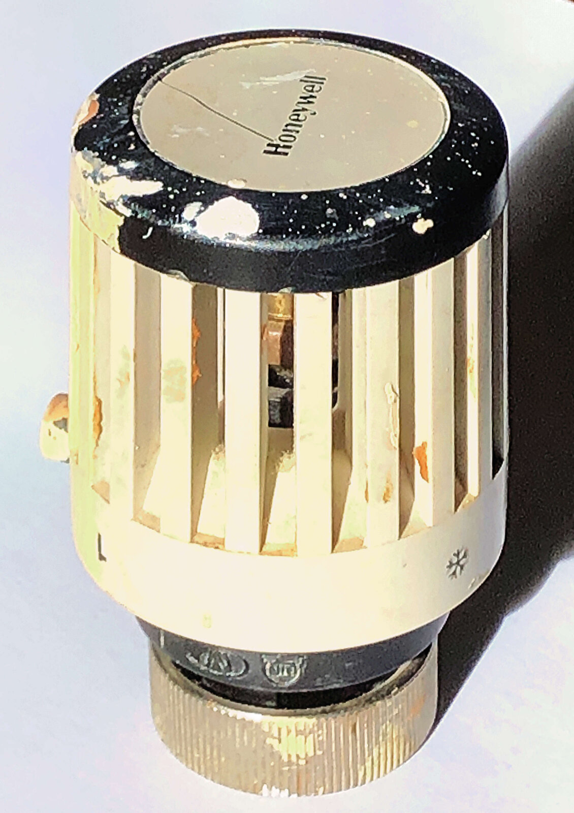

The TRVs on my central heating system are old - 1980, perhaps. The actual valves are all working but some of the heads seem not to work properly, reacting very slowly or not at all to temperature changes. I assume the temperature sensors are wax which I have read tends over time to stop responding properly.
I'm planning on replacing them but other than being Honeywell, there is nothing to indicate the exact model - anybody know?
I've also noticed that different manufacturers/models of TRV head have different types of connection to the valve and different threads. If relevant/helpful, the OD of the thread on the valve top is 30 mm. And the pipes for the central heating are 10 mm.
Can anybody confirm what make/model of TRV head would be compatible with these valves?
What would people recommend to replace these heads?
you will need to change the complete valves, how do you know that they are slow to react ? do you know how TRVs work ?
