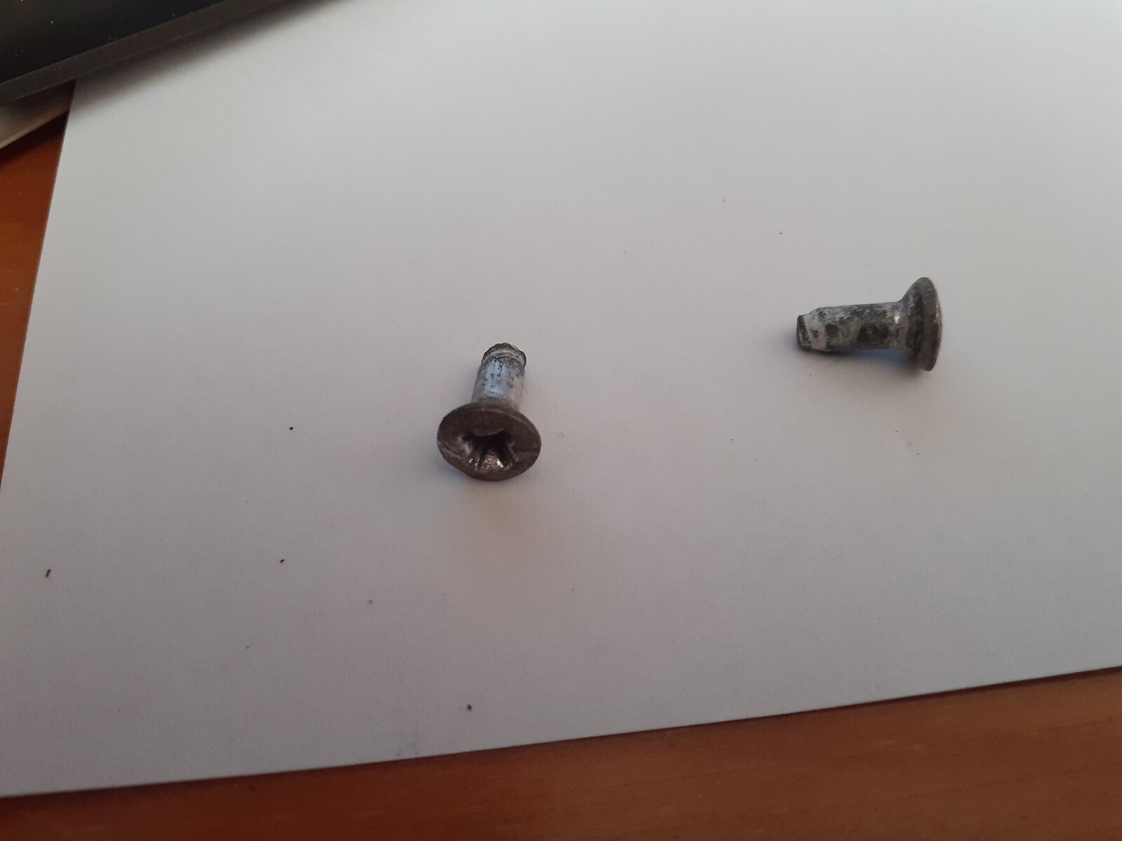

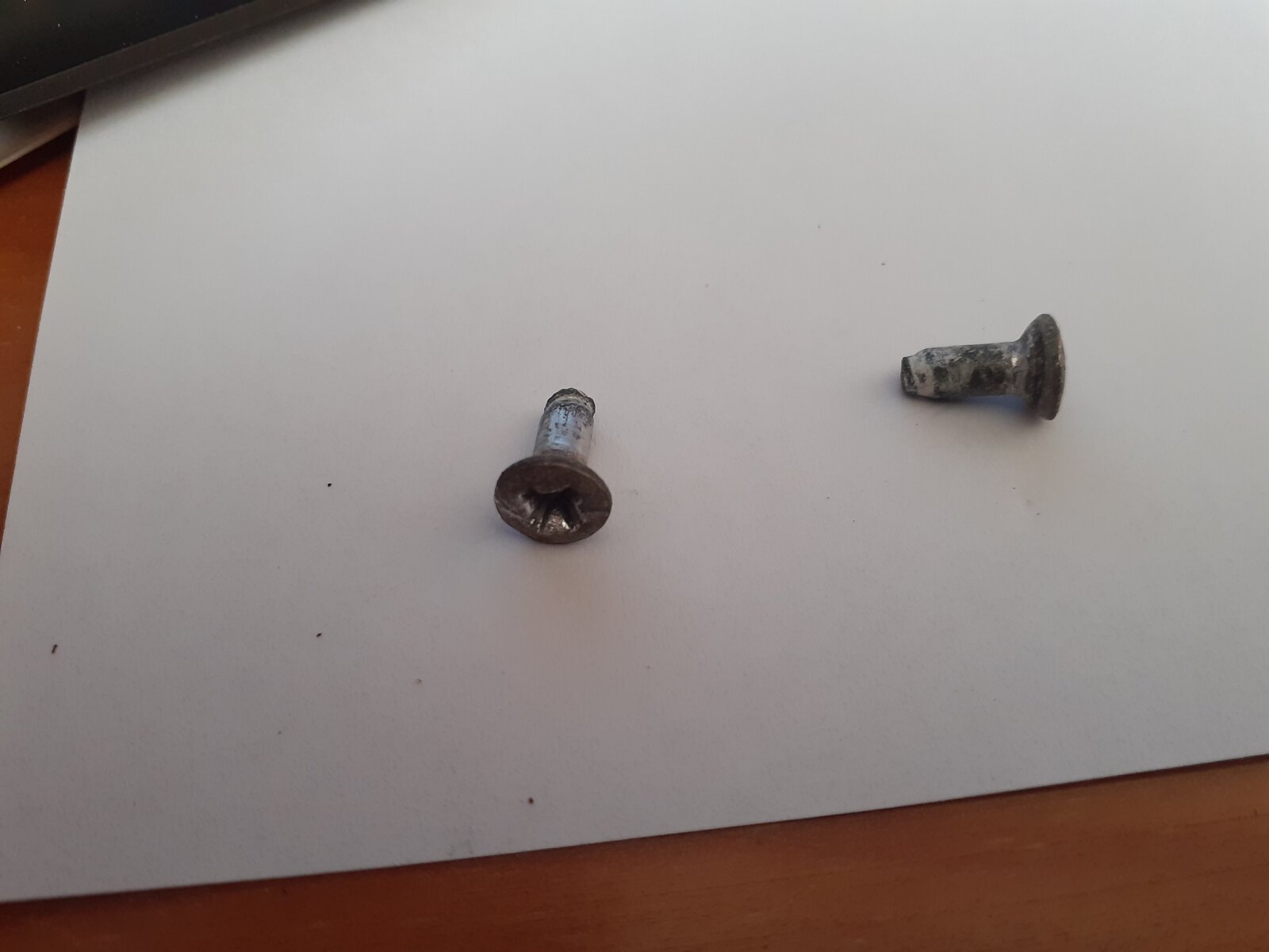

Remember me?. Its been a while but the Glazing replacement sealing kit arrived and there is a spell of good weather for a few days so decided to have a go at this today. However, I though before it took the window out I would see if the screws that hold the Aluminium strip down would give any problems. I only tried 2 screws and they snapped without hardly any pressure. I was only using a hand screw driver and attached picture is the result. Put the Job on hold just now cos I reckon all the screws are going the same way, and will have to come up with a contingency plan. Considering all screws are going to go the same way, and I wont be able to use the old Holes in the Aluminium fixing frame, I guess I am going to drill new holes close to the originals. I note that the frame holes are kinda shaped to take Bugle headed / countersunk screws. I was planning to fit Pan or button headed stainless steel screws in the newly drilled holes that I make so as to get a flat sealing face, instead of using counter sunk screws. Then either use Silicon or small hole punched pieces of flash band stuck over the old screw holes to seal them up.
Has anybody come across this screw breaking problem before ? Are there any better ways of getting round this. I'm pretty sure all screws are going to break

Clean out the slot in the screw head first, then insert a red hot screwdriver, into the screw head, leave it long enough to transfer the heat, then maybe a squirt of releasing fluid, before tackling undoing with another driver.
Not sure if heating the screw would be beneficial if its actually snapping of in the wood like the two I tried already have done. Its not seized in the Aluminium, just heavily corroded in the wood
The heat, will be even more effective in timber, than it would be in metal, because timber is much less of a heat conductor. Worth trying, to see if it works, and would save you a great deal of extra effort.
Don't miix stainless steel and aluminium. If I remember correctly you get a chemical reaction between the 2 metals. Not sure if you get the same problem with brass screws. I would have thought the screws Velux supplied would have been suitable.
Yes unfortunately a lot of those old screws just go soft with age and snap! Just make some new holes and use the new screws that come with the kit, yes the butyl patches are for sealing the new screws.
Thanks all for the Input. Considering the age of the window ( 1992 )and maybe looking ahead into the future when I can afford to replace, I decided to go with stainless steel button head screws with a flat head for a good mating surface.. Googling brass screws in Aluminium shows they are highly reactive. In Total 4 screws out of 9 on the outer aluminium frame broke. I Drilled new holes and put a "washer" of 3mm Butyl tape on the screw right up to the head, Screwed them in and cut off any excess Butyl, so hopefully the butly will act as a Barrier of sorts. Worst part was the flashing piece at the bottom of the glass that comes off after the Aluminium. Three Pan head Machine screws that went into Metal Brackets ( I was hoping it was wood ) underneath the Flashing. Had to drill all three out and re-tap the threads. M5 Pan head Stainless machine screws used to replace these also, so Job Done. Once again, Thanks all
