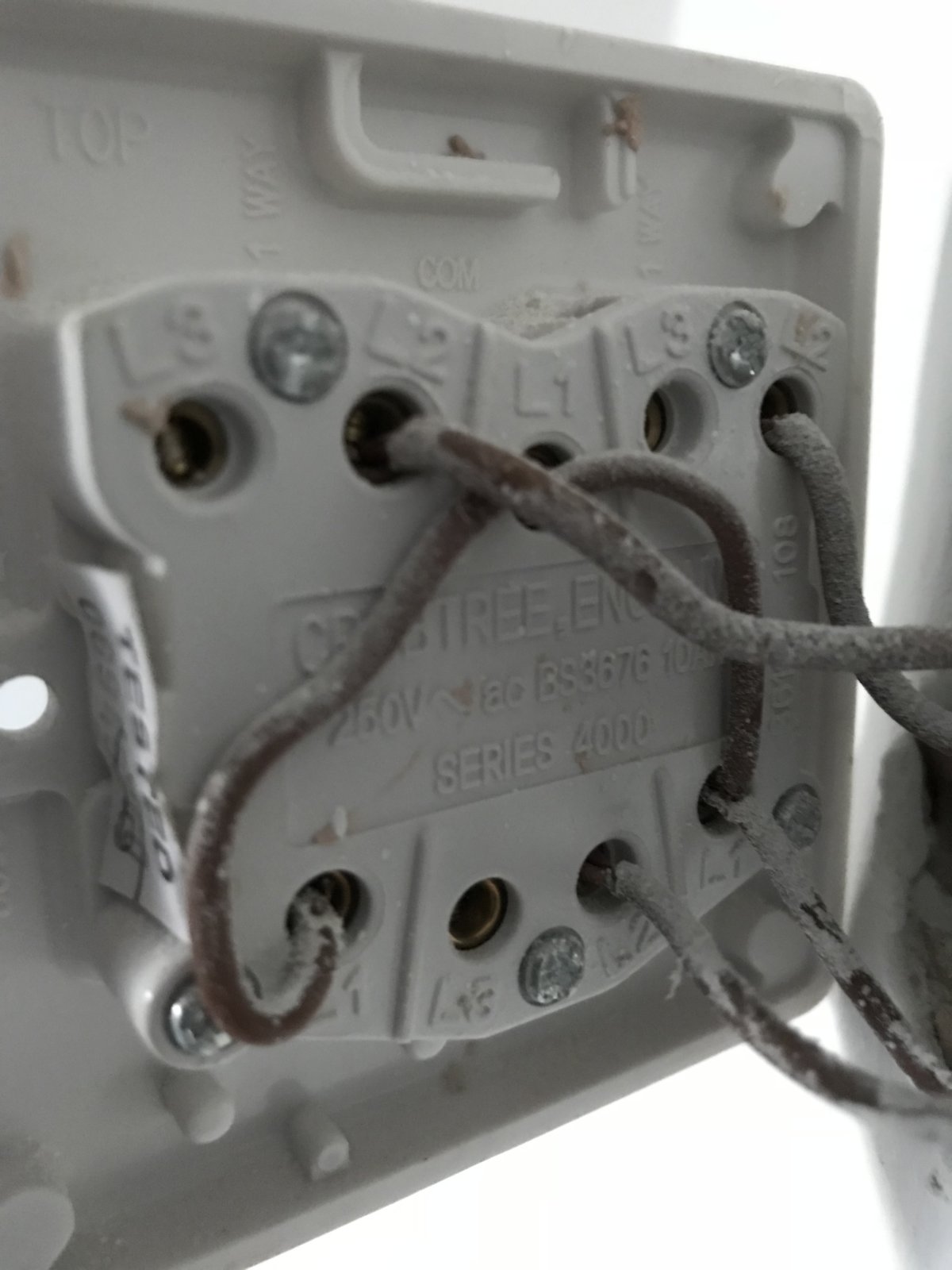

Good afternoon
I have a wall switch in my living room which controls 3 separate lights.
3 button switch.
I no longer have need for the 3rd light so will be replacing the switch for a 2 button.
Current switch has 4 brown wires coming in from the wall. 2 are going into L1 and 2 into L2. The L1’s have another brown wire which loops to another L1.
I have attached a picture.
Using a multimeter the 3 L2 connections are live.
My new switch as L L1 L2
How do I wire this up?

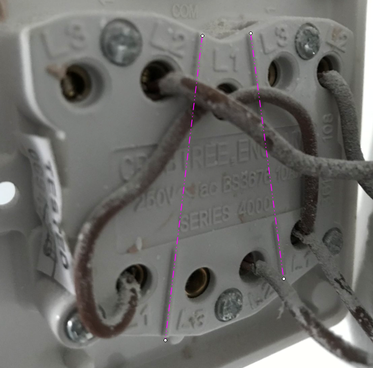

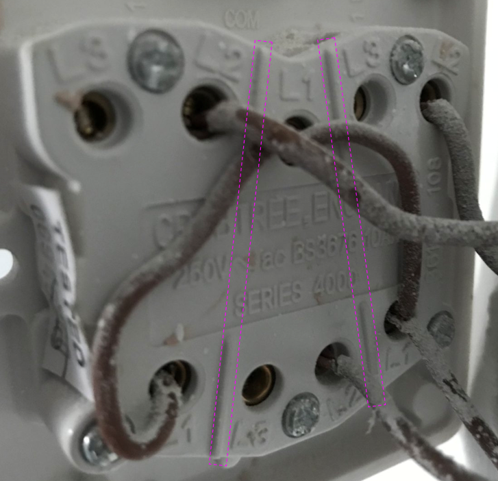

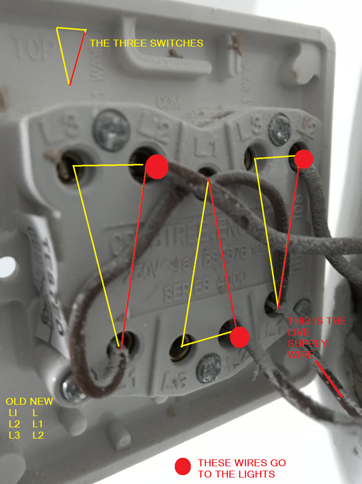

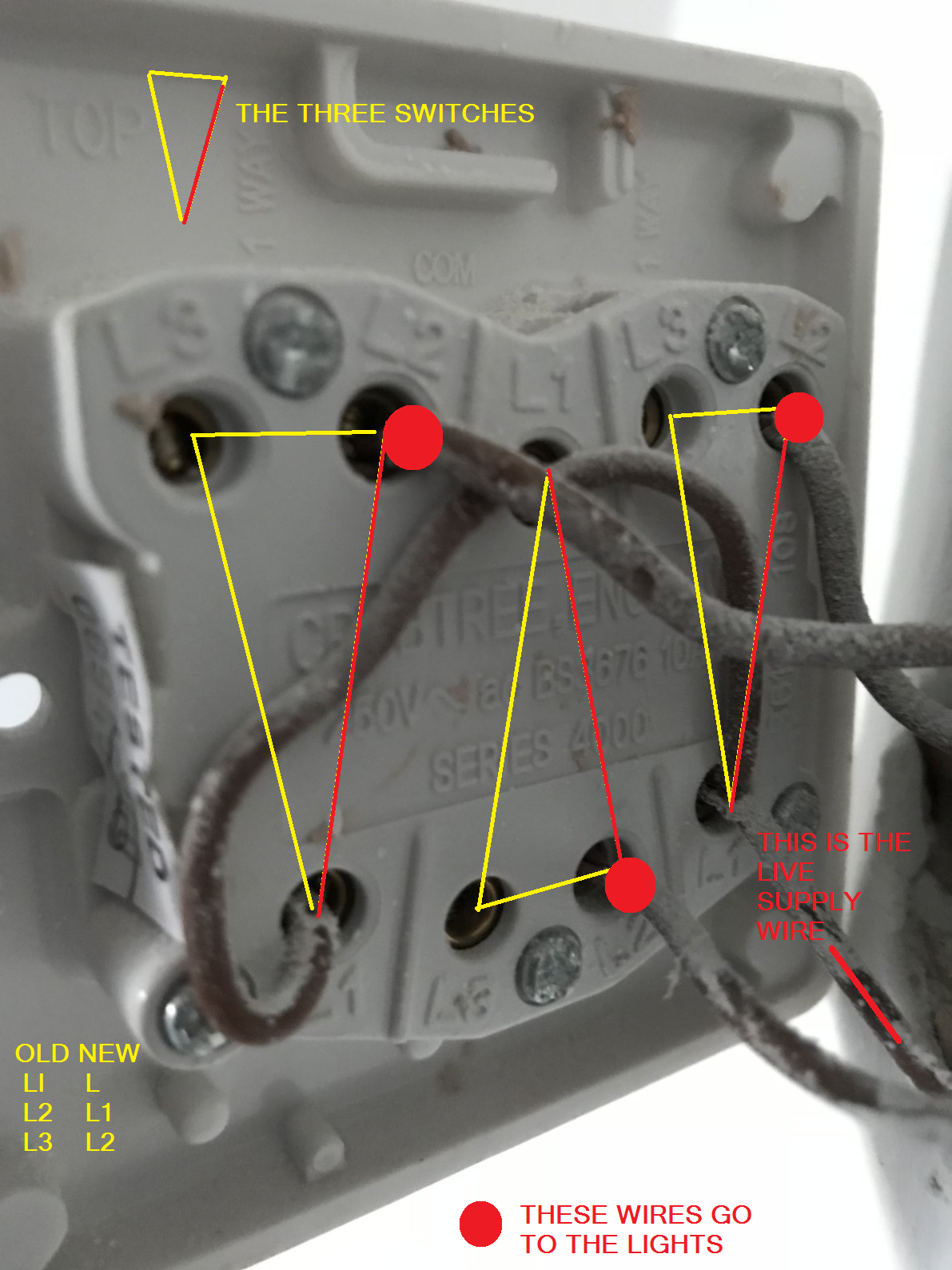

They are used when you have two switches for one light - like the stairs, or
should you want the switch to work 'upside down'.
Start off by disconnecting the light that you no longer need. That will be one of the wires in one of the L2 terminals.
TURN OFF THE POWER
Disconnect it and put the bare end in a bit of insulating terminal block (aka choc block)
Then remove the link wire that connects to the L1 terminal associated with the L2 (ie in the same triangle).
Switch on the power and check that the other two lights still work as before!
Now you can buy your new switch. Take careful look at the new switch terminals. They may be marked differently to the switch that you have.
Many now are marked C, L1 and L2
Instead of L1, L2 and L3
