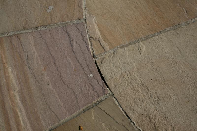

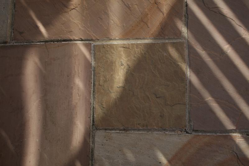

I have an Indian Stone patio that is in need of repointing and, although I've never done anything like it before, I'd like to give it a go. Most of the gaps are not very deep nor wide; for example:

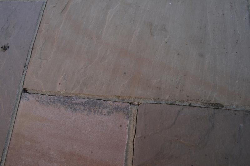

However, some of them are quite deep, like this one:

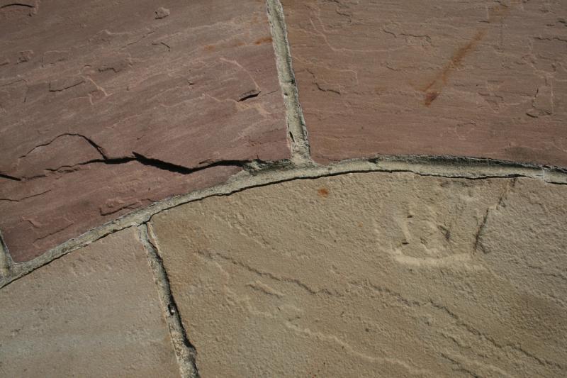

At some points, there are also some weeds growing:

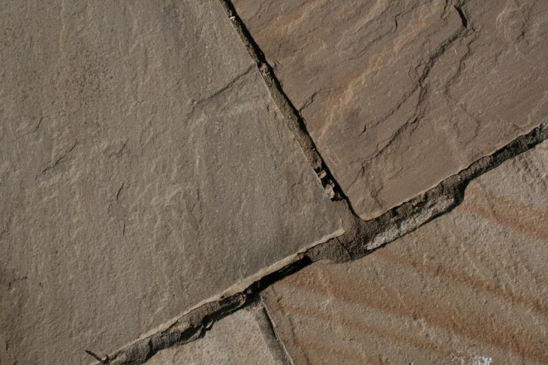

Recently, I had another part of the patio relaid by someone else who used Geofix. He also used some of the Geofix to cover one of the parts that he did not relay, but the Geofix did not work as expected, as you can see in the following photo:
The Geofix comes out very easily!

No I wouldn't use geofix.
You'll struggle to get a colour match to the exiting bits, and it's not a structural product so it won't hold loose slabs in place.

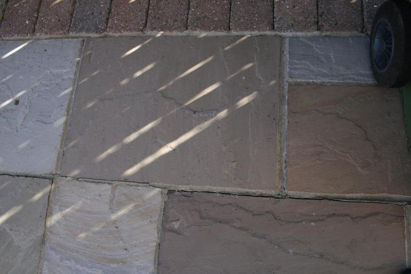

Do you think that I need to strip out *all* the mortar between the slabs, even if it is not cracked?
For example, in the following photo, there are a few edges that are not cracked and some thin cracks. Should I cut out all the mortar or should I cut out only the edges that are cracked? (Can the thinner cracks be fixed without cutting out the mortar?)

Judging by that last picture I wouldn't worry about repointing that bit if you can manage to match the mortar colour from new to old.
Try raking out the mortar from 2 or 3 of the worst slabs, mix up your mortar and then repoint to see how it looks and how long it takes you.
You can then make a judgement on time vs effort vs appearance
