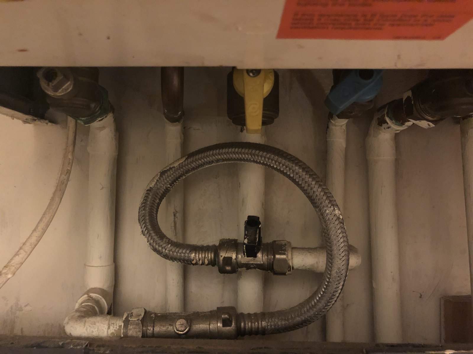

Hello, lately my Biasi boiler is very loud. I noticed that the pressure gauge is less than 1 bar and very close to 0. I do not understand what i have to do in order to fix it.
I have attached a picture of what i see. I would appreciate any help in advance

Turn the black handle on the valve of the silver braided flexi hose until pressure is around 1 bar, then return it to its original position .

when i first tried this it did not work, and now that you mention it again i tried again. it turned out that the black valve wasn't turning well (it was turning 360 degrees), however i did what you said and indeed the water started to flow and the bar was increasing. Now though if i start the boiler again the bar goes on and on with even louder noise!
imagine now it is on 2.8 bars and i shut it down. :/
edit: the needle went close to 4 ... what do i do at this point?
You have not closed the valve fully. Sometimes the plastic black handle wears under Neath ,where you can't see ,and is not contacting the shaft below. So you turn black handle ,but its doing nowt.
You must close the valve. If need be take the screw out of it and pull handle off. You then need a spanner on the square shaft ,or a good set of grips on it.
you are right! i managed to do that and i read that to drop the bar i had to bleed the radiator (which i did), and now it is steady.
