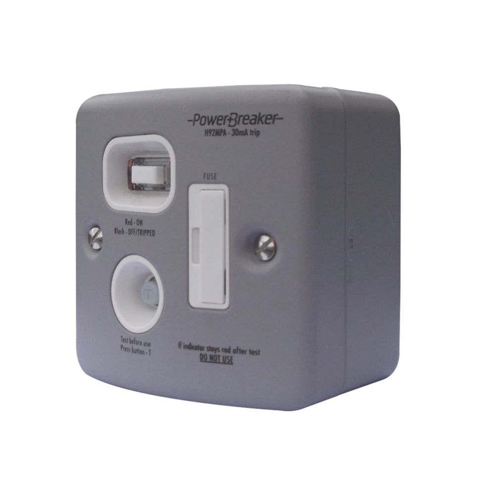

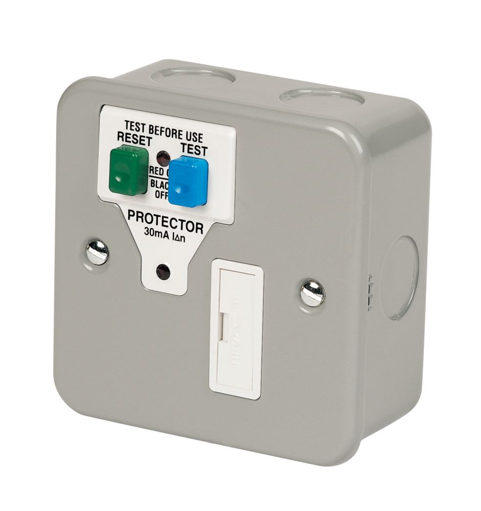

The answer by BAS is spot on. However I also realise people will go ahead anyway so real basic wiring to a shed first you want a metal box to be able to terminate SWA into without warping. Using a socket box is easy option. Also limiting total supply to 13A makes life easy. So if you use a RCD FCU like this or this at the supply end it makes life easy use cheap type active normally but use expensive passive type if a fridge or freezer are to be used. Because of distance I would consider 4mm sq although I have not worked out volt drop just a guess. And at the shed I would use Switched FCU's as light switches and fuse down to 3A.
This is a very basic way to wire a shed and if you want to use heaters and other heavy equipment then it's no good.
However it will likely pass when you submit your plans to the LABC before starting work. If you think you may wish to up-grade latter then use thicker cable.
To be honest by time you hire the test gear needed to submit your results to the LABC and pay the LABC fees it is likely cheaper to just dig trench then get a local scheme registered electrician to do the job for you.
